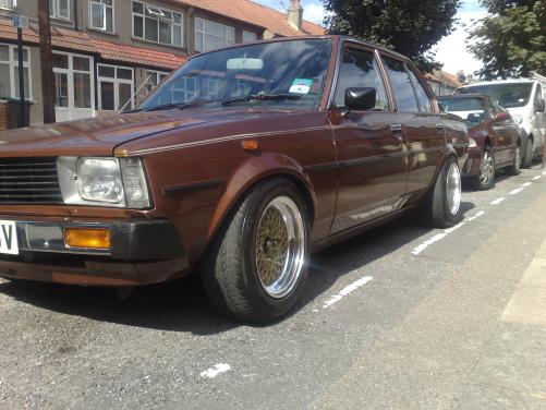

f@$k i love the dx model it has a way better front and shape than myne the cs and even the csx it looks relly good mate if i was to ever get another 1 id get a dx
looking good
Top work mate, looks awesome, how does it go?
