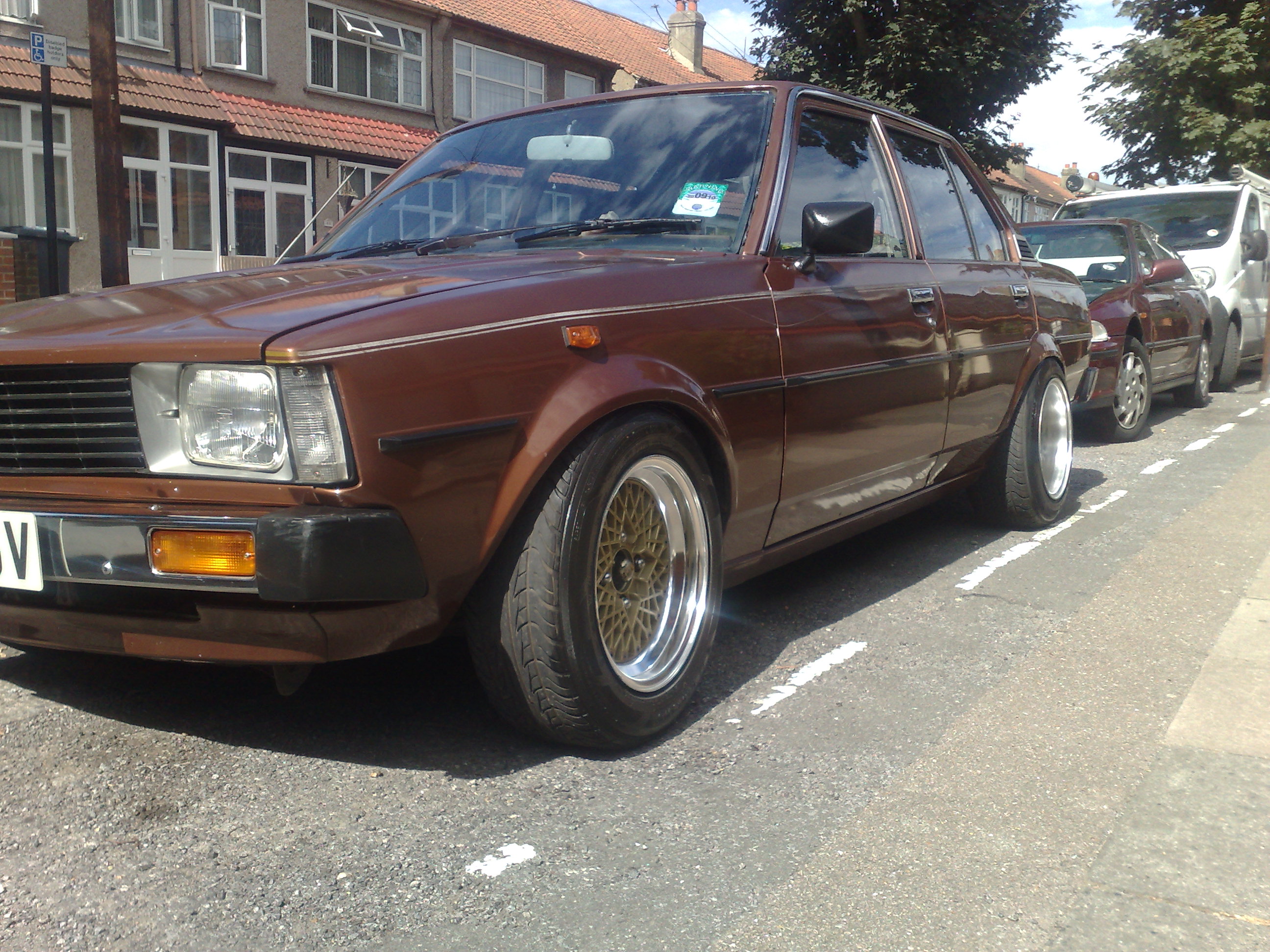

Well after going through my s-chassis crisis i decided to go back to the small rwd which i love. So recently picked up this tidy granny spec 1983 Ke70 Gl Limited Edition goodness.
Plans as the title suggests is to get back to where i was around a year ago when some lowlife stole my ride. With a few changes here and there. So I'm going with a CA18DET between the towers.
