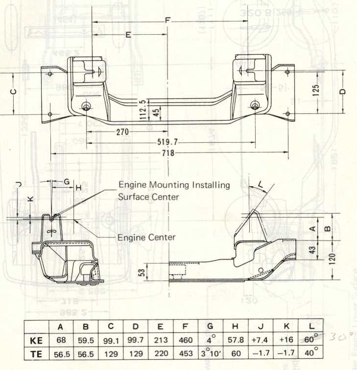

Does anybody know the angles (from the horizontal) of the mounts on the T engine crossmember (from TA22/T18)?
The dimensions between the K and T crossmember are in an diagram in this thread:
http://www.rollaclub.com/board/index.php?showtopic=40489
There is an error for the angle of the K crossmember mounts, which has been corrected. But there is uncertainty in the T crossmember angle.
I've measured the K crossmember mounts to be ~60 degrees.
Then for the T crossmember mounts, the passenger side is 55 degrees, and the drivers side 45 degrees. That's estimating from the engine block mounts, but I don't have a TA22/T18 crossmember to confirm this.
are you talking about the (L) marked angle on the TA22 thats indicated as 40' i have my ta22 crossmember out atm i can get the angle either tonight or early tomorrow just need confirmation if this is the angle required
Yes, that's the angle. Or if its easier, from the horizontal, to get a flat base for the protractor to sit on. Both engine mounts would be good. Thanks. Would help heaps.
I'm putting a 3T in my ke30 at the moment. I have followed the dimensions in that crossmember diagram. I drilled out the welds in the K engine mounts, and moved them ~30mm further forward, adding extensions. I changed the angles to what I measured from the engine block mounts. Then moved them towards the passenger side by distances indicated in the diagram. Left mount 7mm and right mount 14mm towards the passenger side (taking into account the angle changes).
The engine sits nicely in the engine bay, up vertical and flat, with the factory position of the T50 gearbox, but the engine still sits closer towards the driver side (brake master cylinder) about 2-3 cm; when compared with TE31/Te35 engine bay photos from Japan and USA. Can get away with it, but want it perfect.
Was thinking the angle of the mount surface could be out, since there is little room for the driver side mount to move further over.

Here's a diagram that I got from Jonny Rochester; K and T engine cross member:

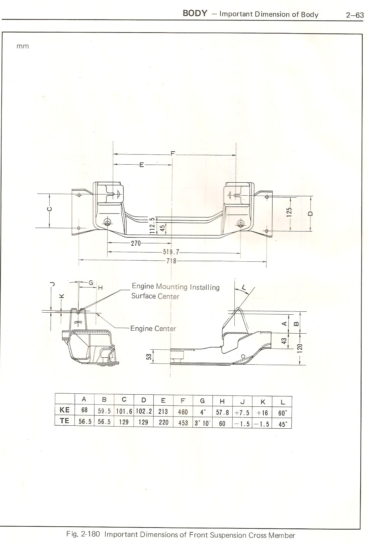

Then one I got from a 1975 Corolla & Trueno repair manual (body):
There are slight difference in the distances, but not significant, however the angle L is 40 degrees in the first diagram and 45 degrees in the other. Not sure which one is right.
