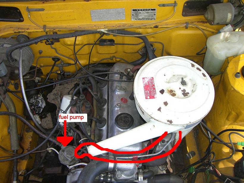

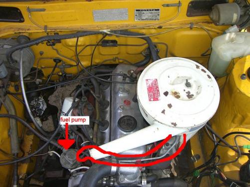

Pull the fuel line off the carby and crank it over a bit to see if the mechanical fuel pump is actually pumping fuel?
I'll probably get laughed at for this which line is the fuel line going into the carby? Theres a number of different lines going into the carby.
Thanks for your help guys found out that it was a blocked fuel line coming from the fuel tank all fixed now glad Ive finally got it running. :wink: Also found out that that my ke70 is a jap spec version which has lots of emissions lines coming out of the carb which is why I had difficultly figuring out what 1 the fuel line was lol.
