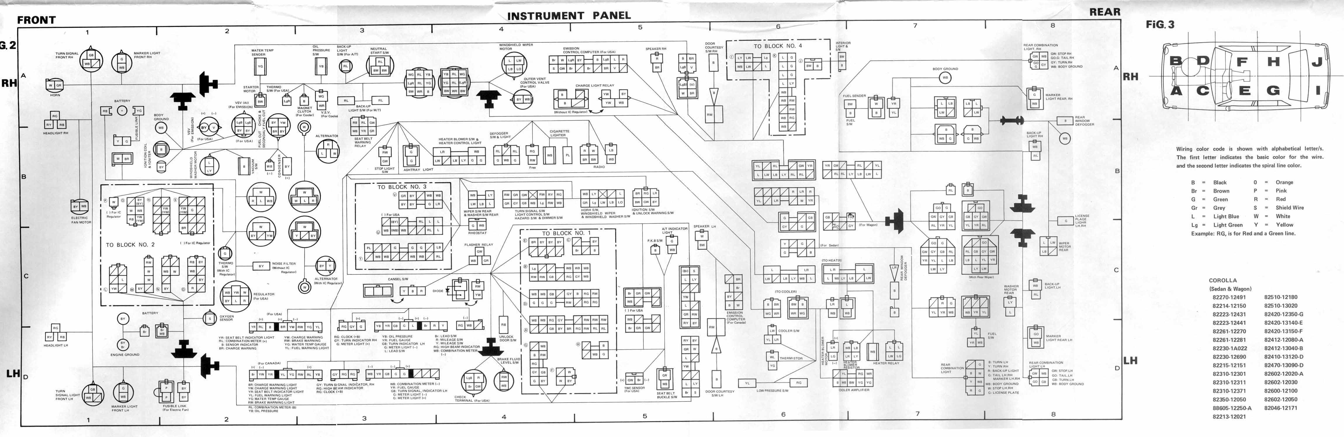

markhansen1983 Posted February 10, 2010 Author Report Share Posted February 10, 2010 ciggy is constant power (for my ke55 anyways) and i used acc from the radio fuse EASY Cheers mate- i found the fuse by using a tester light, but can't get in behind it to find the wire :wink: at this stage that first bunch of wires i mentioned (with the blue/black wire blue orange wire green red wire yellow red wire red white wire green white wire blue white wire) etc, would be easiest. I found a wiring diagram, but I'm not electrician, and have no idea what it's talking about....I would appreciate it if someone knew which colour wire of this big bunch, as my feeling is it's got to be one of them...i just don't want to strip every single one back if it can be avoided, and someone on here already knows.... Quote Link to comment Share on other sites More sharing options...
jono1986 Posted February 10, 2010 Report Share Posted February 10, 2010 Thats not a wiring diagram, thats some sort of electrical block diagram that looks useless. Put you test light into the end of the cigarette plug and see if its on all the time, if its ignition fed just use that, the acc wire that goes into the radio doesn't suck any current so no need to change fuses or something. If someone has a wiring diagram i can tell you the exact colour wire you can use and where it is. Quote Link to comment Share on other sites More sharing options...
