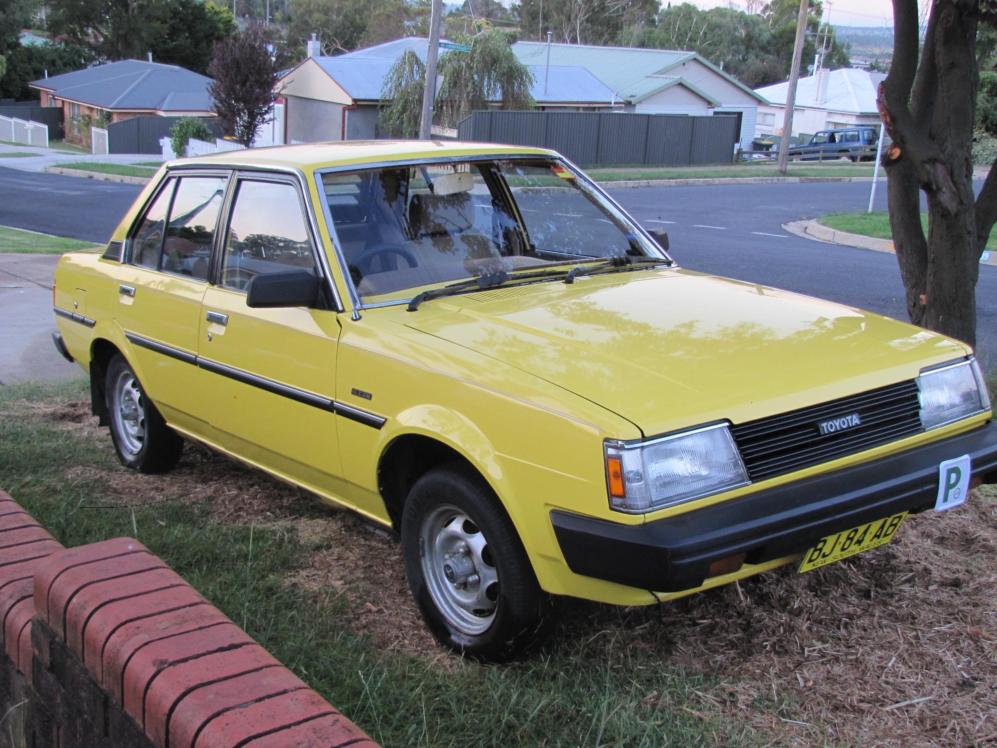

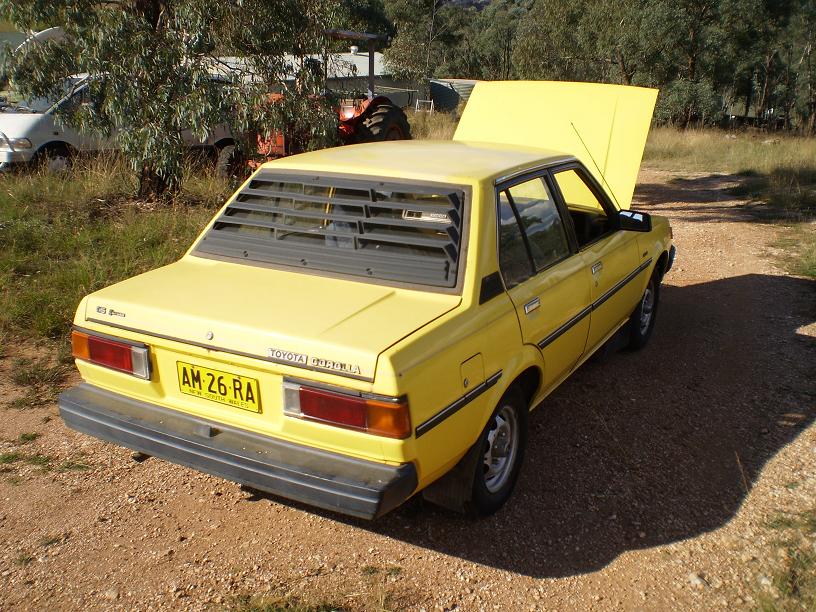

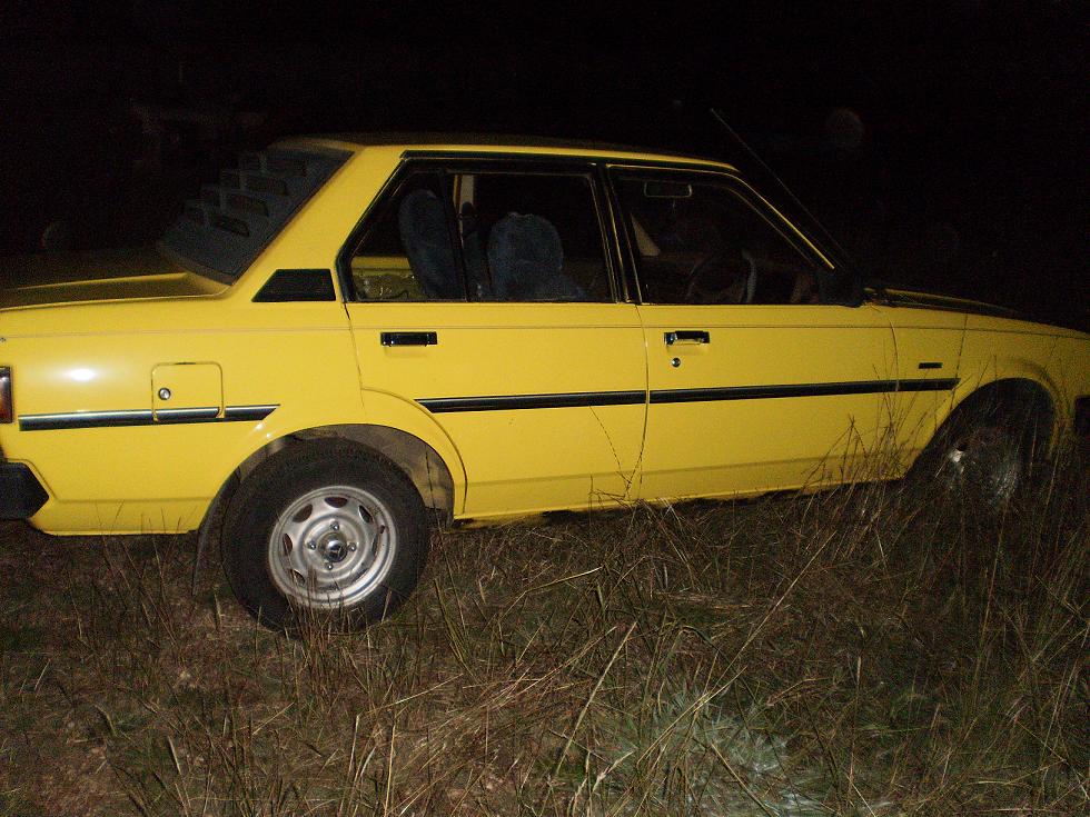

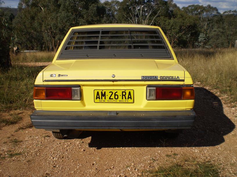

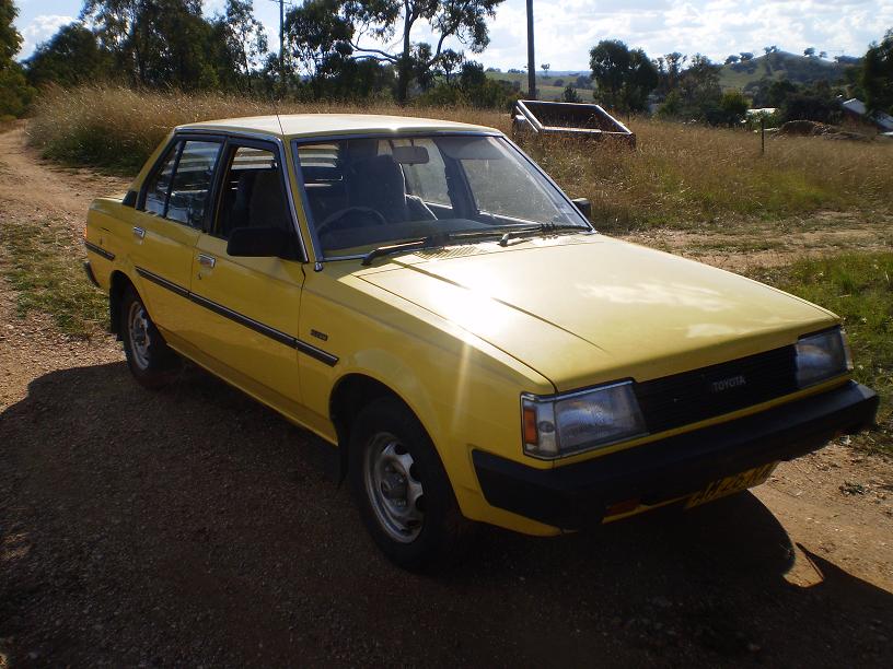

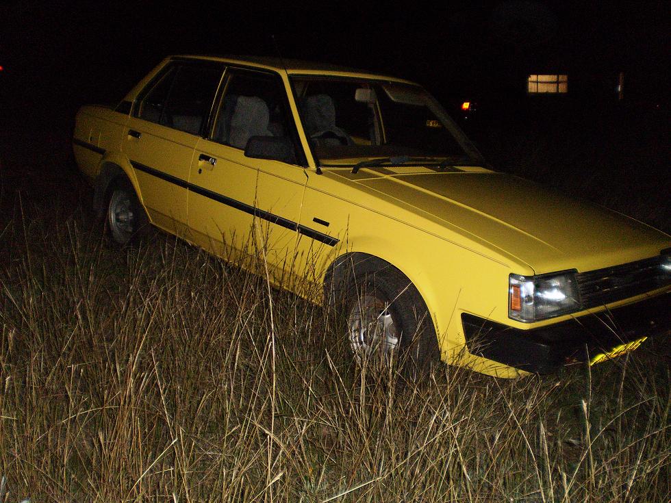

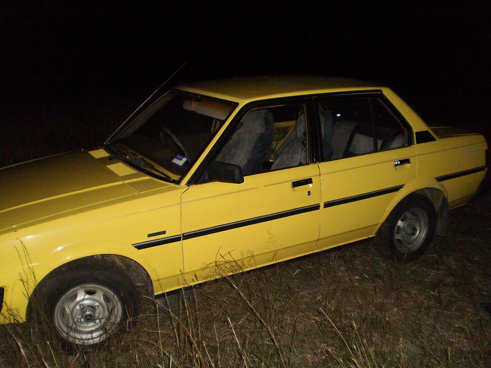

Anyhow here are some really bad pics (only picked it up last night and worked all day today so it was night before I had a chance to get some decent pics.....will try and get some more tomorrow in light!!)
How it looks today 04/08

Great price and looks just as good mate! But that thing needs to get low more than a Vietnamese prostitute!
Also go the TA22 or T18 diff, from what I've read anyway.
Edited by xmoht

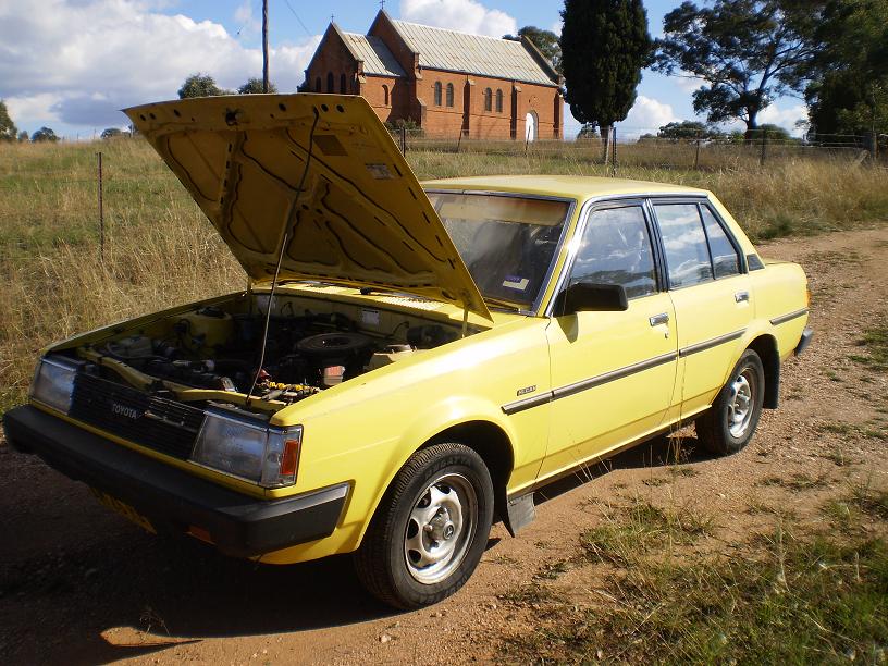

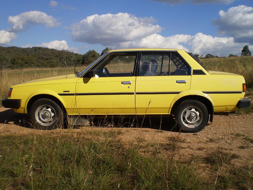

Spent a little bit of time at my dads today, took some more photos and fixed the rear window that was broken from the previous owner. also took it for a little drive as my dad lives 20kms from anyone(kind of inconvenient cause the car is 20kms away from where I live)
Anyhow. fixed the window for rego. now Ive just got to fix the passenger seat that has pretty much completely caved in and is sitting looser than a taiwanese prostitute, then I might see how i go with getting a
blue slip.

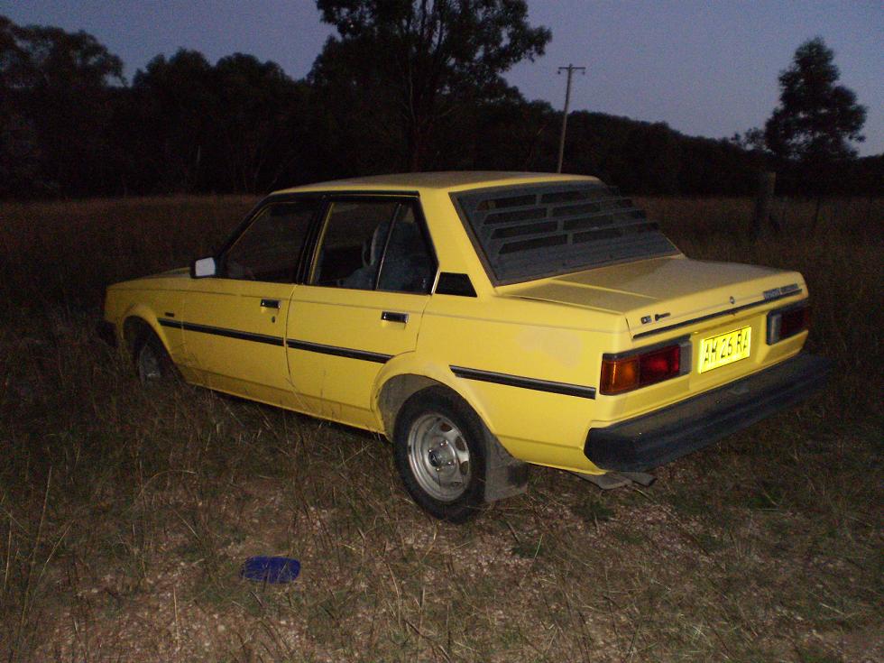

Anyhow heres some better pics that might better show the condition of the car...

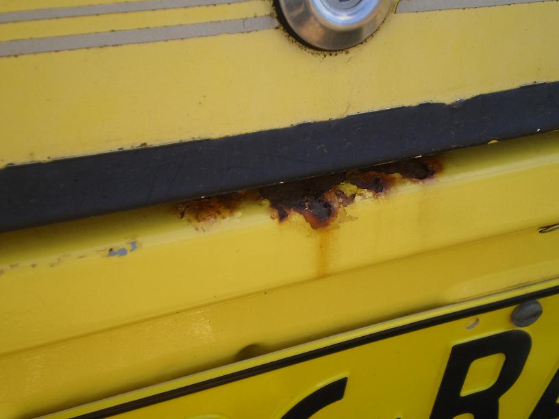

yay rust!@!!!

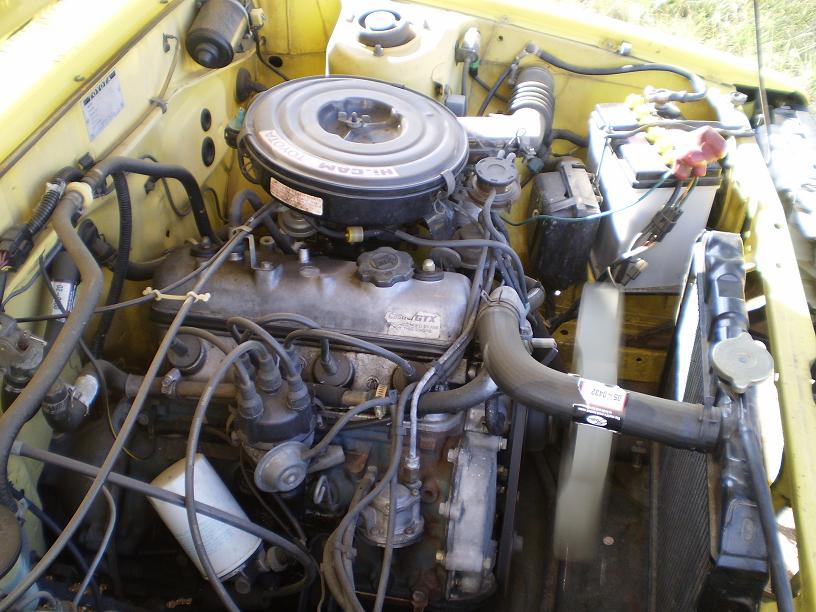

The motor sounds like it has a bit of tapper rattle, but its still runnning great. will probably do an oil/filter change, replace all the spark plugs/leads and replace the air filter when I get a bit of time.
