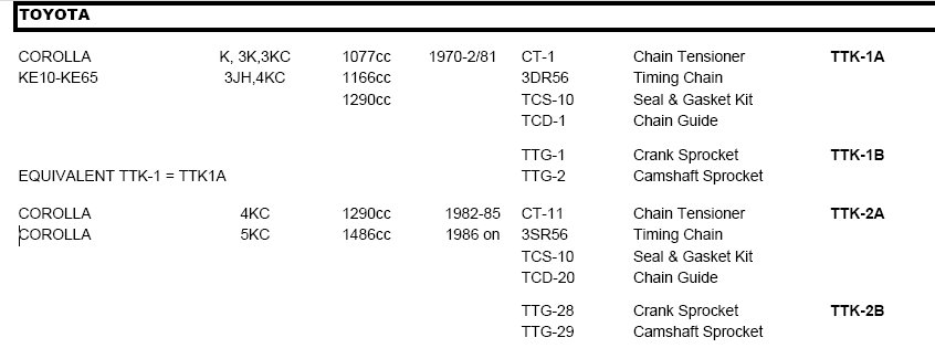

aye felix can you pm me some names please of suppliers of timing chain kits (spokets,chain,tensioner)
thanks mate
thanks mate
Karmot is one supplier. I'm out of the loop, has been 6 years or so since I worked as a parts interpreter. Check around your local spare parts joints to see what they can get.
Here's some part No's anyway to get you started:
Another one: Rollmaster CS9000... Think it is adjustable with multi-keyways.

Yeah I've got a rollmaster kit which I haven't installed yet (will get put in a new motor) and yes they're adjustable with keyway holes nearly the whole way round.
