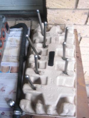

Chief Posted May 24, 2010 Author Report Posted May 24, 2010 ahh cool thanks for all you time and info taz i figured i would put some photo's up to see if you guys can find anything i have missed wrong with the engine. The piston's. I read somewhere that you have to number the push rod's so you don't get them confused but i think that was on an 8 so i did it anyways to make sure. Thats some of the milky goodness in the head lol CHEERS GUY'S Quote
