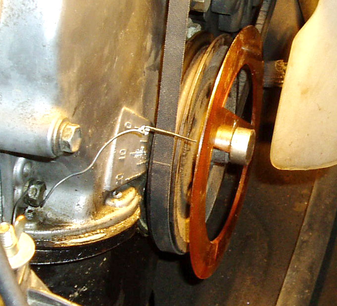

I did make life easier by putting the protractor on it, turning 180deg and marking the pulley at cyls 2&3 TDC with a bit of white ink. That's the magnet from my metal detector pick, so its easily strong enough to hold the protractor in place. Also made sure the cam timing was OK, and we have set tappets using cam timing before on the rally car, but OHC is much easier!

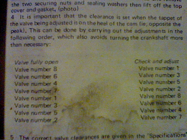

I've always done my 3k the way my Haynes manual showed, which sounds like the 9 thing. But it gives you the order in which they will open to make it easy. You just rotate the engine once, slowly, watching for the valves to open, adjusting as you go. Sorry...my book is 40 years old now and much used. It and this car were my introduction to mechanics.
