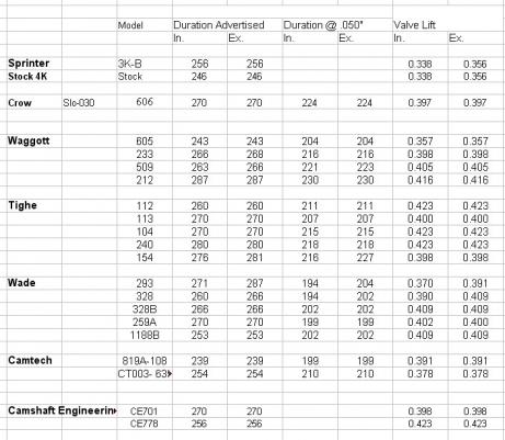

where is a good place to source a cam? what grind would you reccommend? yeah was going to take the head off and give it a clean up, and have been checking out ebay for a carby seems to be a few good buys on there. was going to machine the flywheel a bit too
