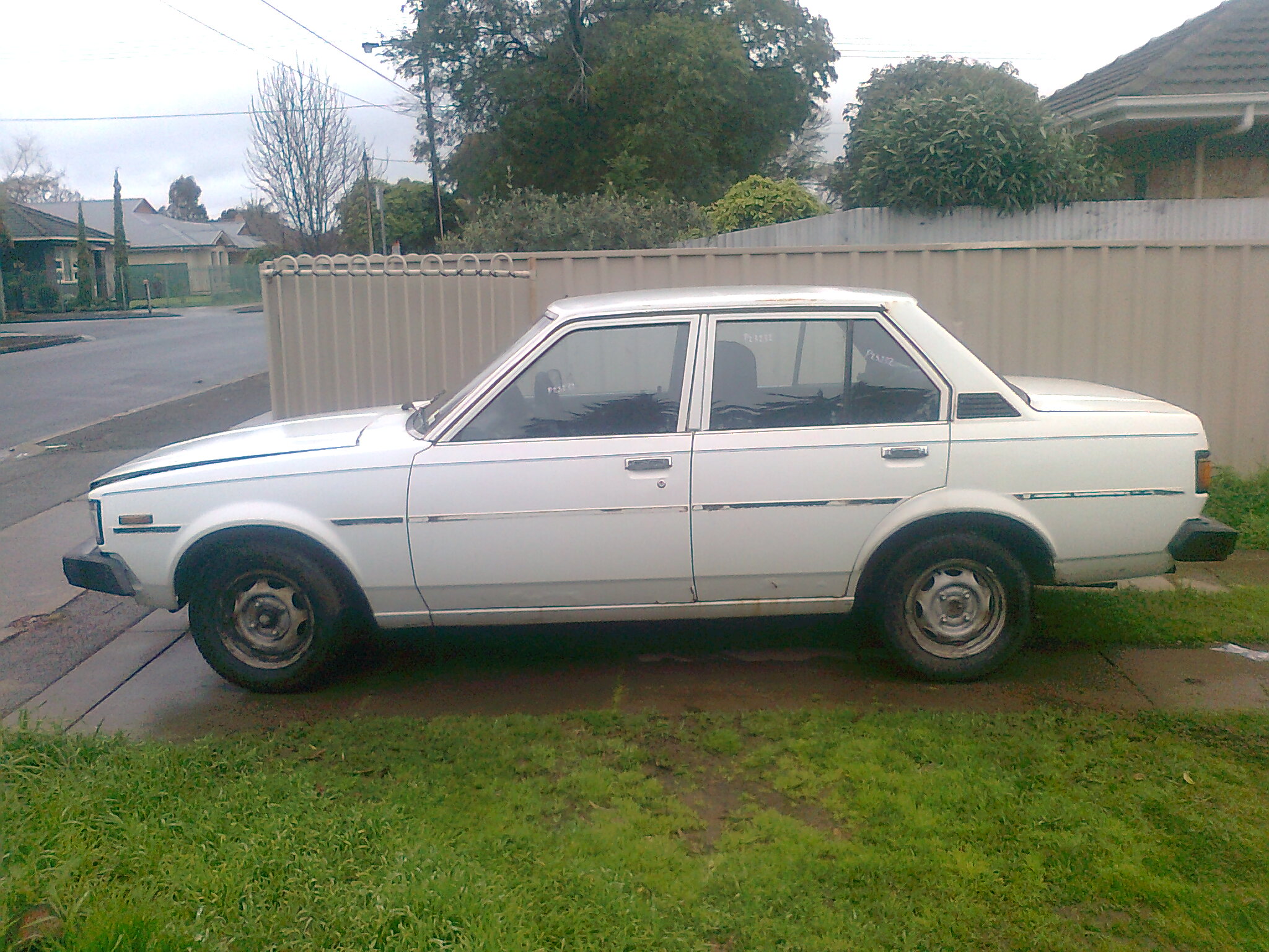

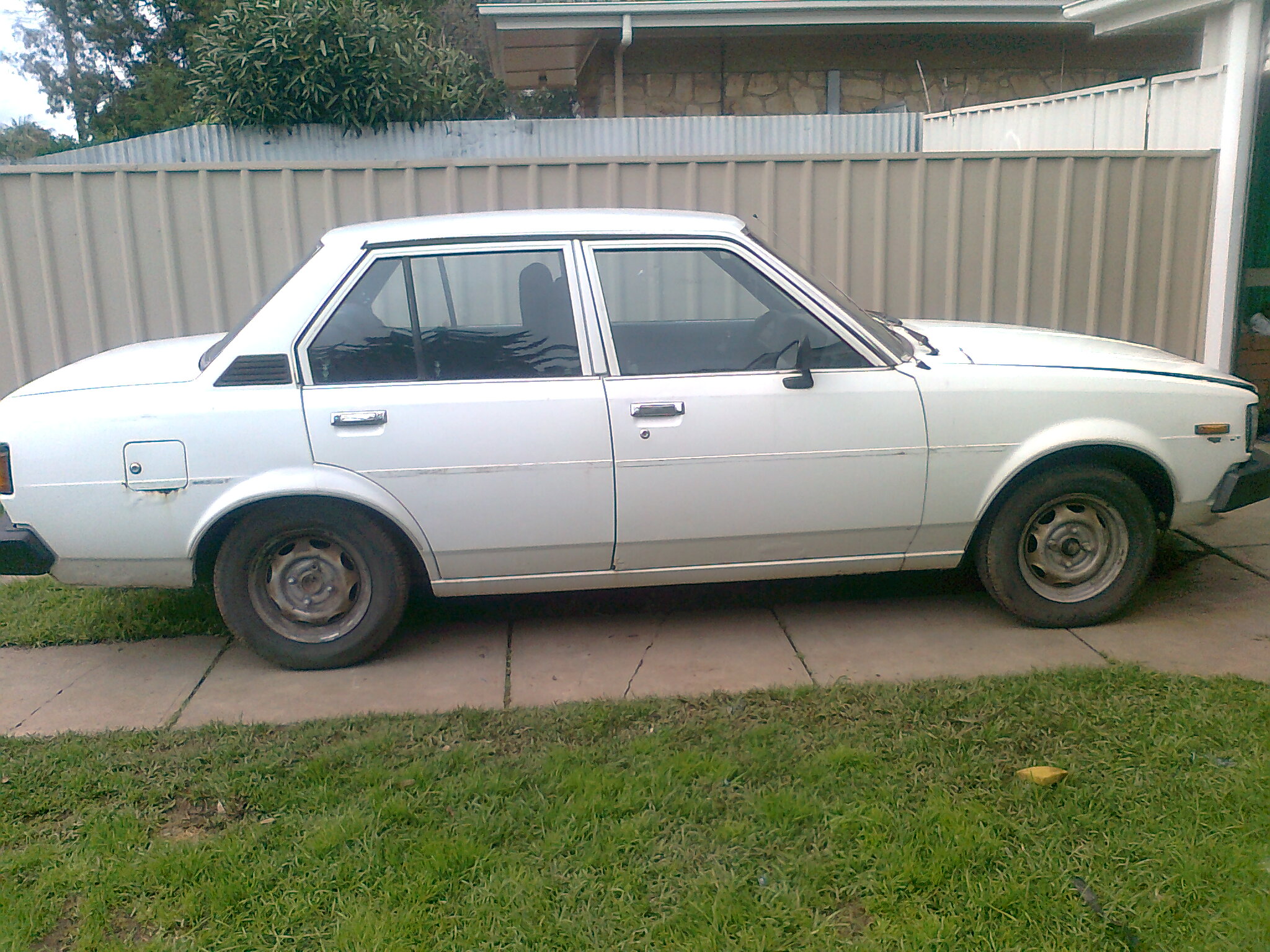

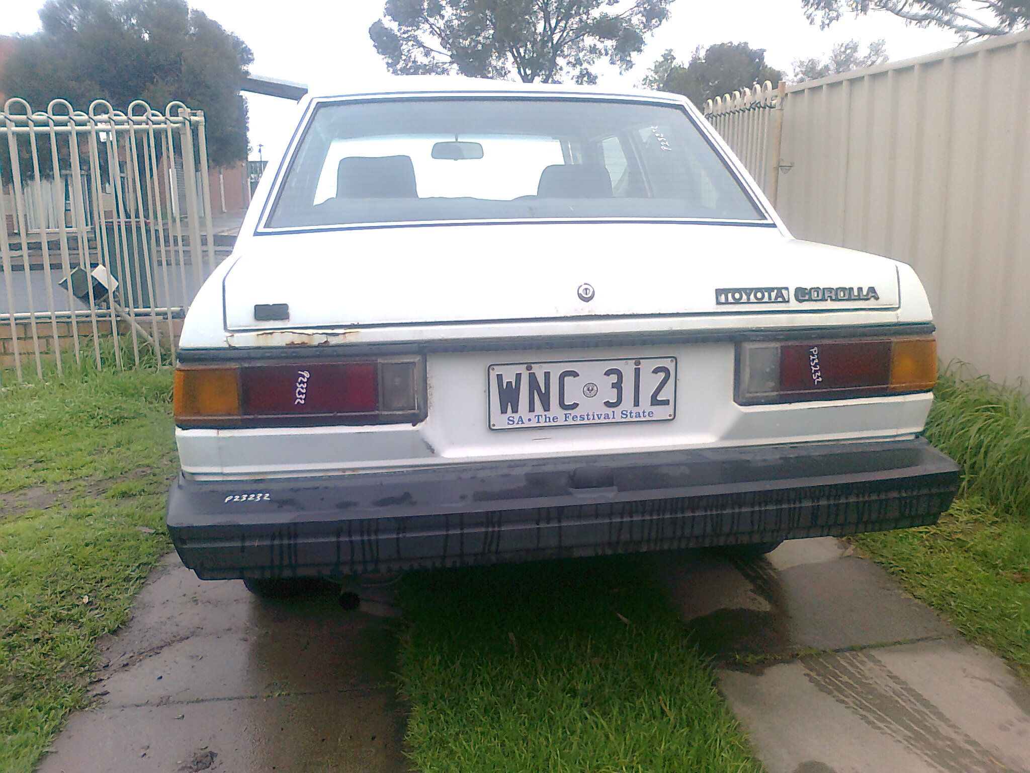

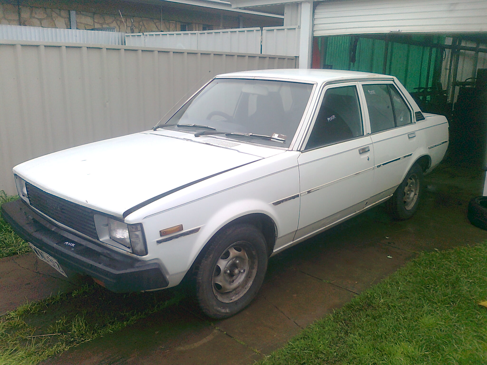

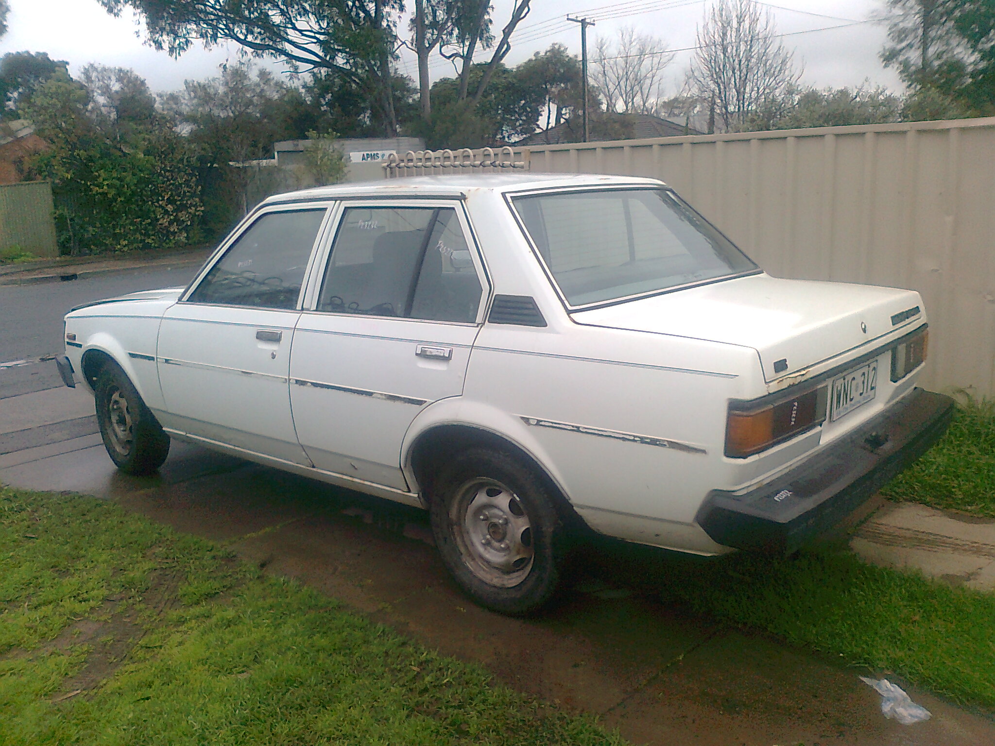

Just picked up this ke70 for cheap a few days ago, the motor in it is good runs really well but its a auto. the body has rust in the boot and around the fuel cap (its pretty bad). the interior is surprisingly clean Not really planning to go too nuts with this car, I'm just gonna lower it and paint it, and mabye some wheels.
I bought it from Just Wrecking Toyotas on the cnr of South Tce and South Rd in Wingfield. The guy said it was lucky i called when i did because the car was about 10 minutes away from being completely wrecked, the guys had allready gone out and marked all the parts with a texta which i now have to clean off, lol.

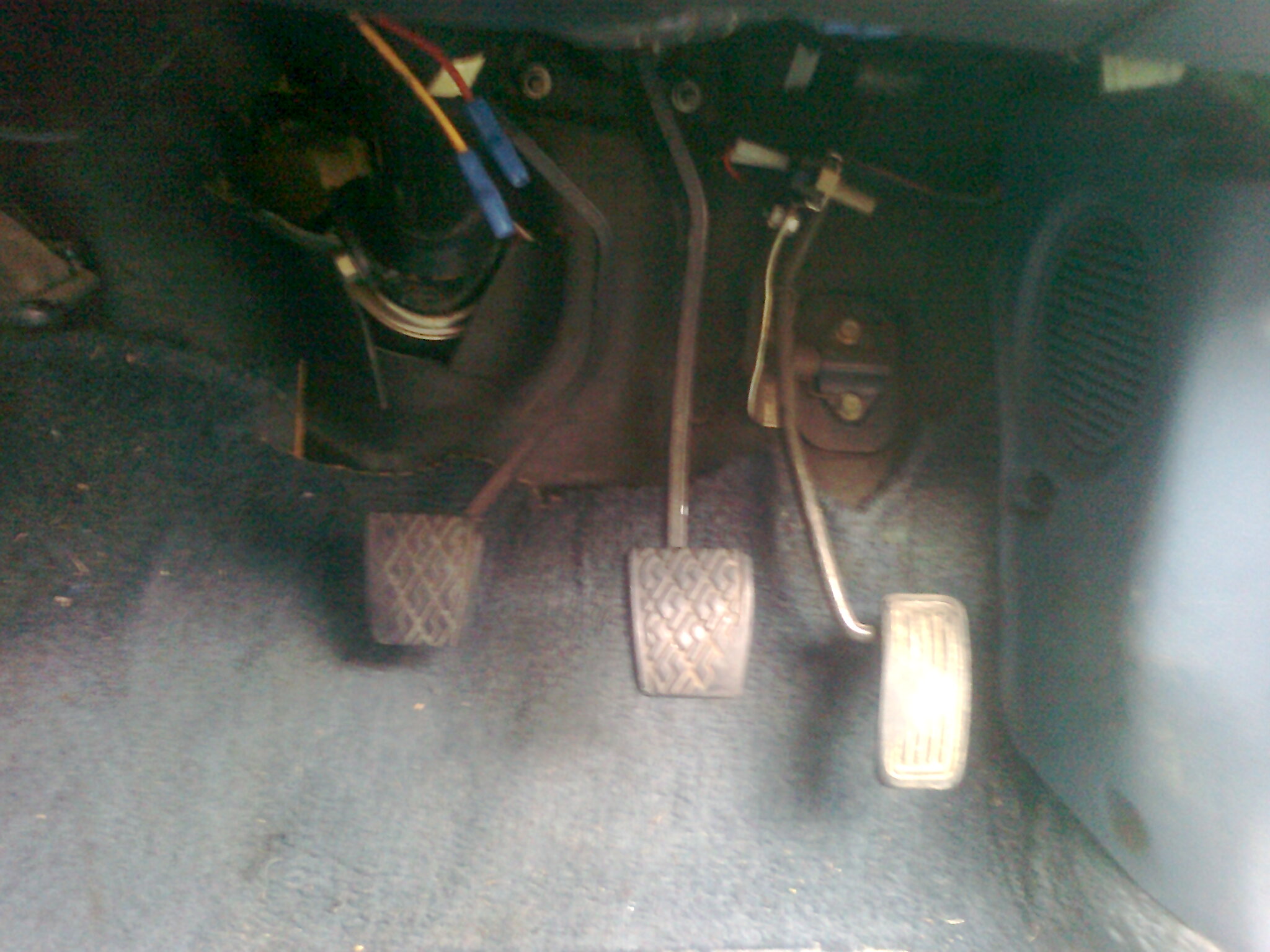

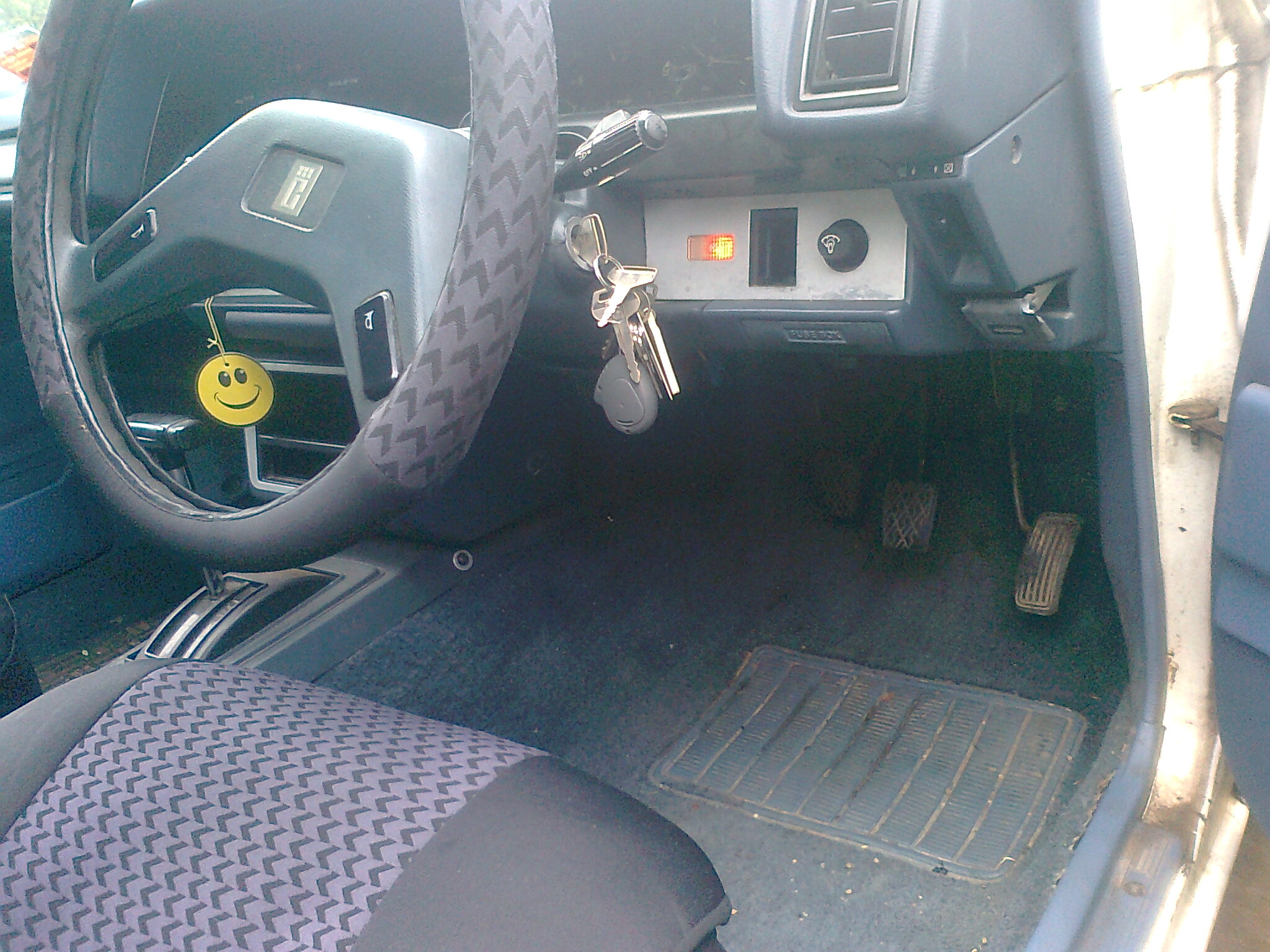

I hate driving autos, so much so that ive decided to
convert this one.

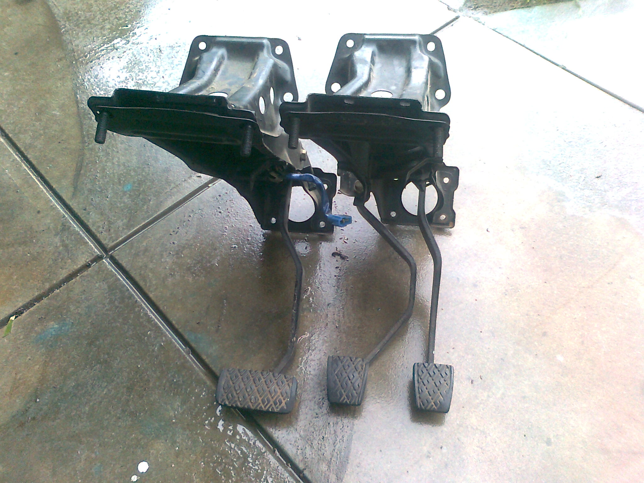

Ive been told that its fairly easy to do, ive got a
K50 5 speed gearbox to go into it and the manual
pedal box aswell, so far ive put the pedal box in and
I'm getting ready to do the conversion, I'm just waiting
to get a heavy duty clutch and the flywheel machined.
Pretty sure the only thing I'm gonna need is the manual
tailshaft and cross member, But are the 4 speed and
5 speed tailshafts the same? i would imagine they are
but I'm not sure, let me know if youve done this before. :lolcry:
Changing the pedal box is very awkward and time consuming
thing to do (probably the hardest part of the conversion) i used
this guide by Rolla Club member 'Altezzaclub' to help locate
all the bolt holes and yada yada, and i got it done in about 3 hours.
very helpful.
http://www.ke70.com/forum/index.php?showto...ed&pid=9479

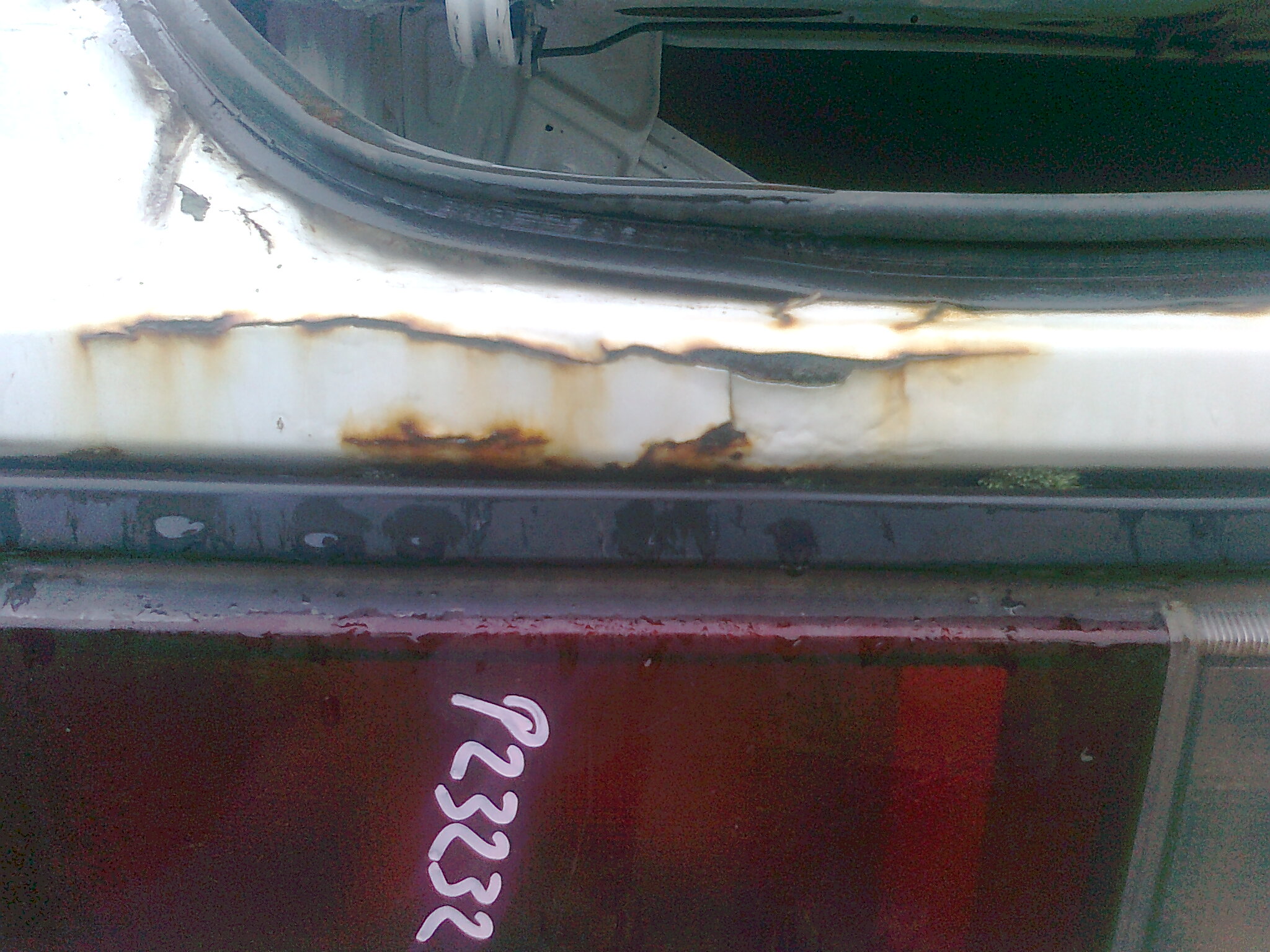

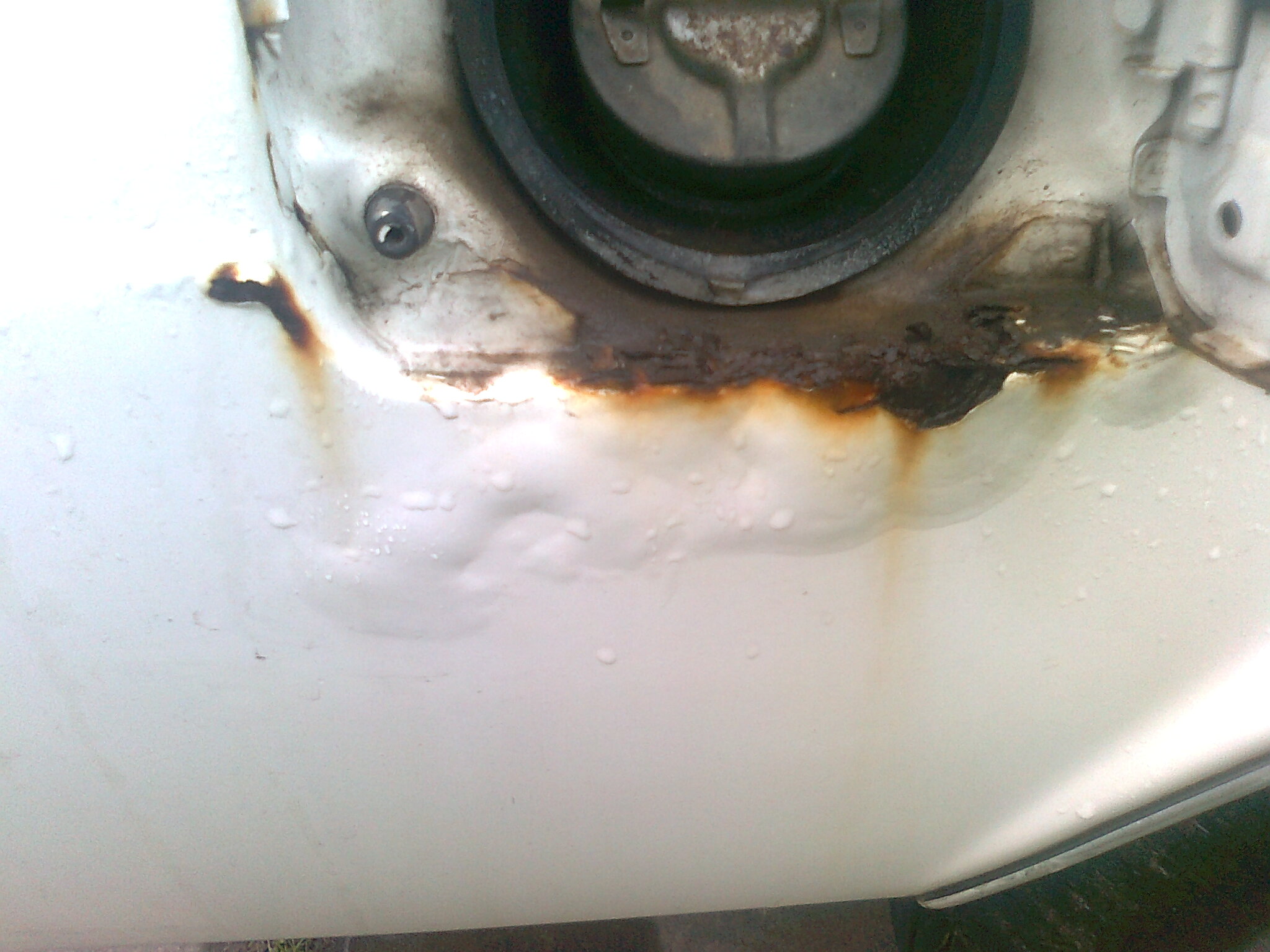

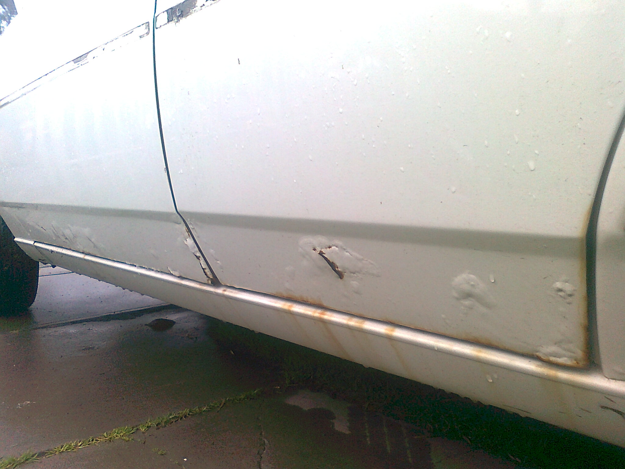

Just thought id throw a few more pics up of the rust in the car,
ive never really done body work on a car with rust this bad so
its gonna be an 'interesting' result I'm sure. I'm just gonna get
some doors that are in better condition then these ones but
the rest I'm gonna have to do something about ASAP.
4 and 5 speed tail shafts are the same.
Bit of rust there mate. But find me a rolla without rust.
If your gonna do a full re paint it'd probably be easier to find better doors. They don't cost much.
Nice car otherwise.

Yeah mate I'm keen for doors, ive even put a thread up in the wanted parts section
requesting some, about the tailshaft, i thought they would be the same i just wanted
to know for sure. thanks very much for the info.
