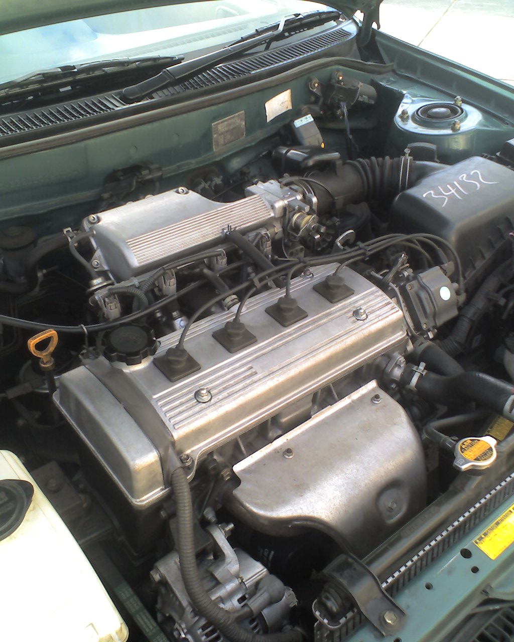

the engine could be a 2nd gen 4afe and it has 40mm webers or dellorto carbs it would be expensive to set up if you didnt have any experience with tuning etc and there isnt much point as the engine is stock and all that would happen is you would gain a few more horses but fuel economy would decline rapidly
also it might need to be engineered because it may not pass emissions

Those are twin side-draught carbs, Dellortos I think, so....
You are right, there would be no room for air filters under your bonnet.
You might get a few bhp, but you would probably use half as much fuel again.
..and if you want trumpets then indivdual throttle bodies fitted to your engine would be the way to do it. I'm not sure what manifold you would need, but if Harry is right then 20v is the way to go. You'll also get an amazing induction noise coming in through the dashboard!! :D
Most people end up with a 4AGE or a 4AGZE engine swap after looking into modding there FE. You're FWD so get a 20V halfcut and the conversion will be relatively easy. Open trumpets on a FWD motor is a bit of a no-no, you'll be sucking up air thats been heated up by the engine bay, it'll sound cool, but loose power.

As stated above, carbies will be a big no-no if you want to keep it registered, they're a big leap backwards as far as emissions are concerned and won't really make any more power without serious tuning and appropriate cams etc. Plus you'd have no hope in hell of getting sidedraughts + airfilters to fit in the engine bay.
Trumpets/ITBs are possible, but you'll have to bring over the ECU from the 20V (which may not work 100% as it is designed for a much higher revving engine) or go aftermarket, both of which will probably cost decent amounts of money.

also those carbs and the manifold are fitted at angles to each other, not good for airflow at all.
