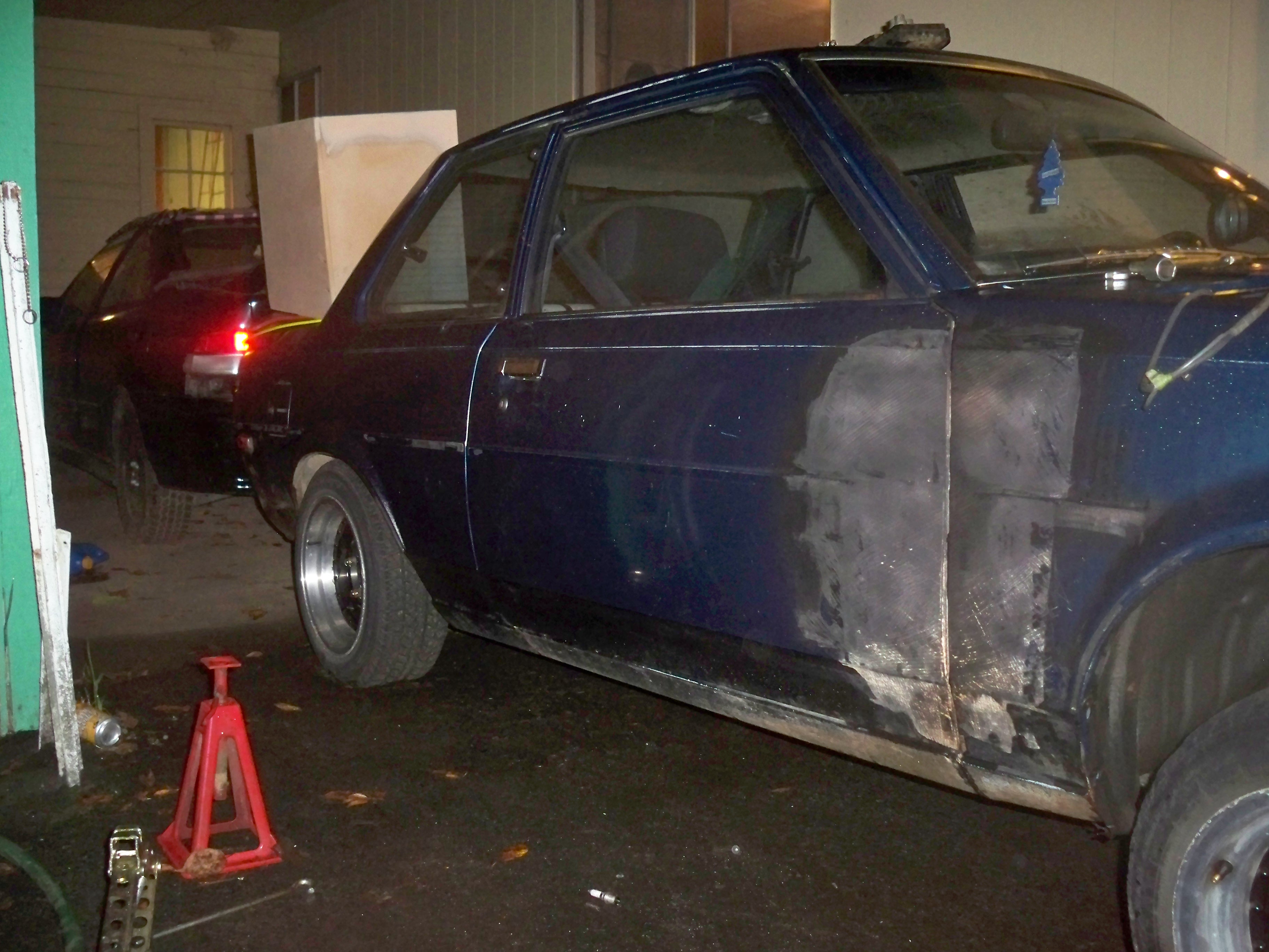

November 14, 201016 yr comment_482162 Hey guys i have a 1980 toyota corolla with the 4 round headlights in the front not sure what the model is as far as ke** or w/e but heres a pic of what it is an was wondering if someone would know what ALL would i need to throw a 4age into my car i found one currently here in the states with only 85k miles pretty stoked just wanting to know what i was gonna need thanks. Report
