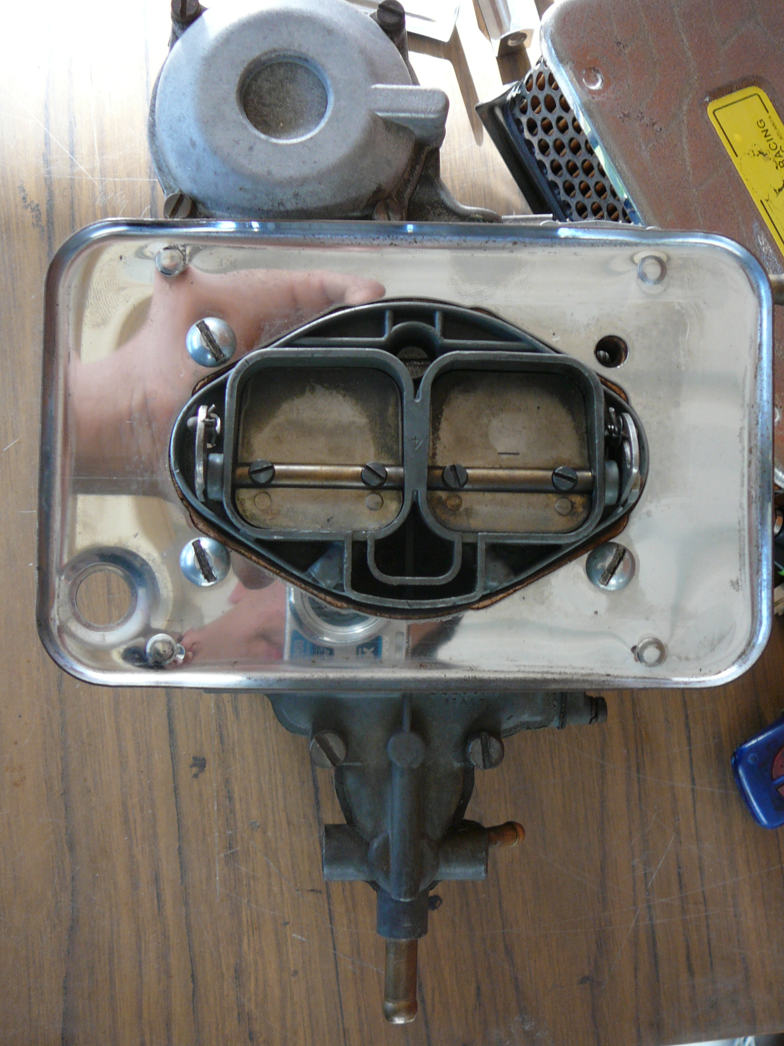

Evan G Posted February 17, 2011 Author Report Share Posted February 17, 2011 (edited) bottom left corner is where the breather connects to the air filter. breather hose/air cleaner, Edited February 17, 2011 by Evan G Quote Link to comment Share on other sites More sharing options...
altezzaclub Posted February 17, 2011 Report Share Posted February 17, 2011 Micmac, don't KE55s run PCV systems?? My KE70 motor has two vents in the tappet cover, the rear one going through the PCV valve to the inlet manifold. This creates suction that clears the oil fumes out of the crankcase & sump. To let air IN to replace the fumes being sucked out the other vent on the tappet over sucks clean air from the air cleaner. Evan you're right, the air correctors have more effect at high revs. The idle jets get you going up to a couple of thousand revs, then the main jet system. I thought the air jets were about main fuel jet + 60, so a 130main fuel needed a 190 air jet as a starting point. Quote Link to comment Share on other sites More sharing options...
