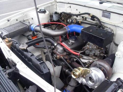

I'll just leave this here...

Dude it's upside-down lol. Hmm log mani will be your biggest draw back
Roller bearing 28 series?
Stu.
Yeah i know it's upside down lol. The mani's cheap so i reakon i'll get it, Gotta see if i can spin the outlet housing to point to the passenger guard.
It was running that was on the original setup..
That's the setup i bought, minus a fuel system, oil/water lines etc
Just looking to refine it with a fmic etc

Yeah man just undo the bolts for the housing clamps very slightly. Be carefull not undo it too much as it will give it a chance to cock over a nick the wheel. Then just turn it all to suit. That works for both housings.
Check for clearance issues as it looks like it's out of a ke3x-5x which have a wider bay than a ke-1x.
But it can all be adjusted to suit when you have a base to work Fromm.
