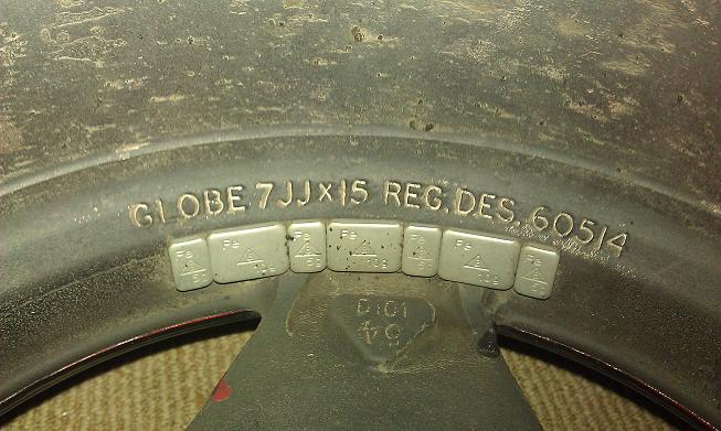

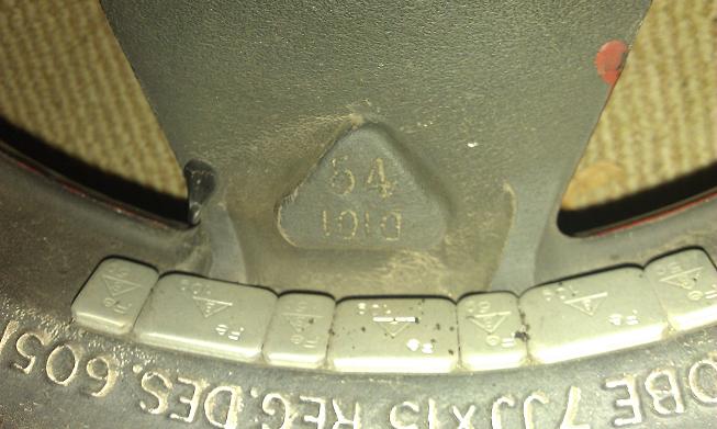

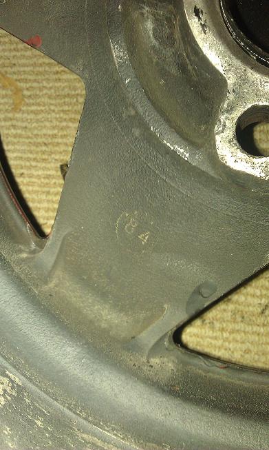

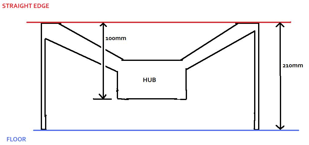

B.L.Z.BUB Posted March 29, 2011 Report Share Posted March 29, 2011 (edited) Ok just trying to figure out my offset as I am buying new wheels and want to use my old ones as a reference. Few pics of the inner wheel stamps. Also I laid the wheel flat and measured the width, then the distance from the hub to the face. I'm guessing +5 or +10? Any ideas? Am I measuring the wheel right, I found a few things on google about it but some contradict others. Cheers Fullahs! :y: EDIT : Found this page https://www.rsracing...tech-wheel.html So I'm guessing i have a 110mm back space = approx 4.25inches on a 7"rim +6??? Edited March 29, 2011 by blzbub666 Quote Link to comment Share on other sites More sharing options...
oh what a nissan feeling! Posted March 29, 2011 Report Share Posted March 29, 2011 yep +5 reed. yes BS is 110 as well. Quote Link to comment Share on other sites More sharing options...
B.L.Z.BUB Posted March 29, 2011 Author Report Share Posted March 29, 2011 (edited) Sweet. The guy at the store was trying to sell me 15 x 7 +20s. But I figure I'm running +5 or +6 (ish?) 15x7 give or take a mm or two with an 8mm spacer, so with spacer pretty close to zero (slight negative ish) o/s. So I'm thinking.... I order +5, lose the spacers so its all legal beagle, eliminate the minor rubbing in the rear guards by giving me essentially the spacer width (8mm) extra clearance. Also order an adjustable panhard rod and centre the diff up with some nolthalane bushes. I figure it'll still look pumped into the guards, keep the rear guards looking stock. Only lose about the spacer width of offset. :y: EDIT: But ill gain a LOT of dish.... :yes: Edited March 29, 2011 by blzbub666 Quote Link to comment Share on other sites More sharing options...
