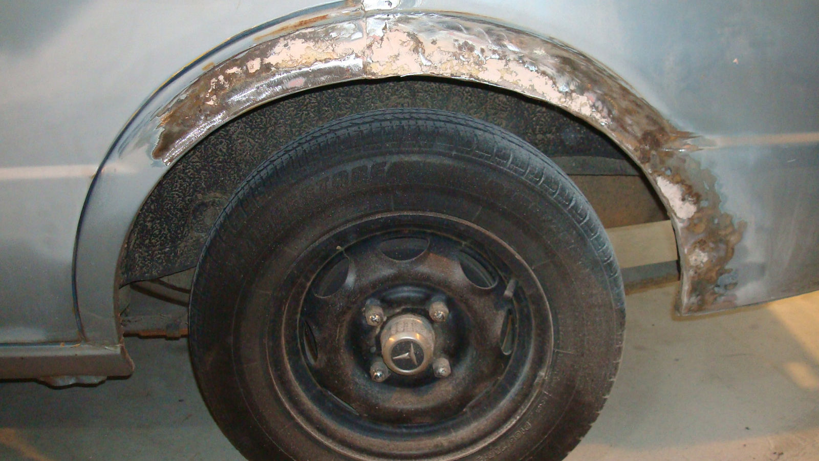

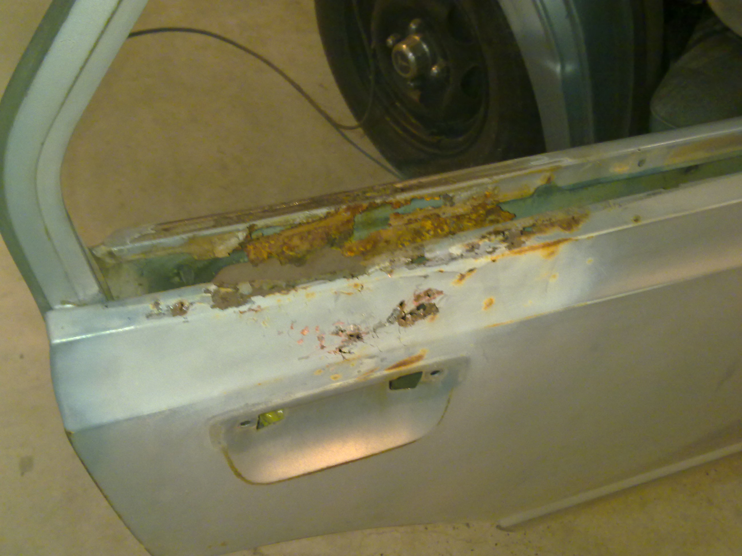

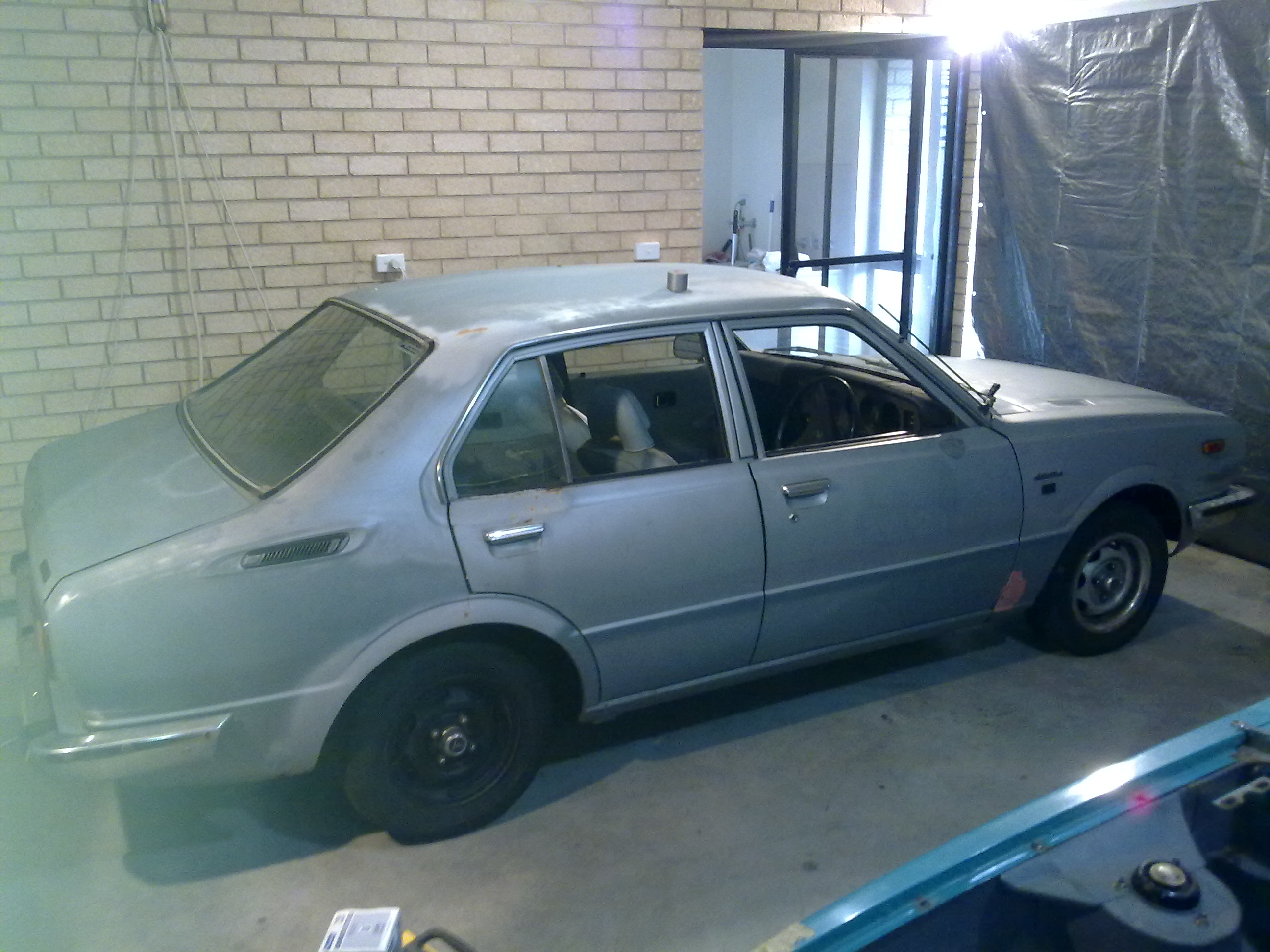

Hey guys a friend of mine asked me if i could cut the rust out of his 55 and give it a quick paint job silly me said yes i should know better :no2:

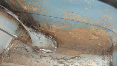

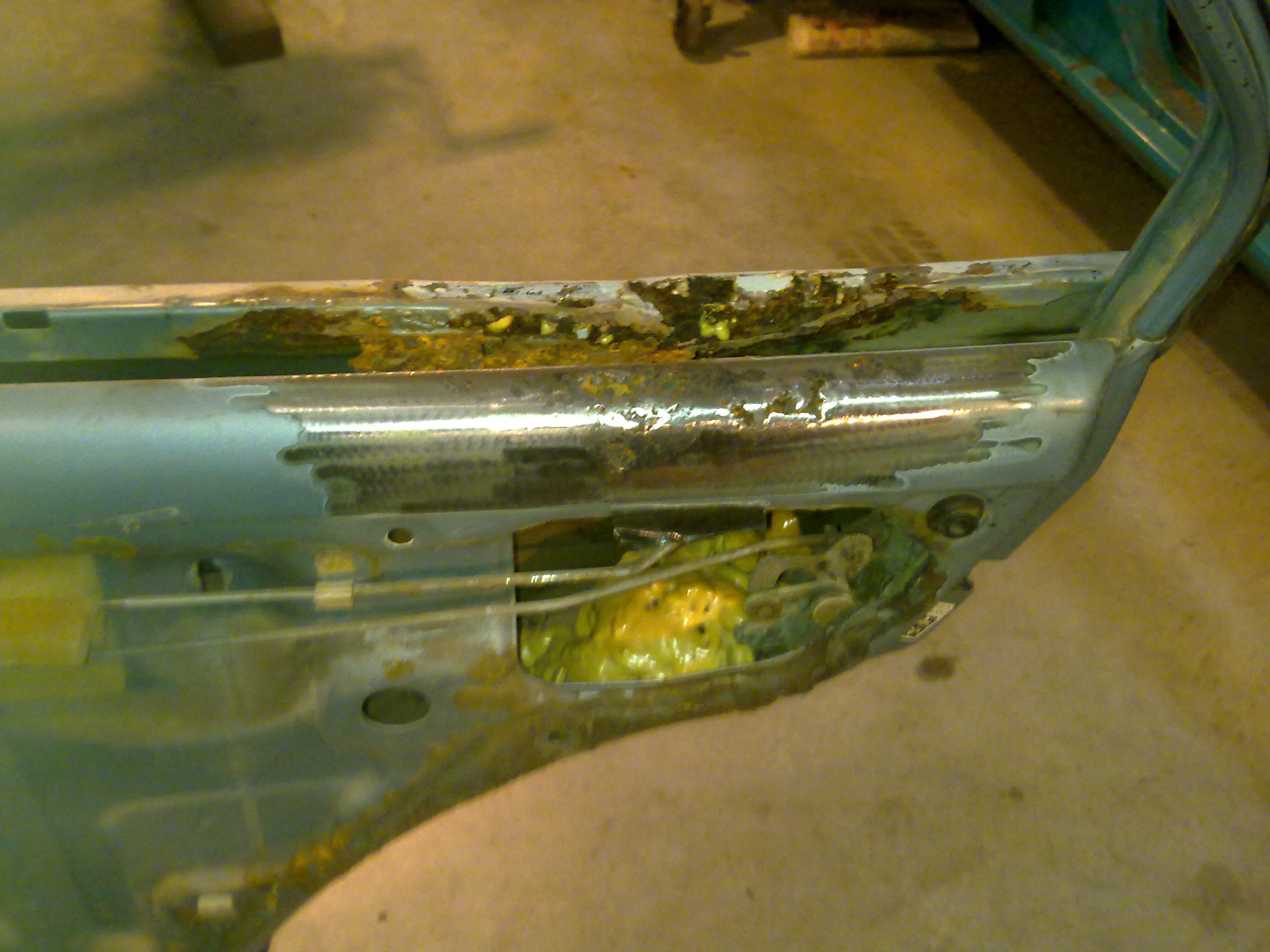

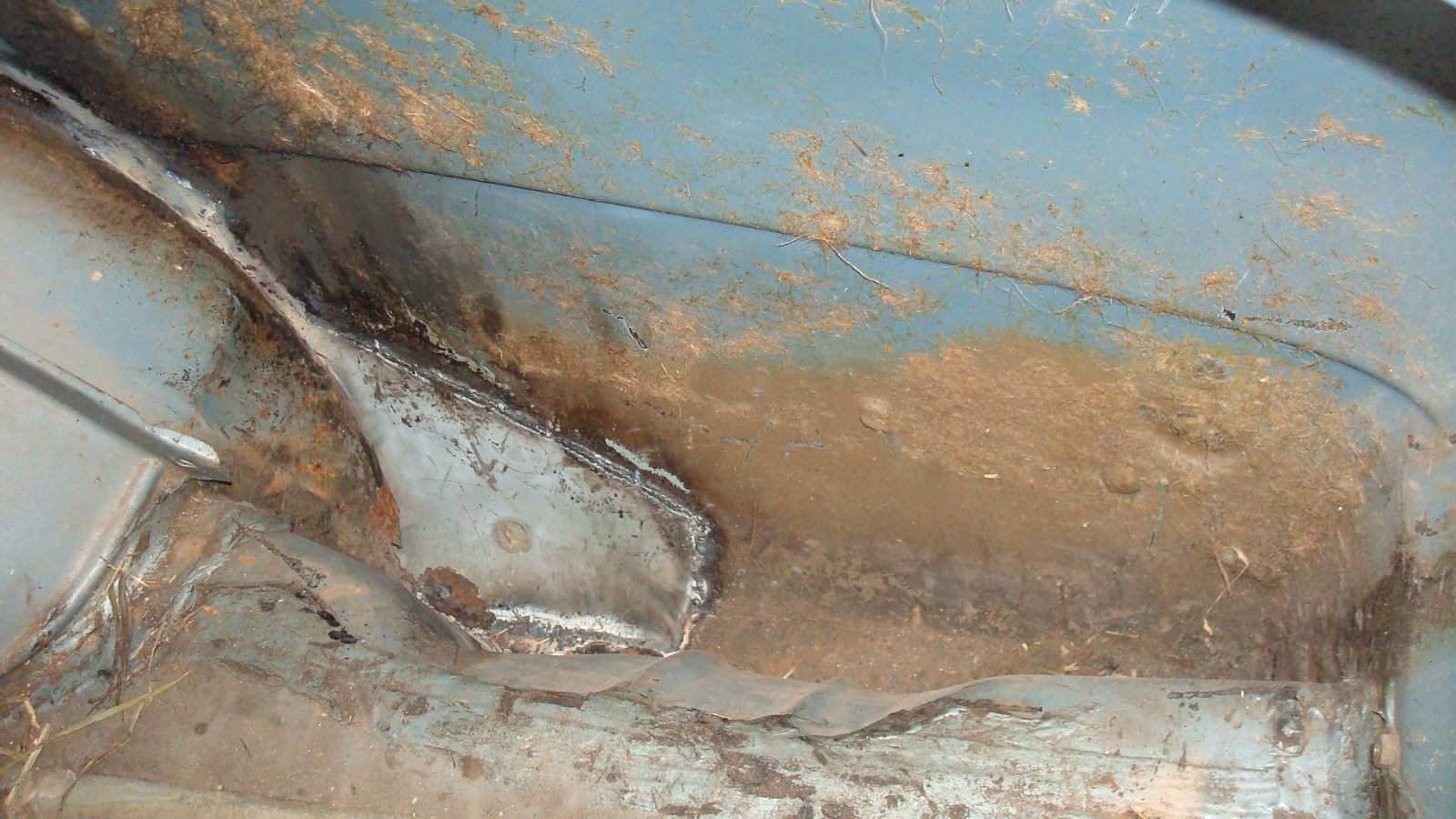

So i got it over and started stripping it down to see how bad it really is and F me it's full of rust selleys space invader and bog :bash:
Edited by 1JZKe55

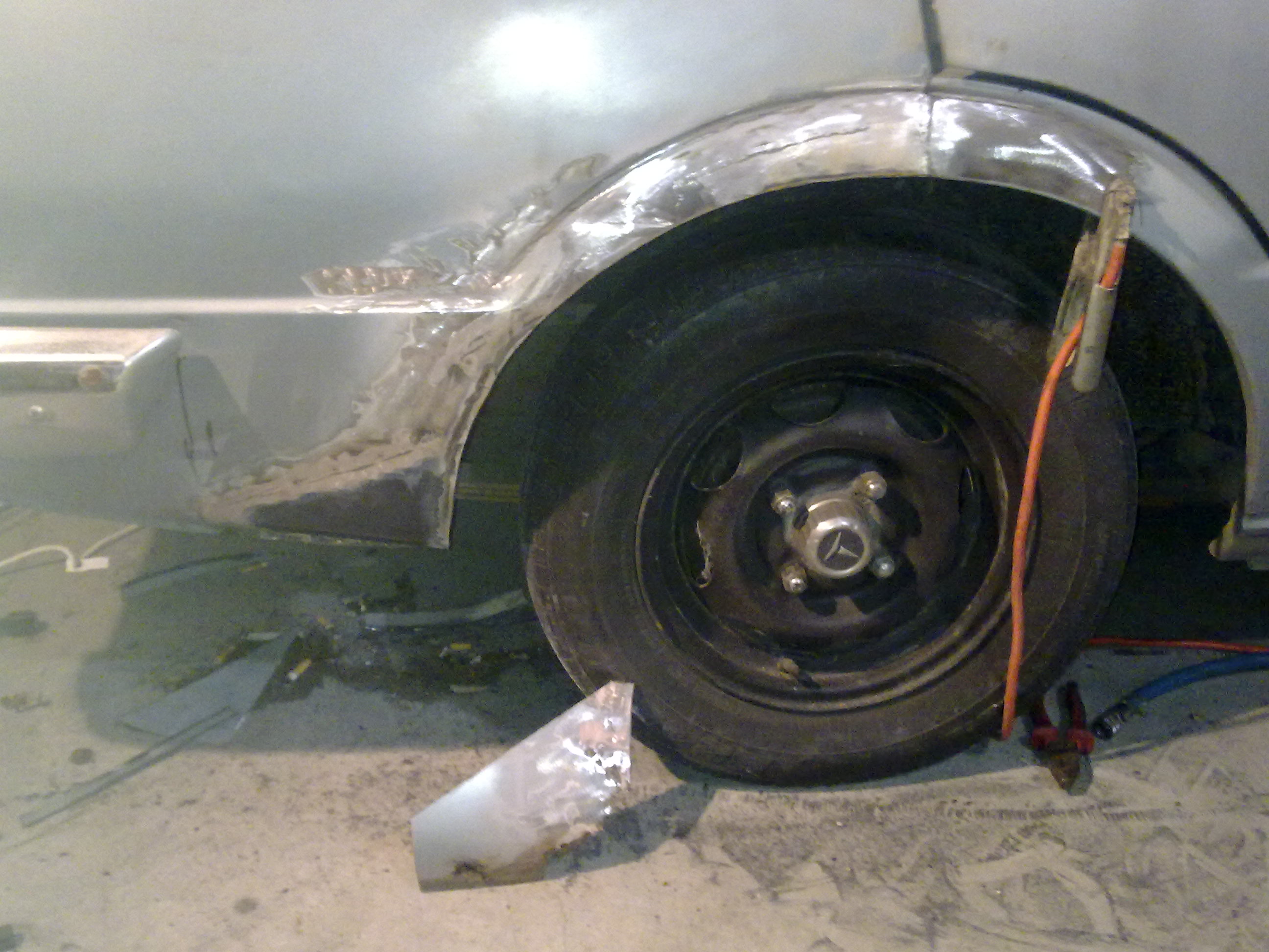

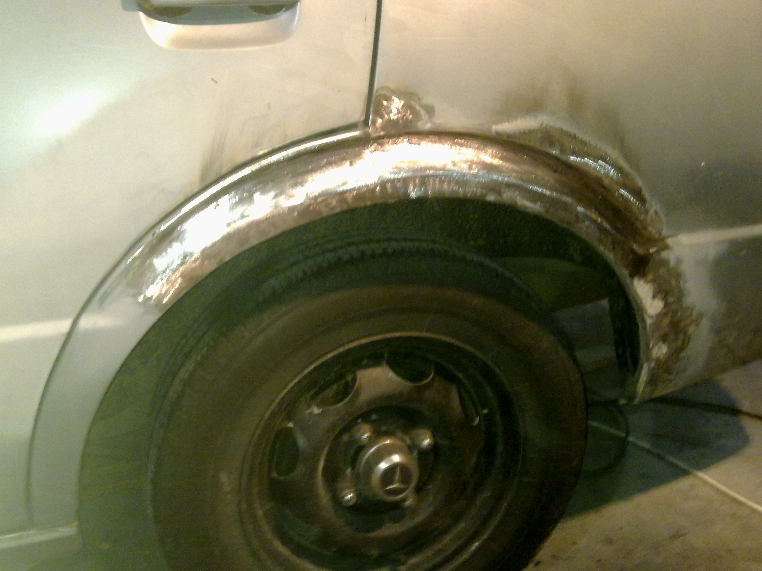

Both wheel arches are f'd back right door front gards/doors just about every panel has rust in it

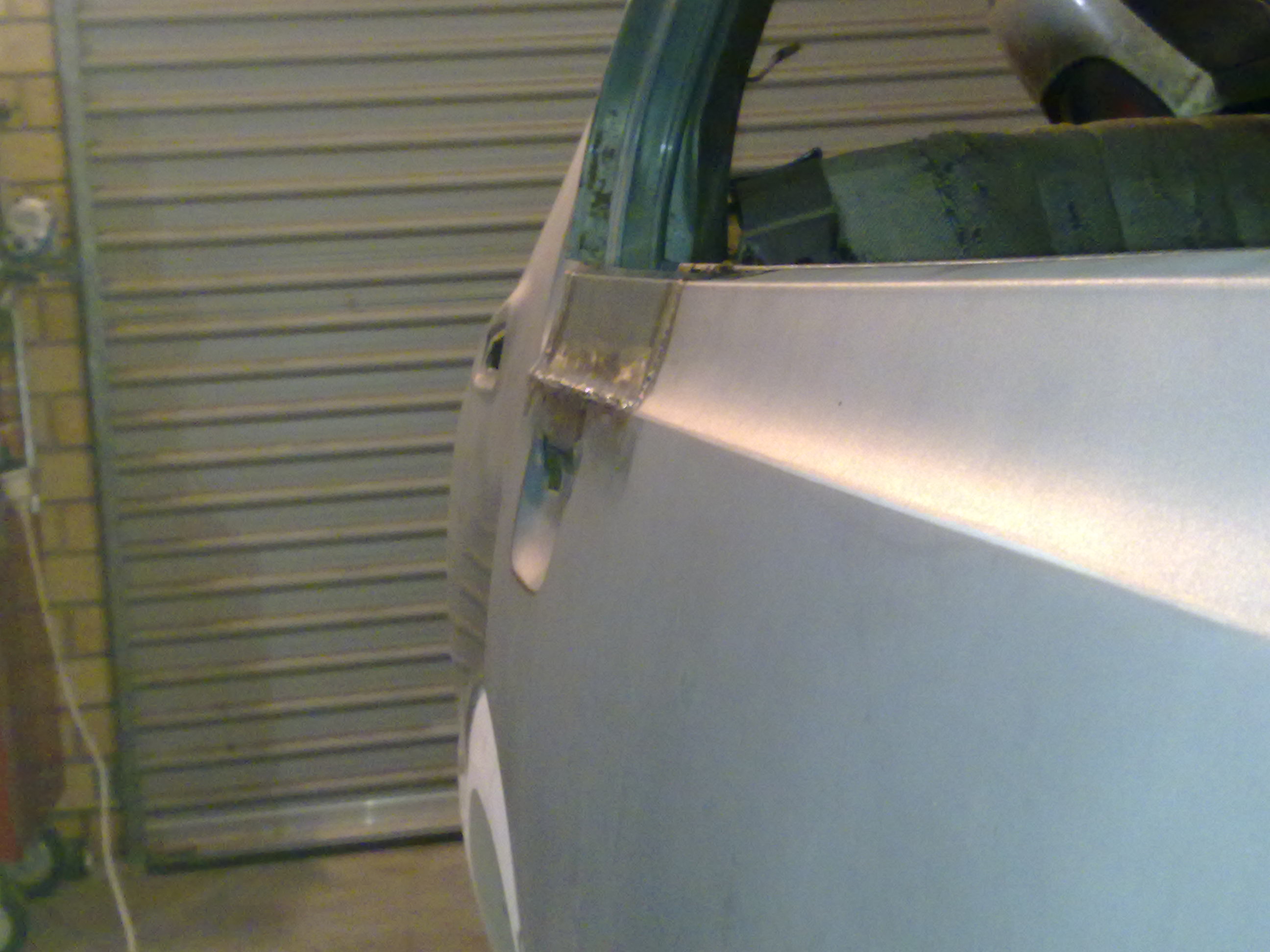

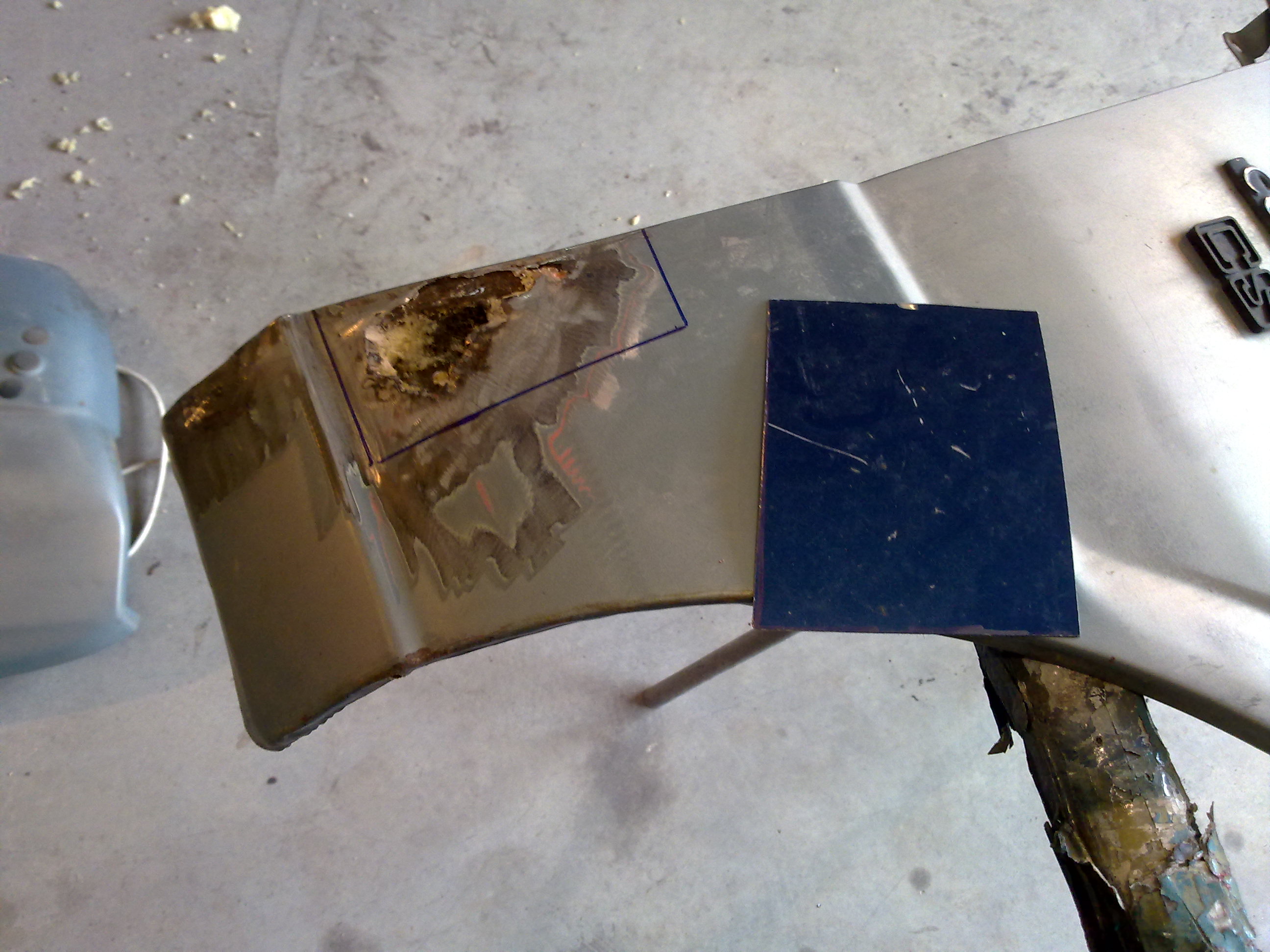

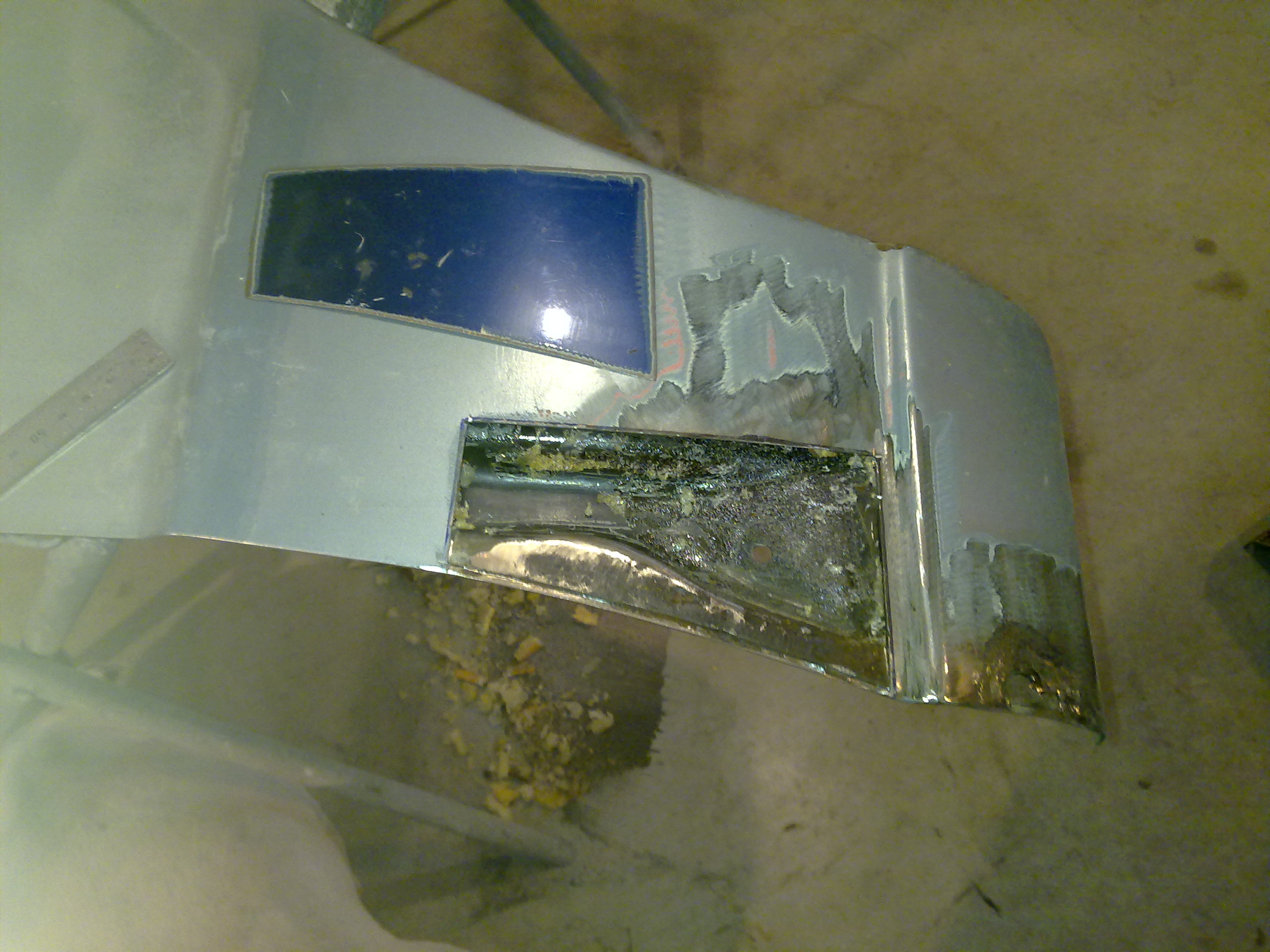

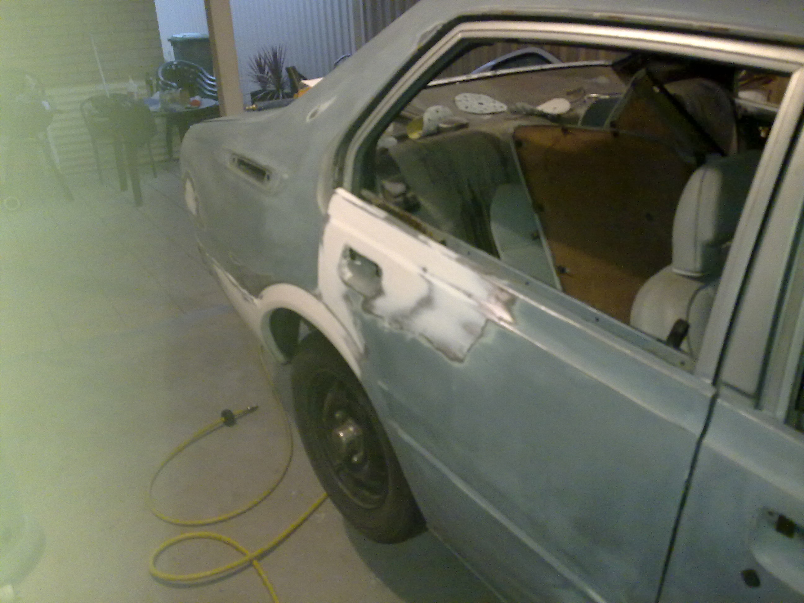

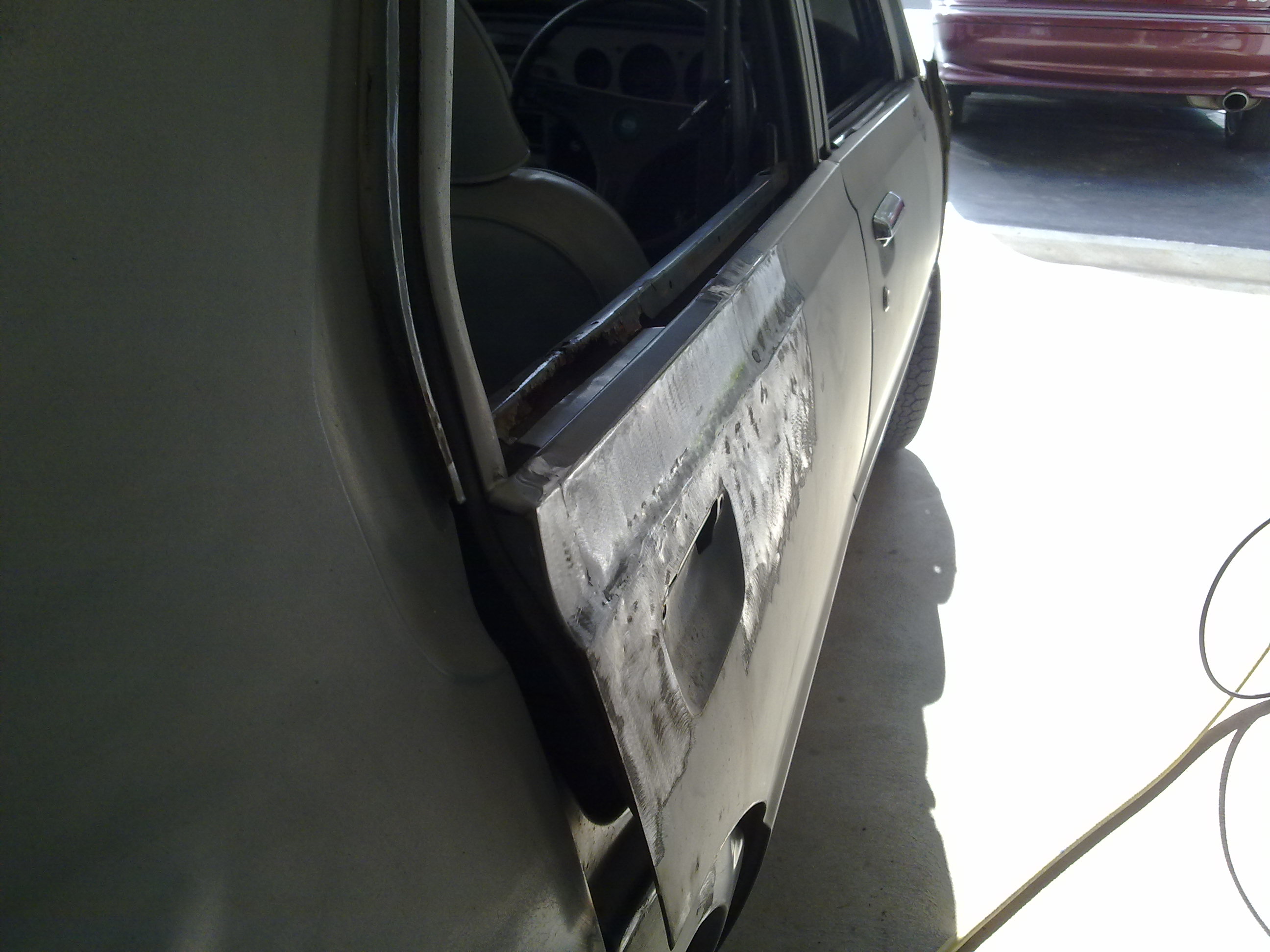

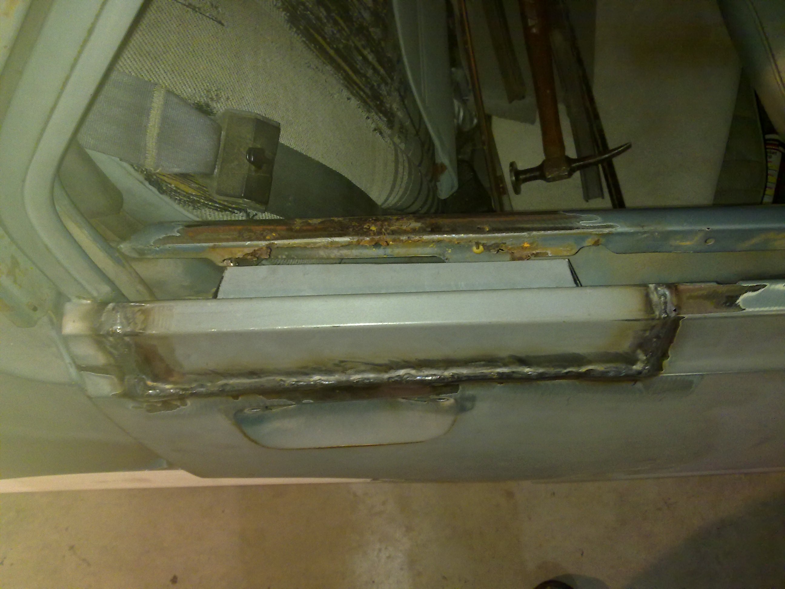

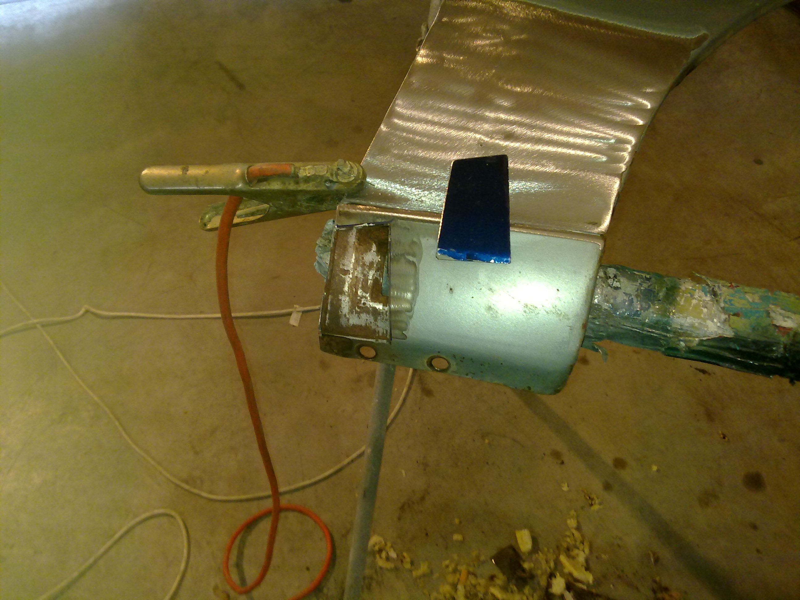

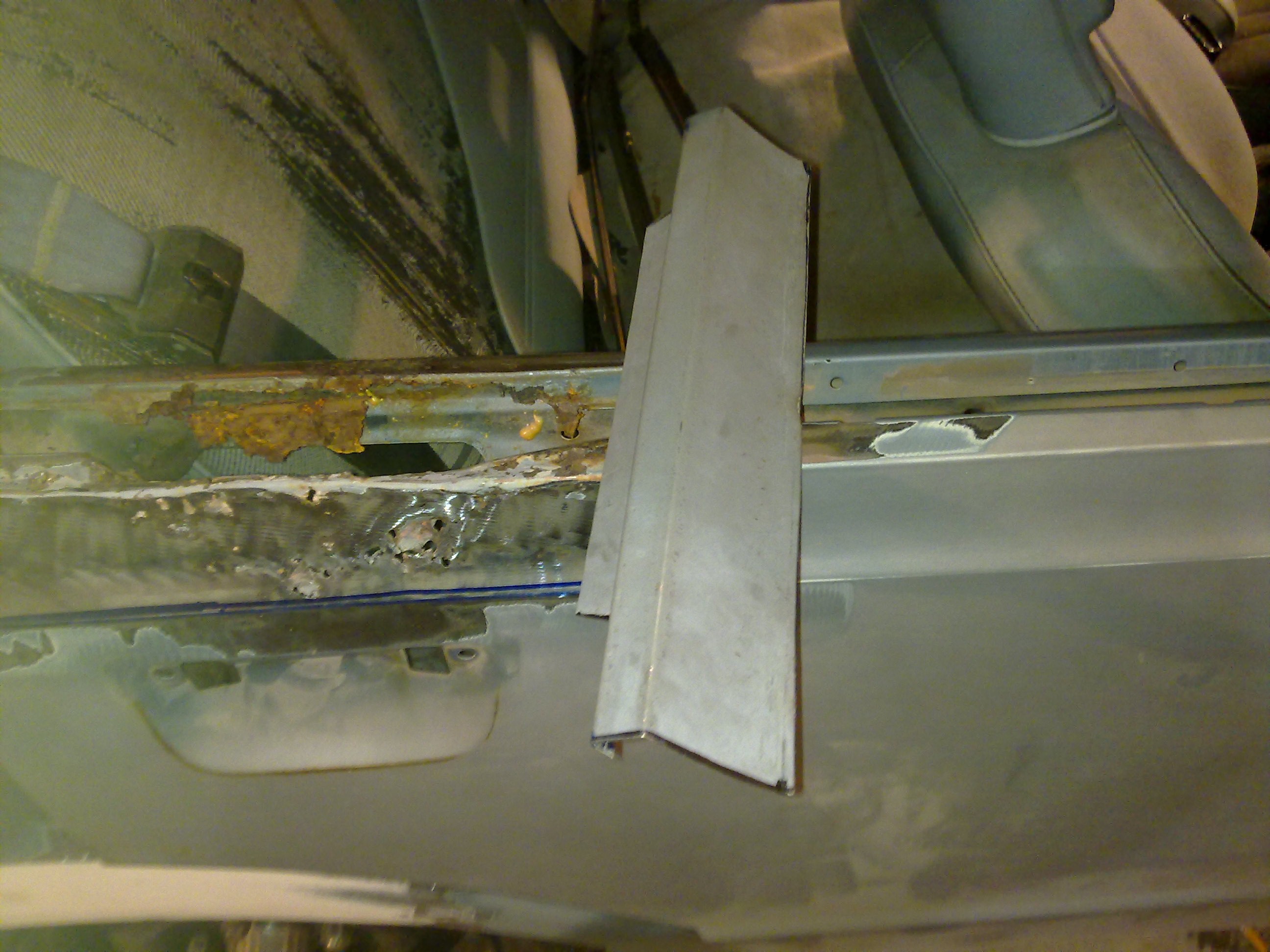

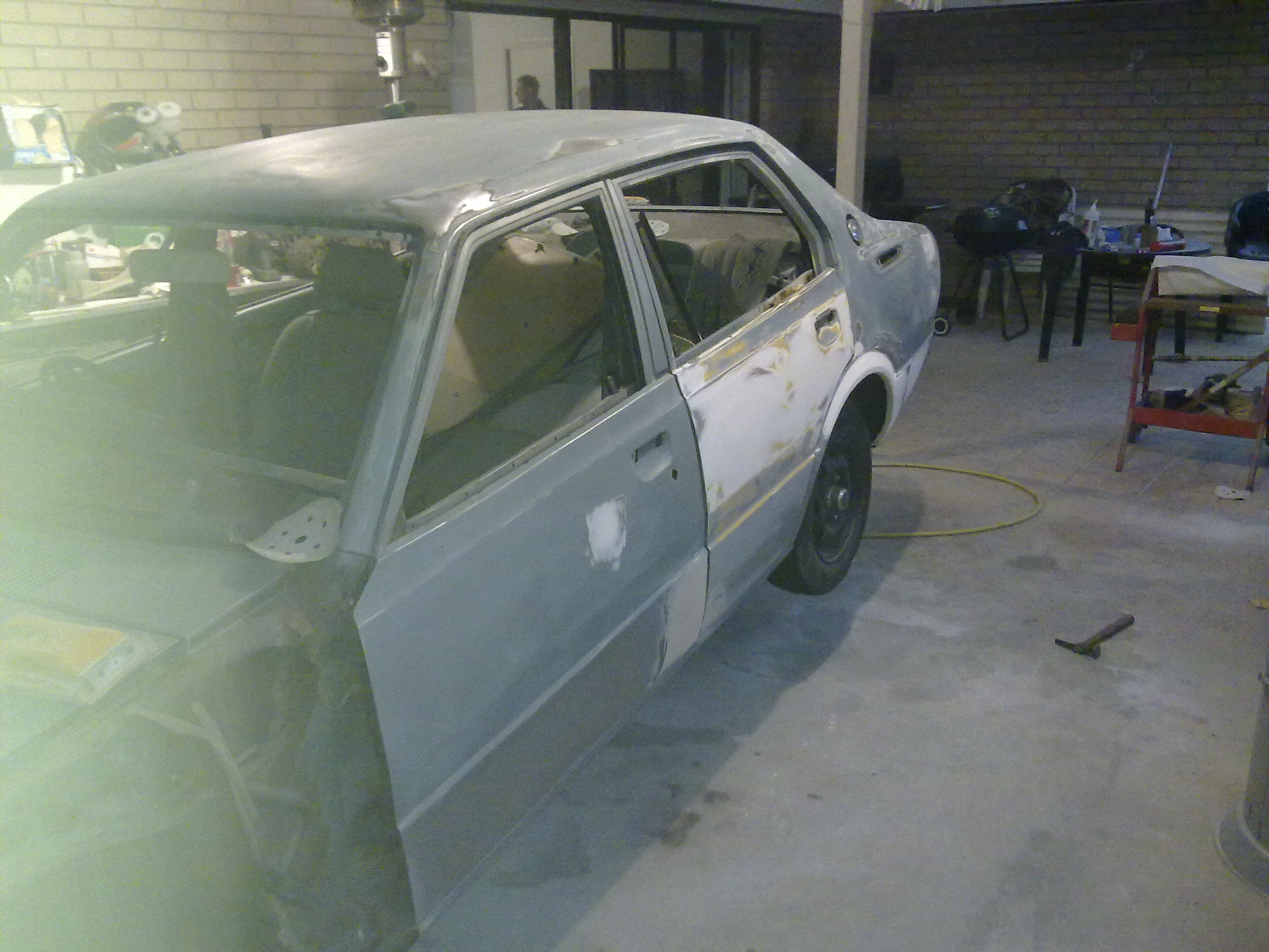

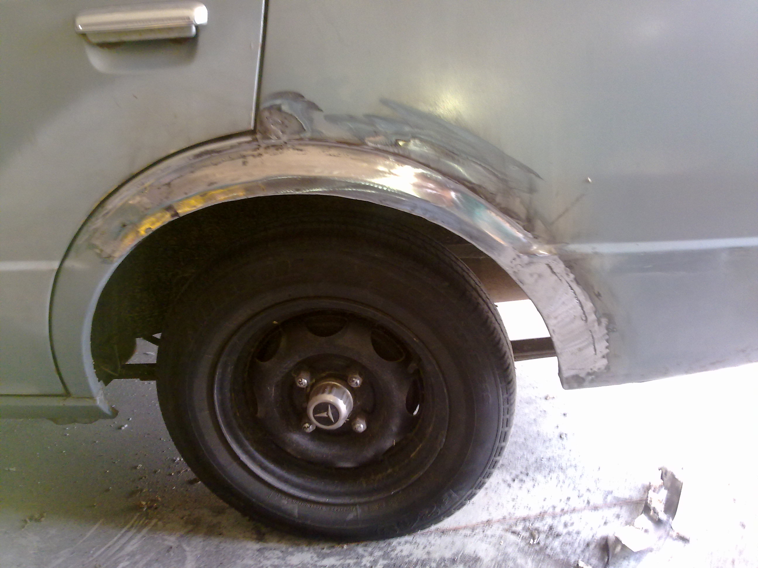

So i started cutting it all out and making some new bits and welded them in

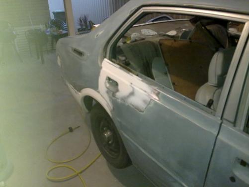

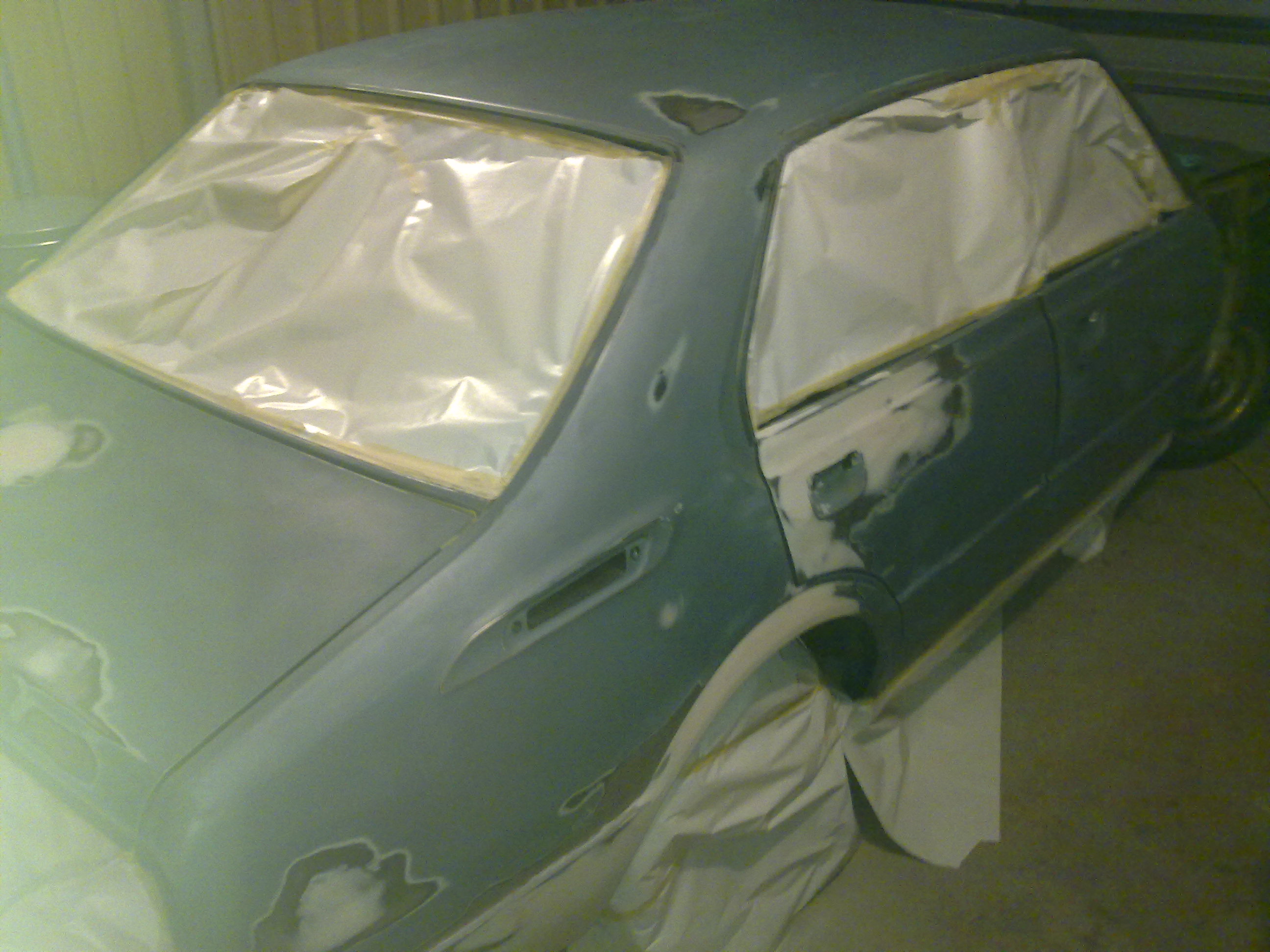

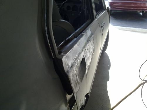

Ok the 3 3/4 of the doors and quarters are rust free at this point ready for bog :P

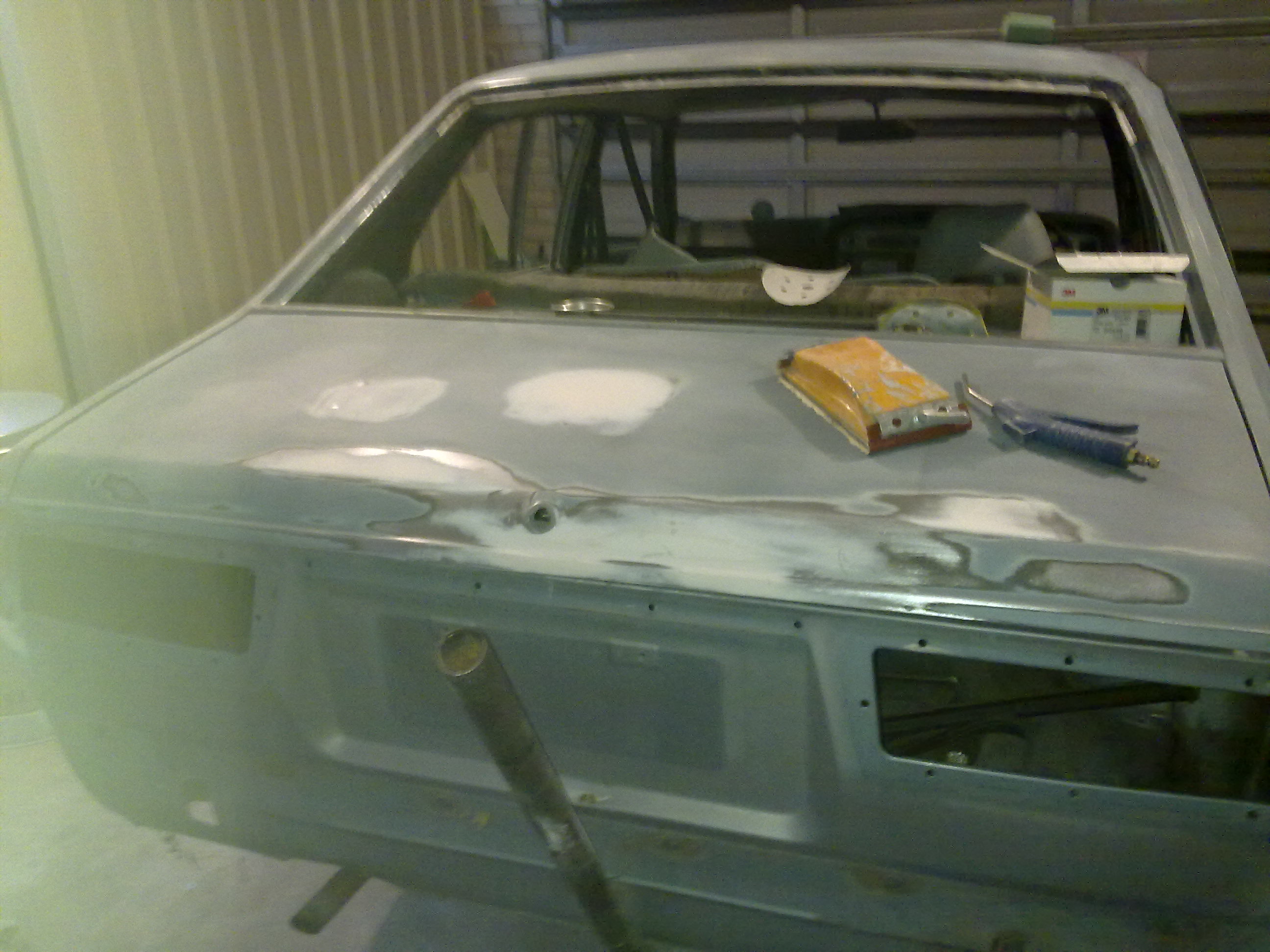

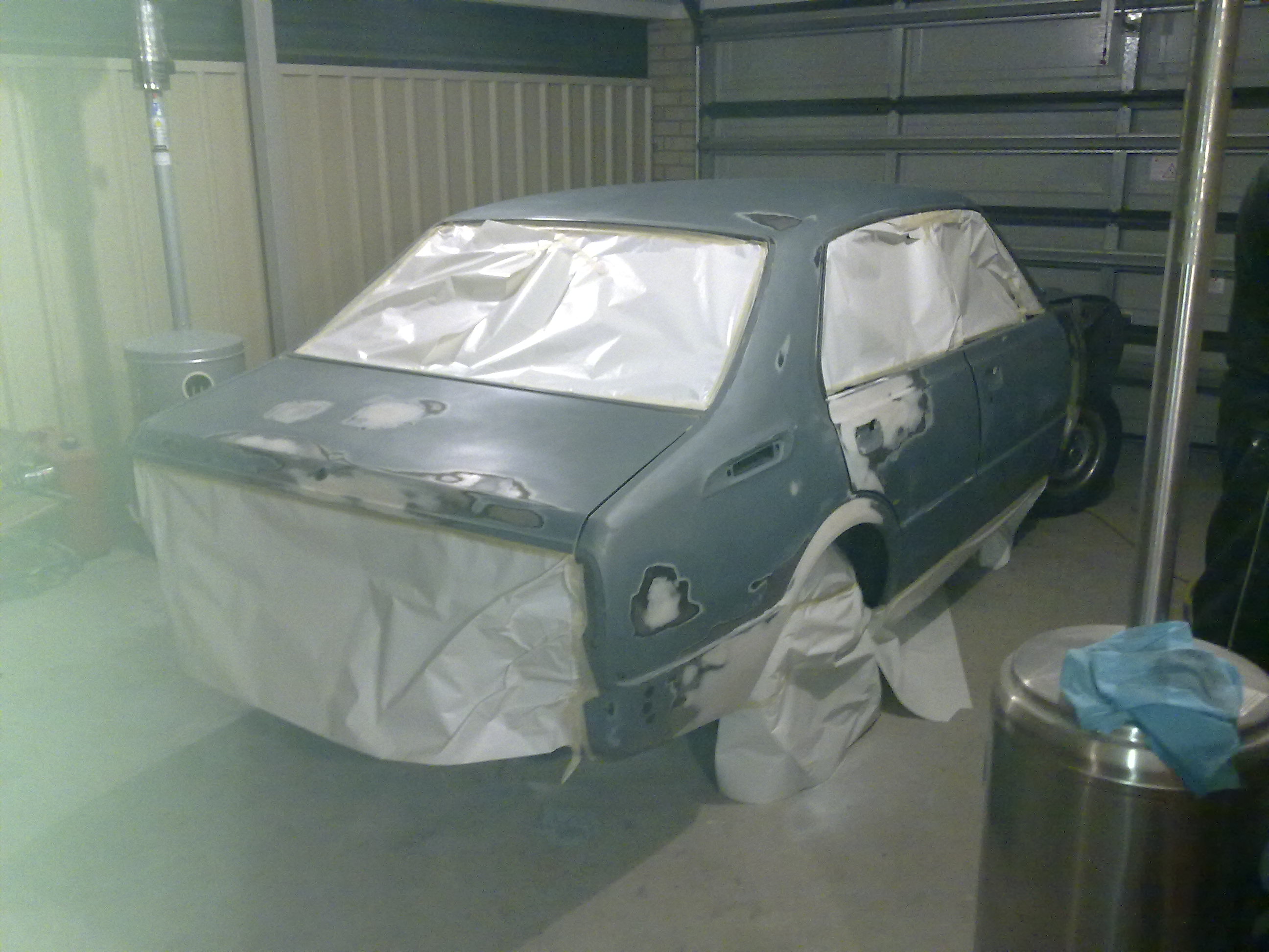

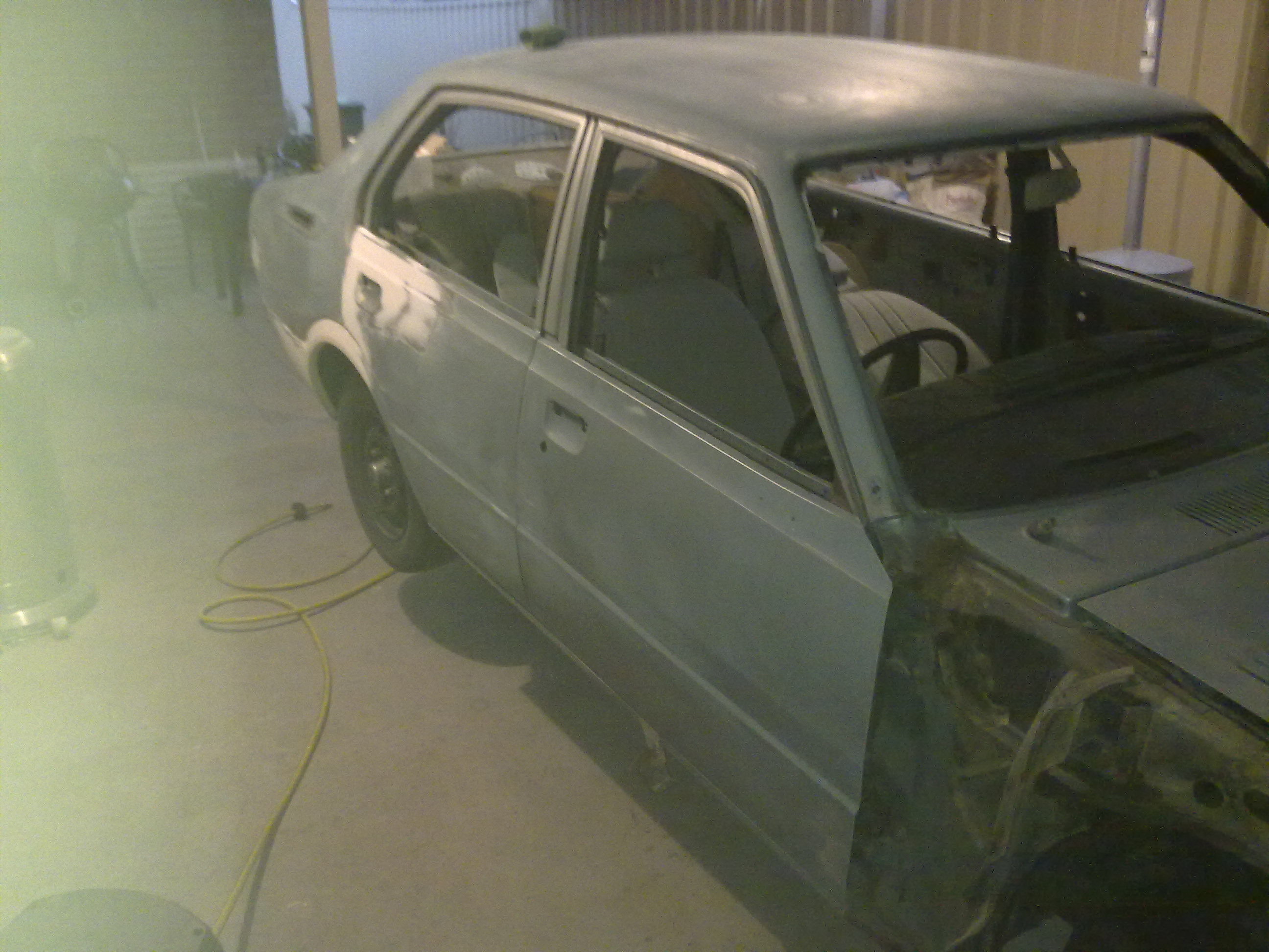

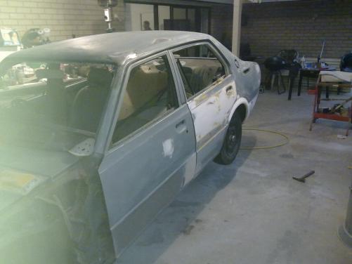

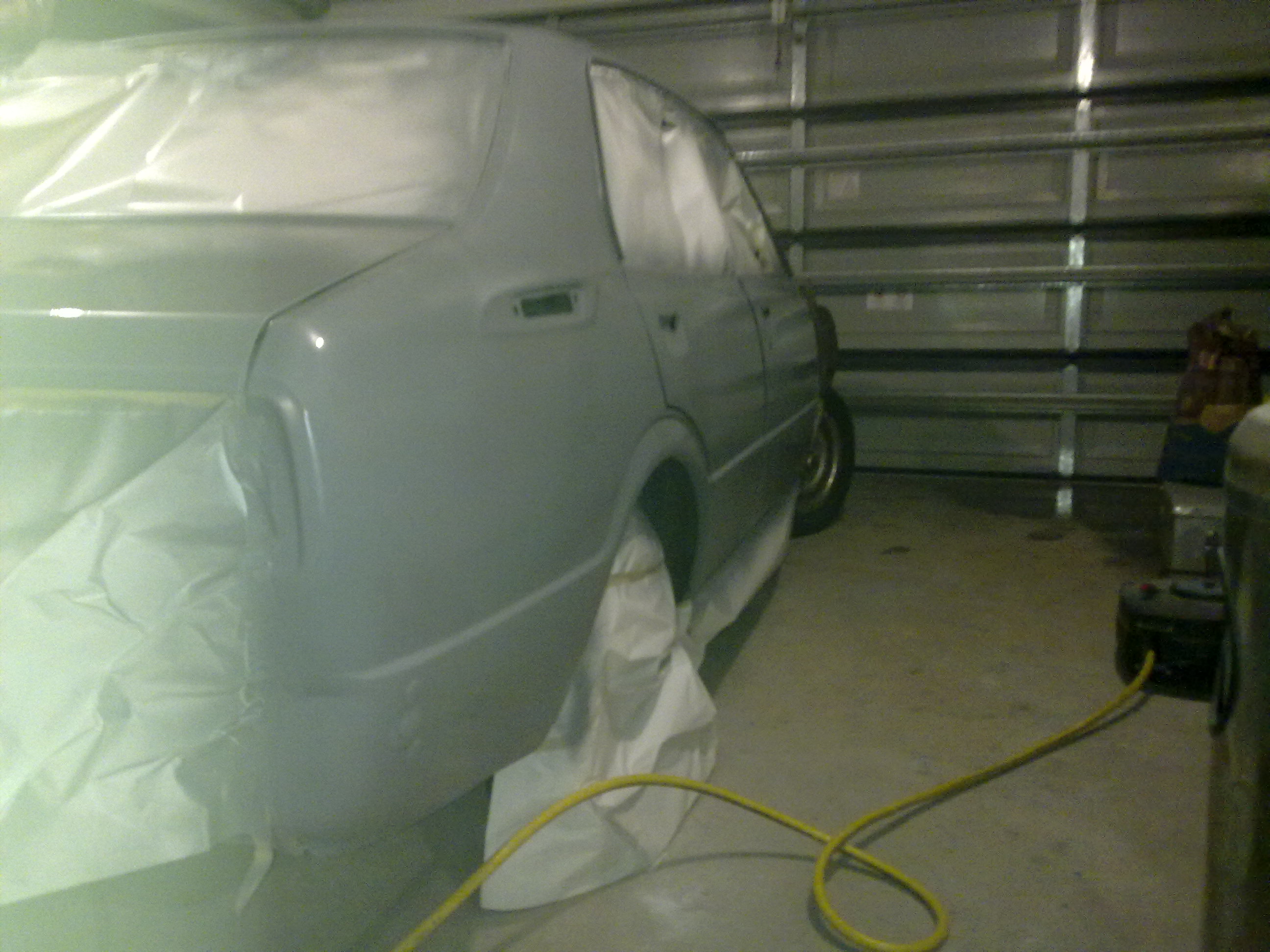

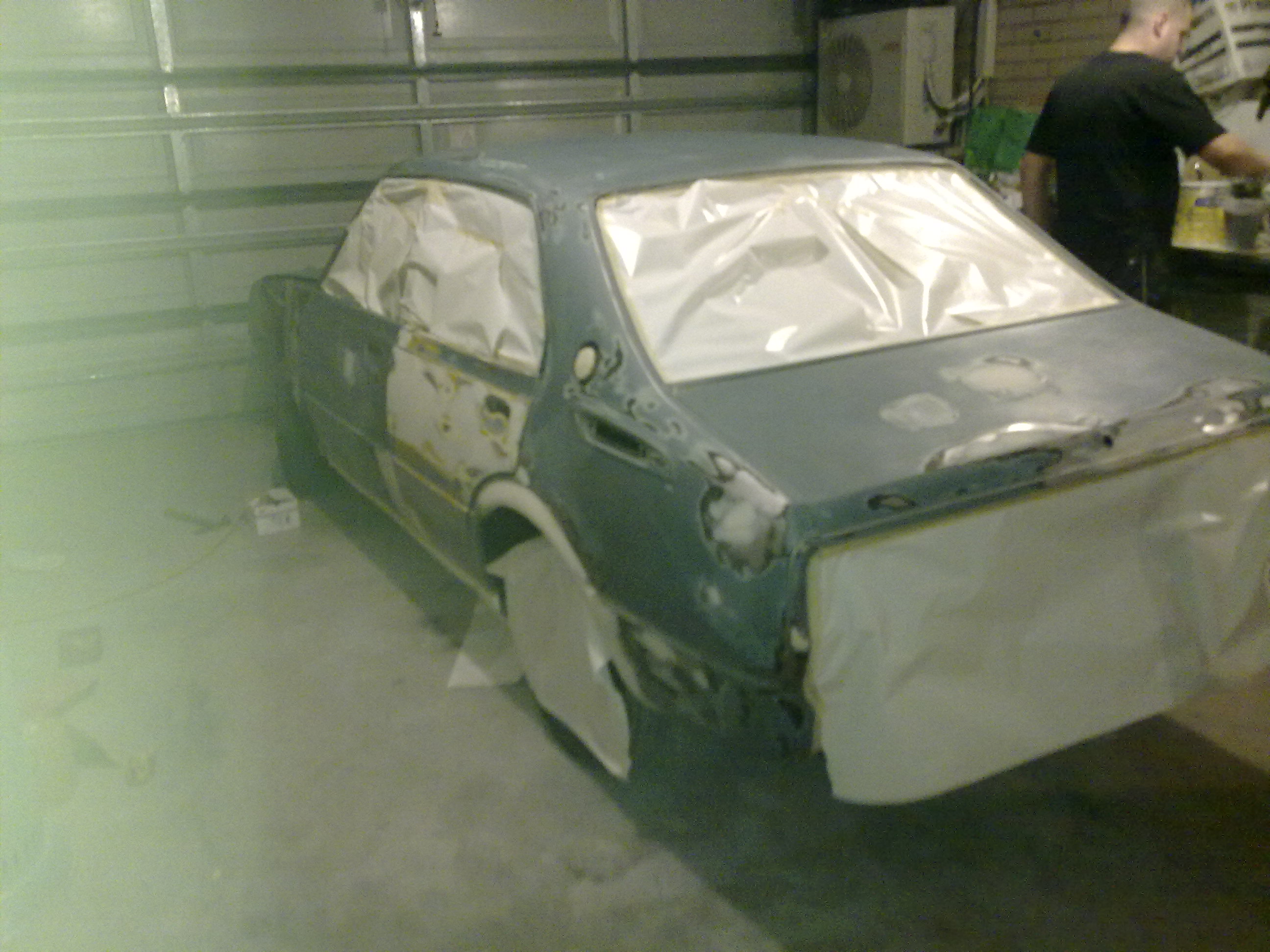

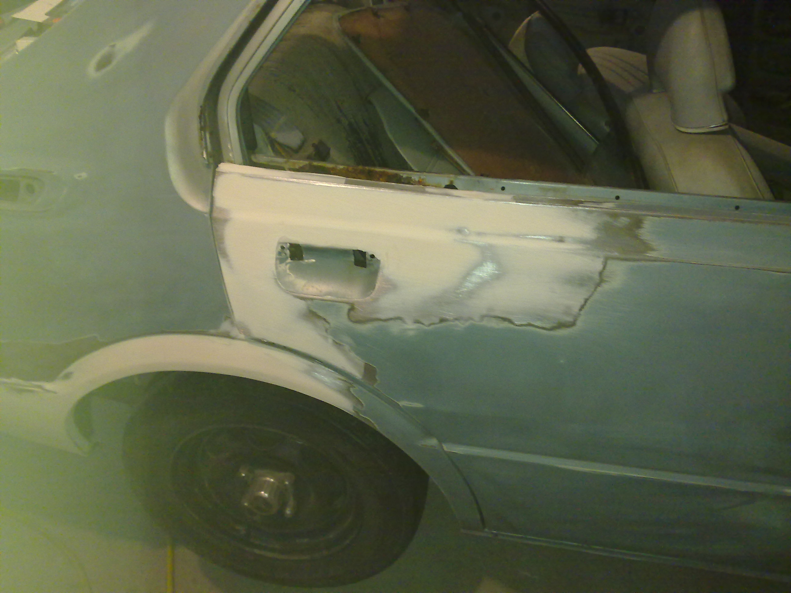

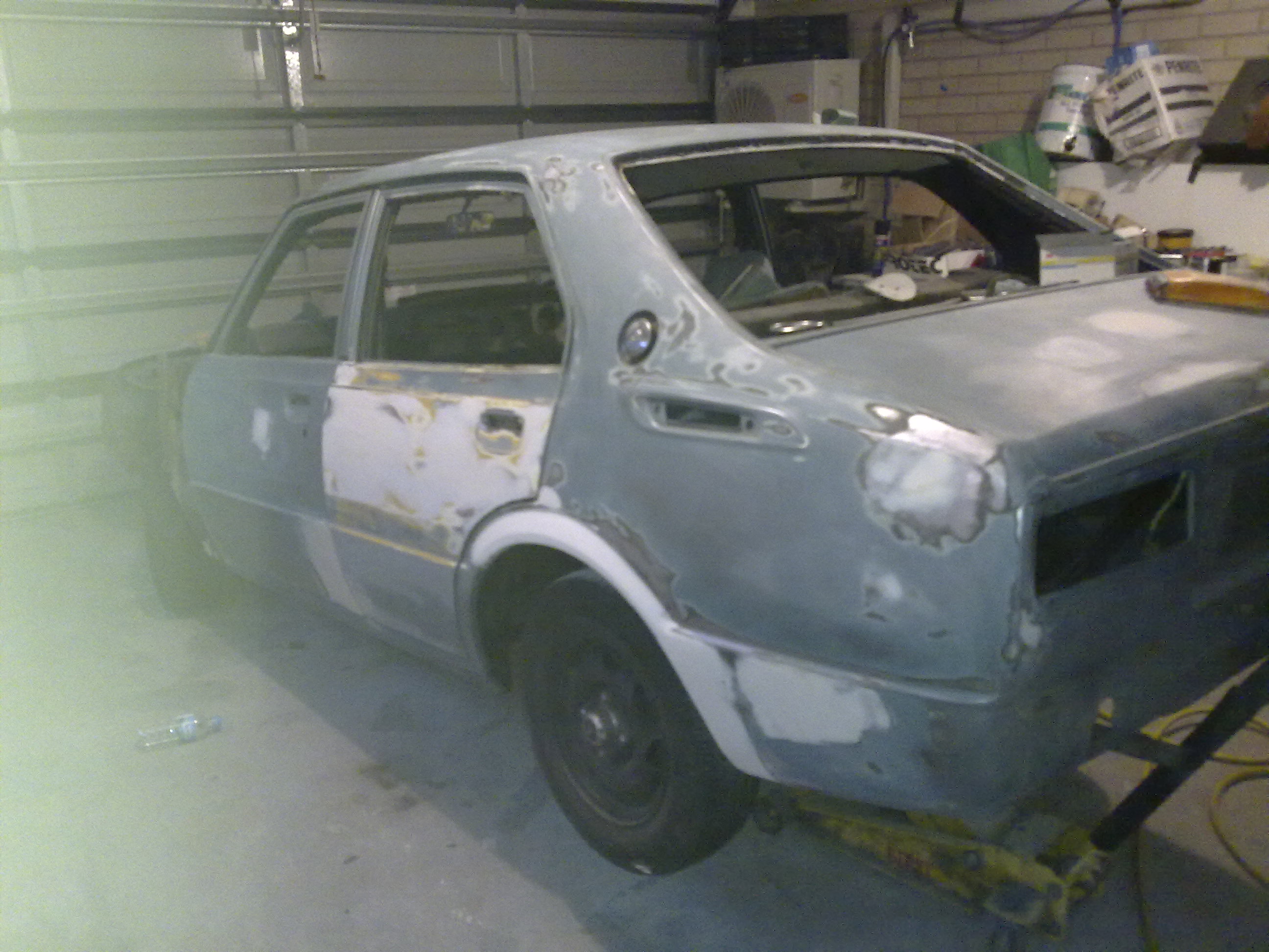

so after 3 days work most of the car is in 2pk primer just got the rusty gards and bonnet to go :lolcry: then it's almost time for paint next weekend

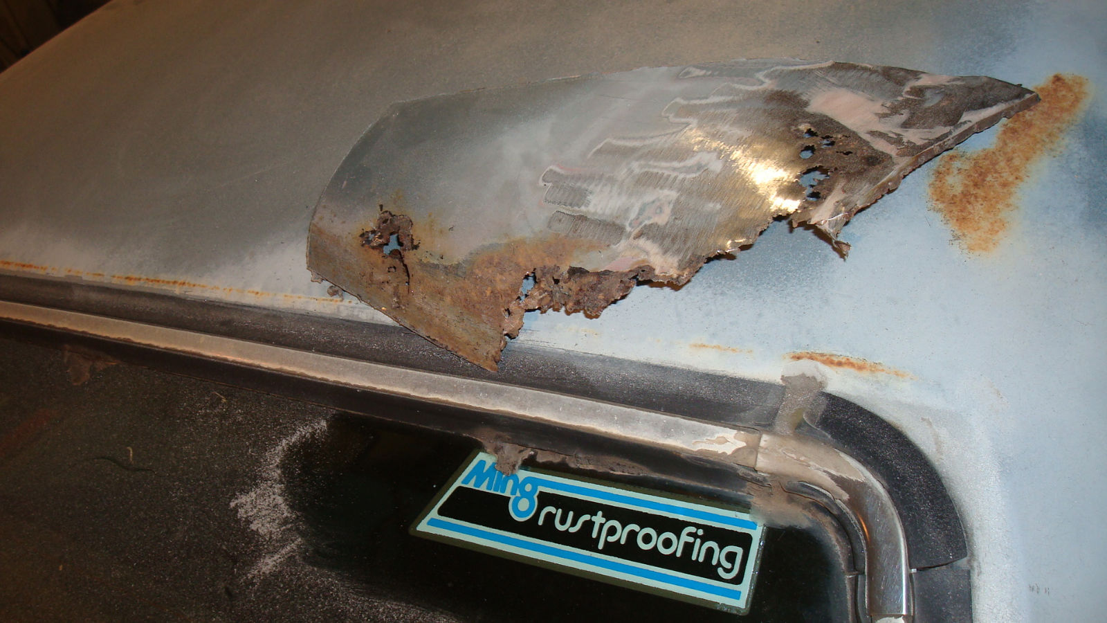

hahah that ming rustproofing sticker just tops it off.. good job on the repairs but !!

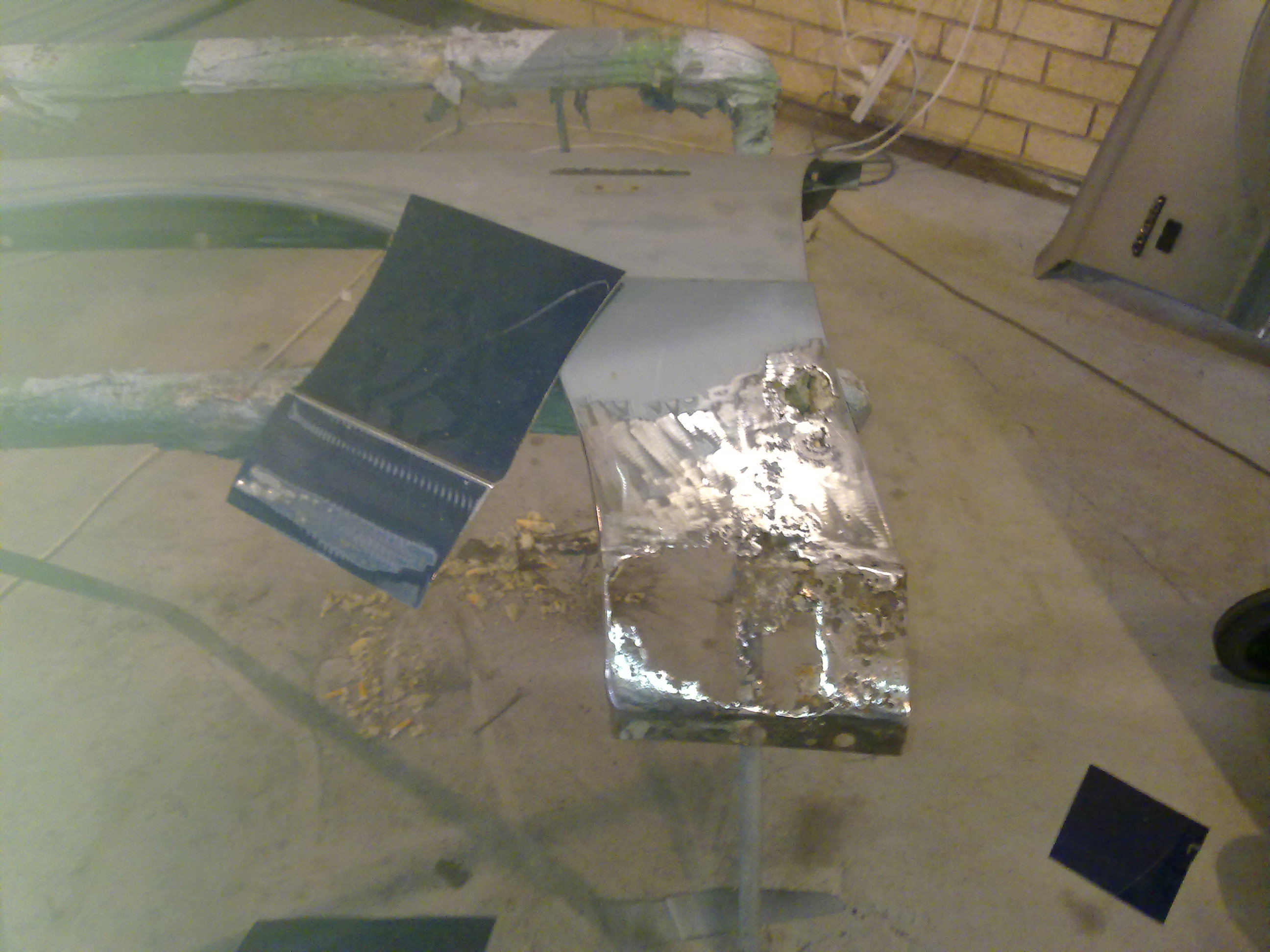

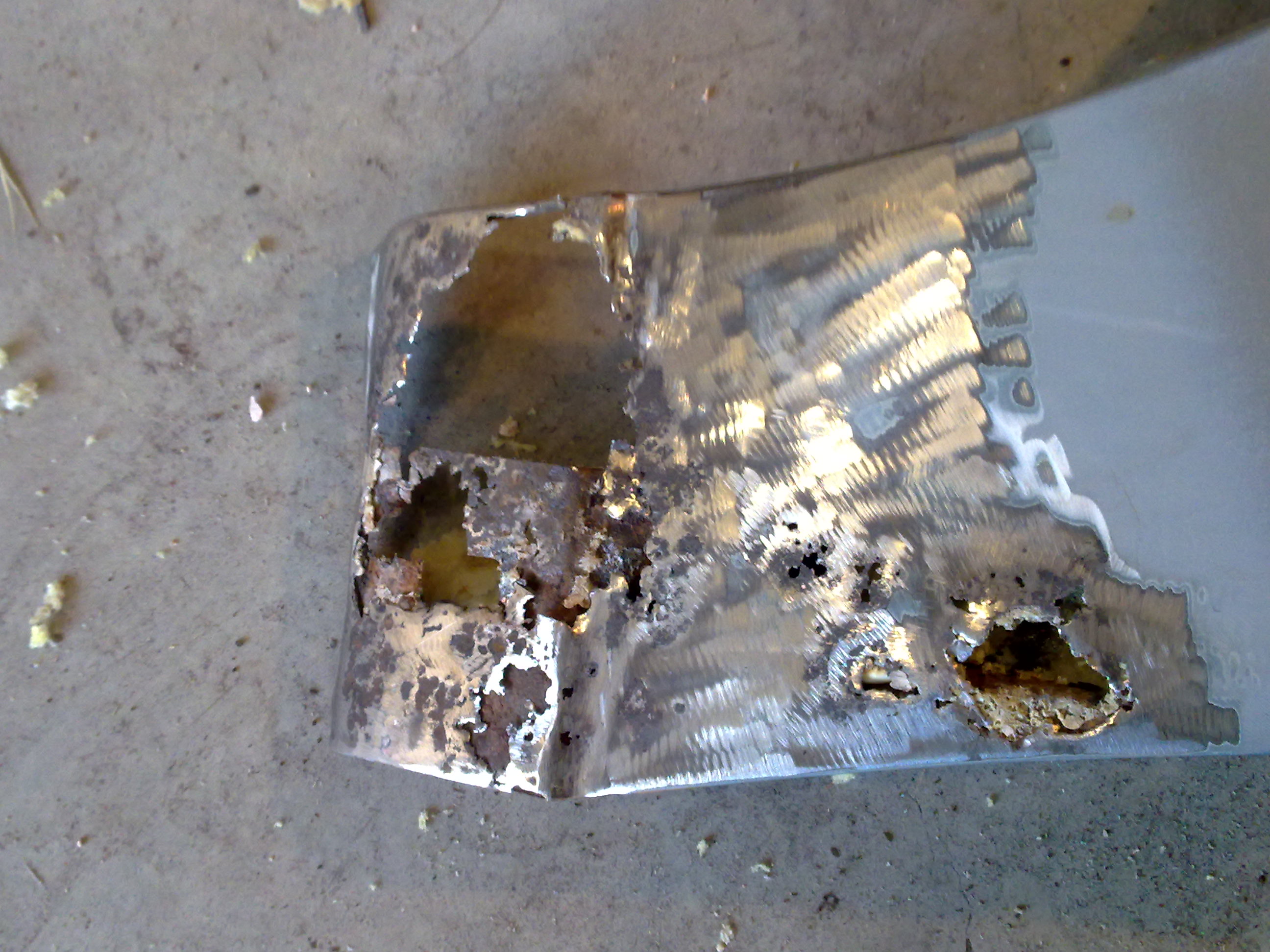

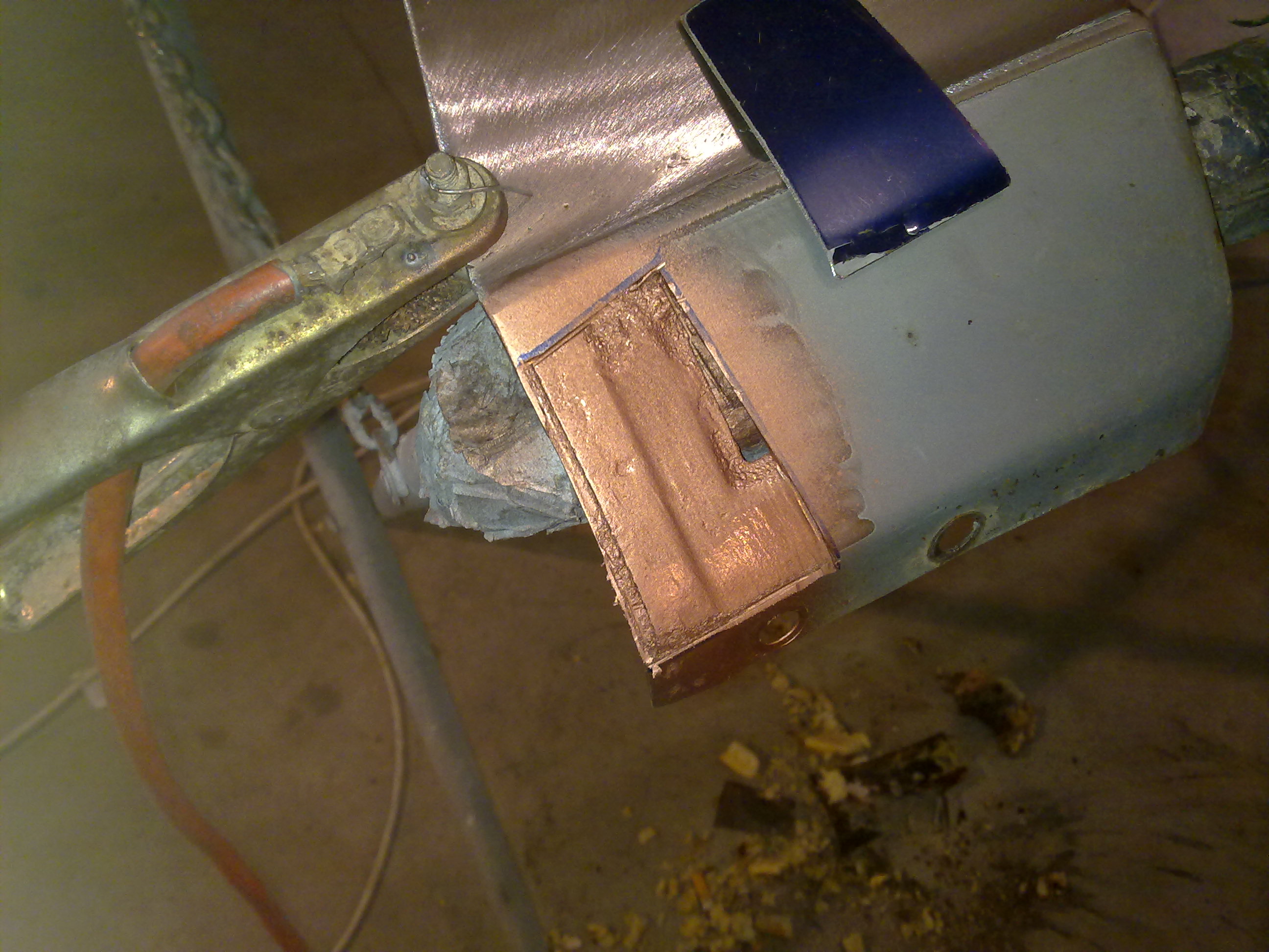

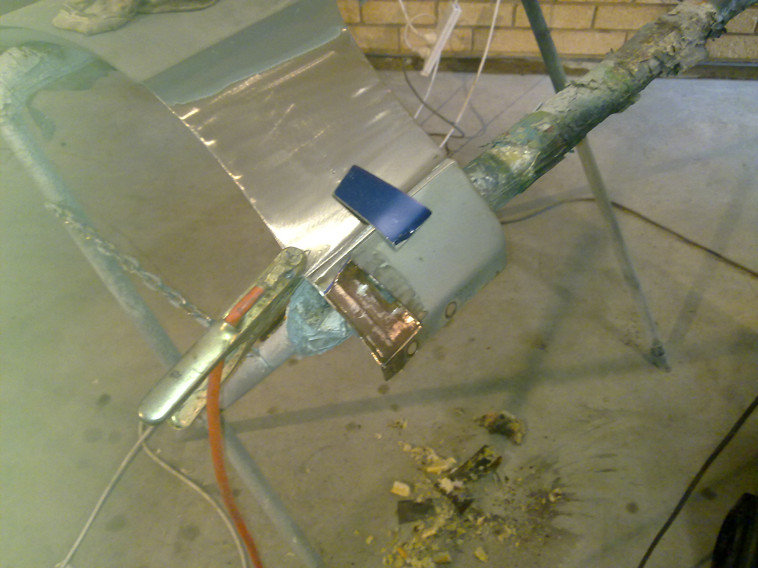

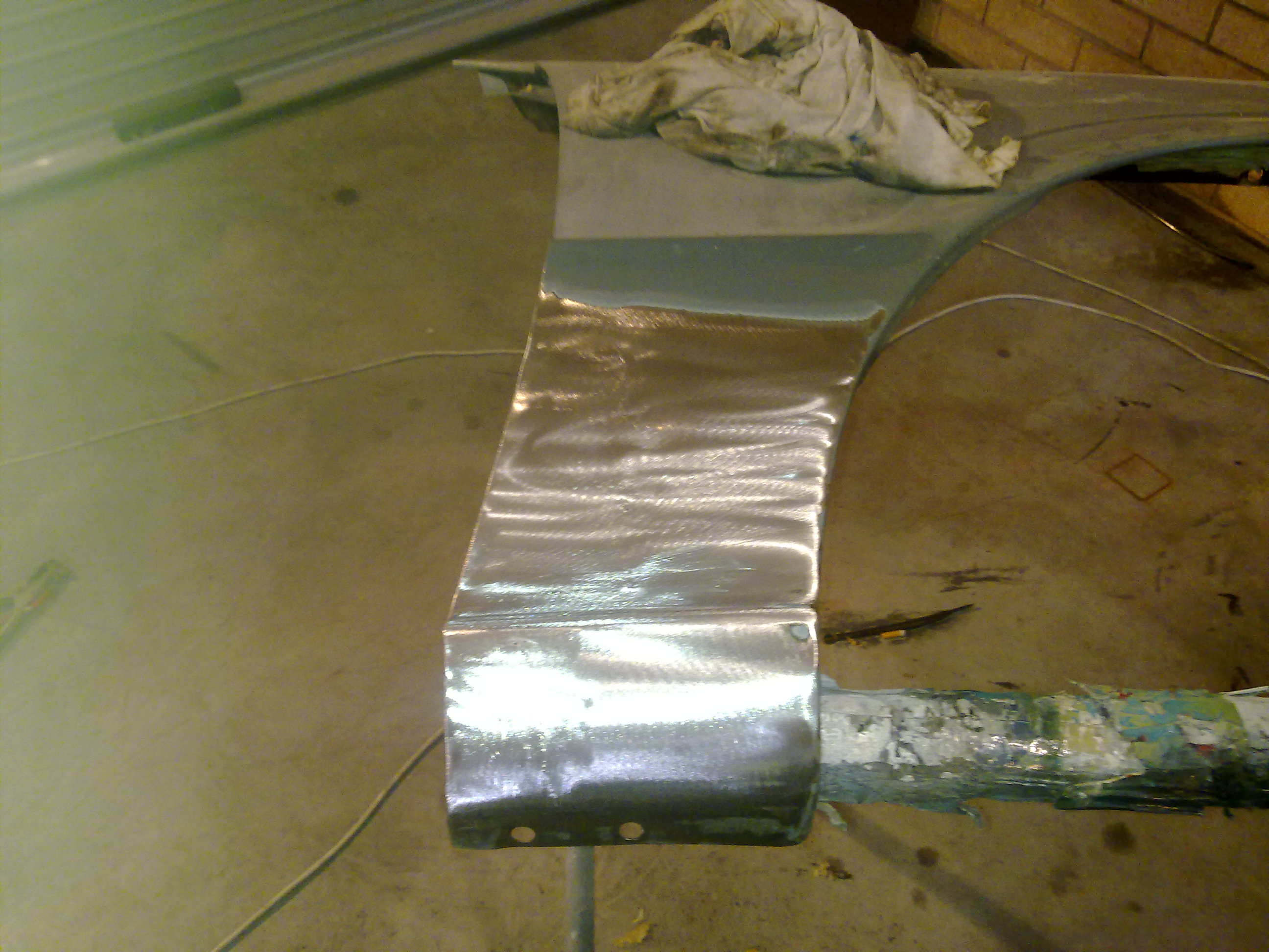

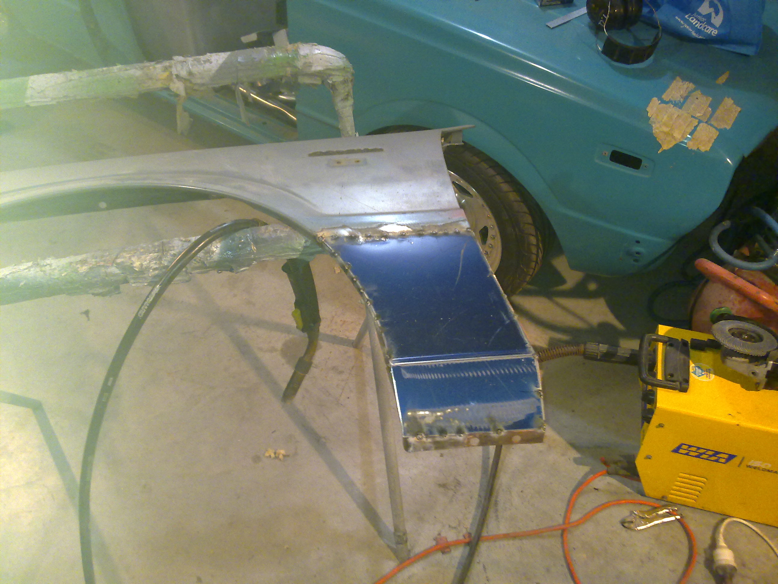

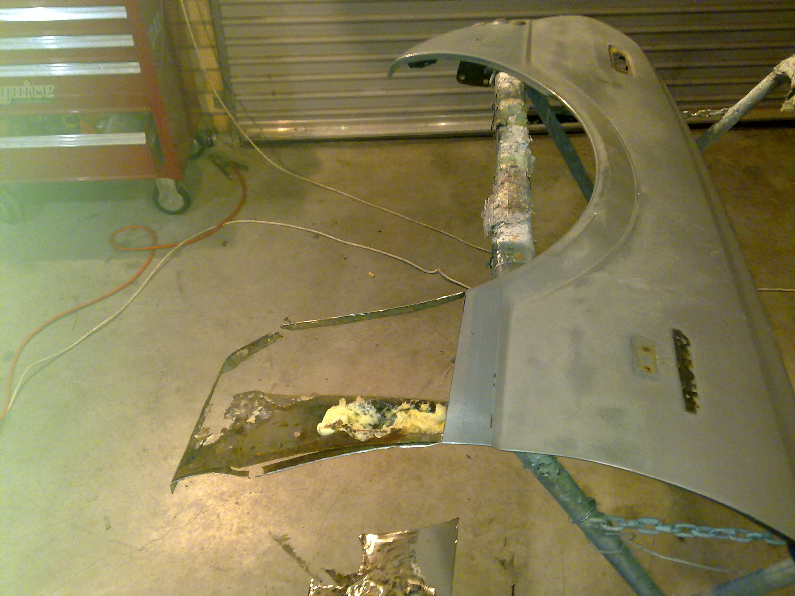

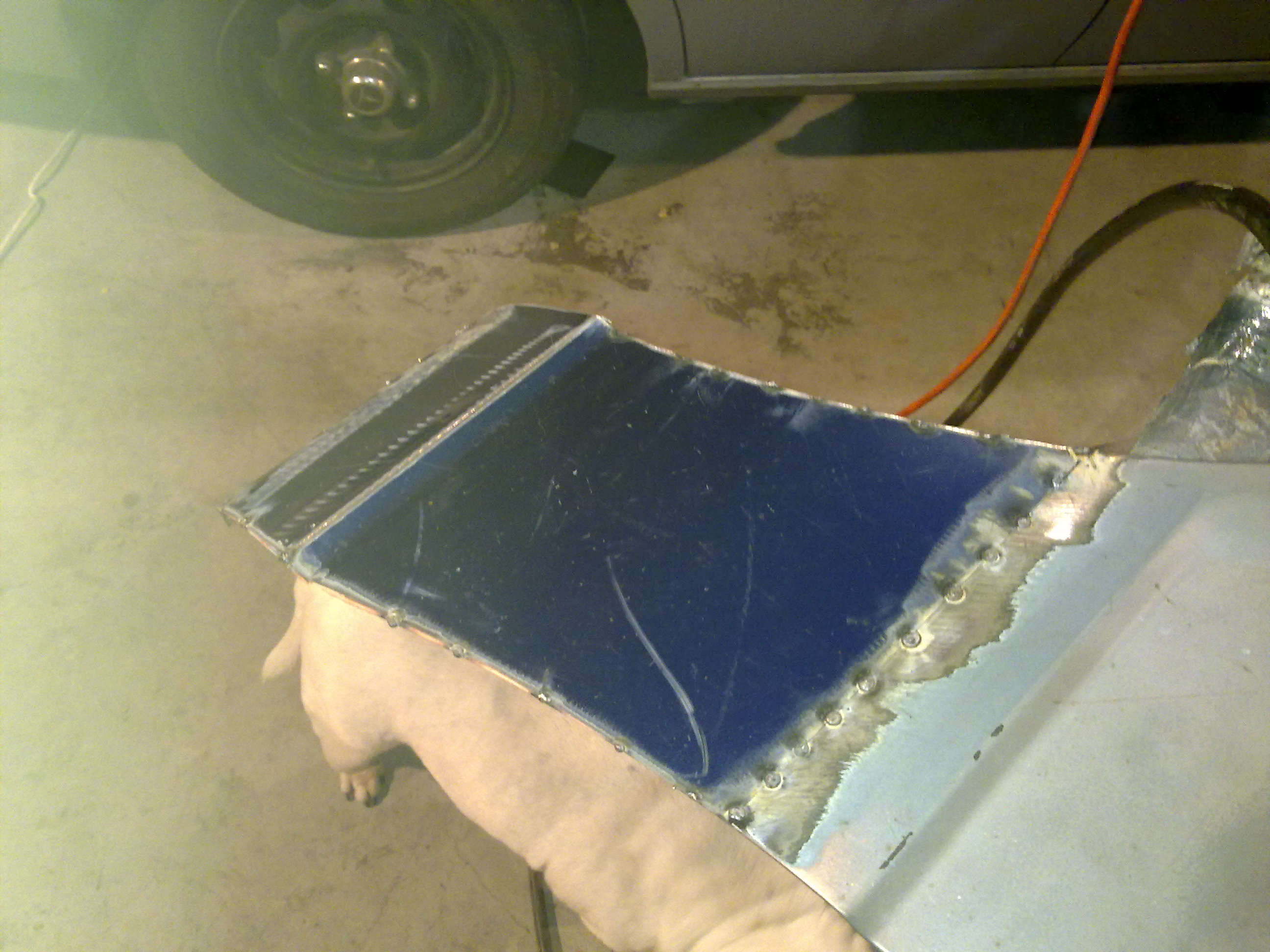

started to do the front guards tonight all i can say is OMFG
picture is worth a thousand words
Edited by 1JZKe55
yet again good work on the rust repairs.. i know how much of a pain they are (always get the rust repair jobs at work) but why didn't you's just use the blue guards and re paint them?
Thanks mate

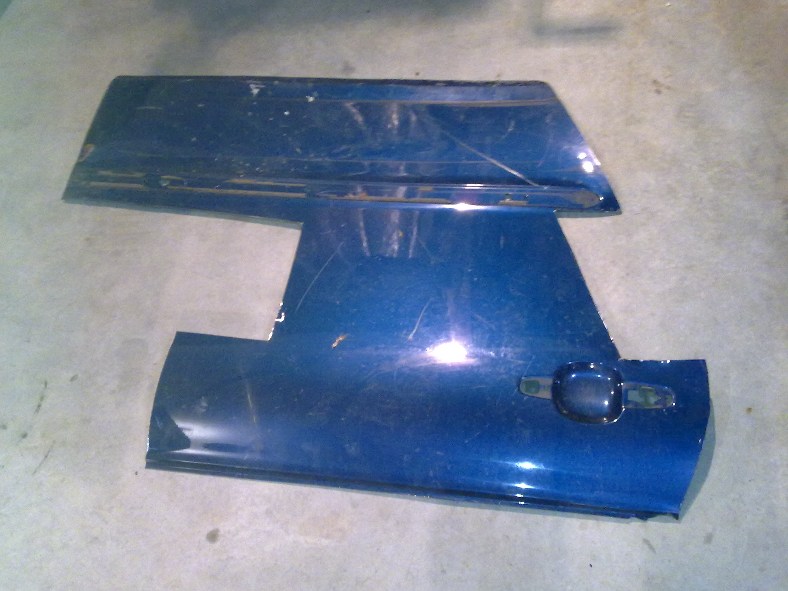

Na those guards are for the 1jz rolla plus Neil would kill me if i used them on Matt's rolla
After looking around for a couple weeks for some good ones it was just easier and quicker to fix them (about 2hours work for both guards with a few drink breaks :P )

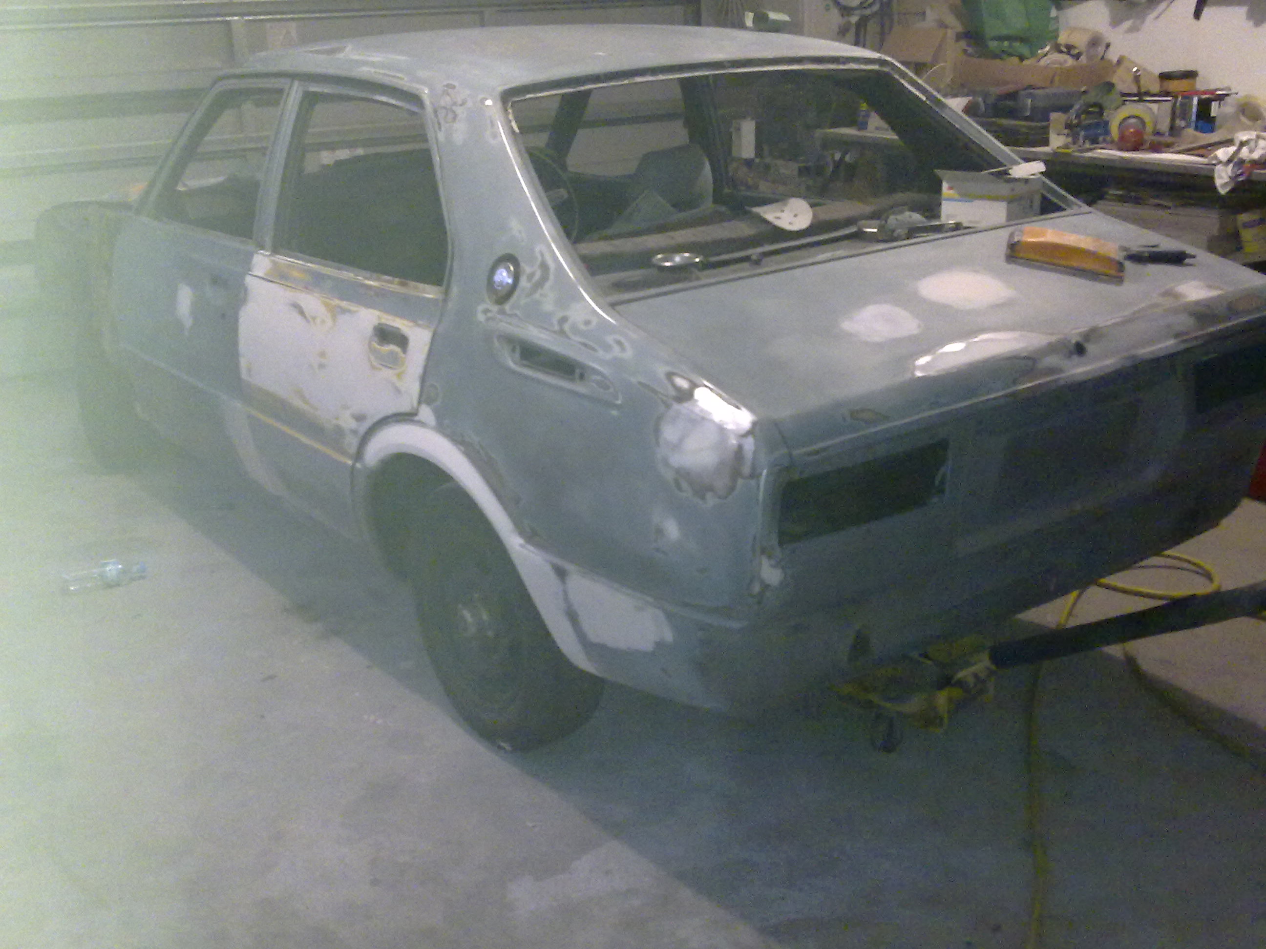

Well as it sits the body is rubbed down ready for paint just gotta get my painter into gear hopefully it will be painted this weekend it better i've got a HJ thats just been dropped off thats needs alot of work
