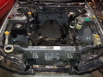

progress for the week was the sr20det and auto were removed from my s15 and once out i had removed the standard rubber mounts and replaced them with nolathane units as these are smaller, cleaner and sturdier than originals.

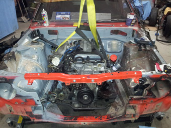

I only just positioned the motor in the bay of the ke about 30 minutes ago, and left it hanging until tomorrow, where il get it all centred up and in position for the mounts to be positioned to the bay cross member and then make the gearbox crossmember, this is my plan for the week and to be sure everything fits up nice and clears, ie steering etc, and measure up for a suitable radiator and figure out some wiring then remove and start preping bay for paint and refit.
will keep you's posted as i progress, here's some pics, enjoy.
after mock up today with all the parts i have to push the motor back 1.5 - 2 inch to clear everything and the huge auto box/pann is stoping me, so some trimming required.....
