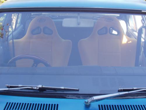

ok here is a pic from out side the car
they look so cool :) comfy seats are nice hey, i could sleep in rob's velo seat :)
you shouldn't really have harnesses without a cage. if you roll the car and the roof comes down on you, you can't move out the way and you compress your brain down into your spine and die. it has happened
a normal lap sash seatbelt is designed so the occupants can move their body into the center of the car, should the roof collapse down on them. just some food for thought, grisly death is a big price to pay for cool looking harnesses. they're also a defect without an engineering cert, and no good engineer should certify harnesses without proper rollover protection

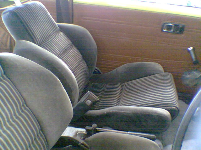

A lot of the bucket seats are stiff as all hell. Not the best option if its a daily driver like mine is...
These are the seats in mine, the last owner put them in, out of a 87 or somethin prelude (hey it may be Honda but these seats kick ass):
These have even got the adjuster so you can adjust the lower part of the seat in or out (for lower back comfort), and the upper part of the seat.
They aren't engineered unfortunately, on my to do list.
