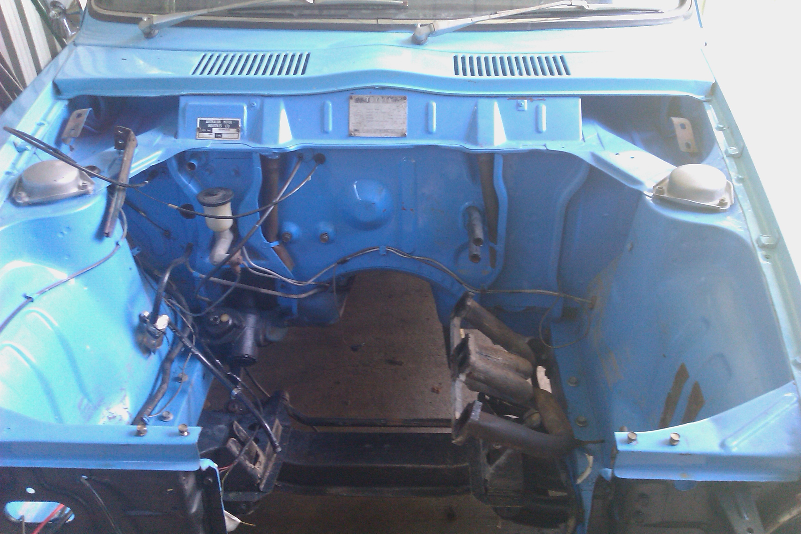

After the fitment of the engine I took to repainting the engine bay and interiour
set up my own little spray booth in my garage
paint came up not too bad pretty happy with it.
