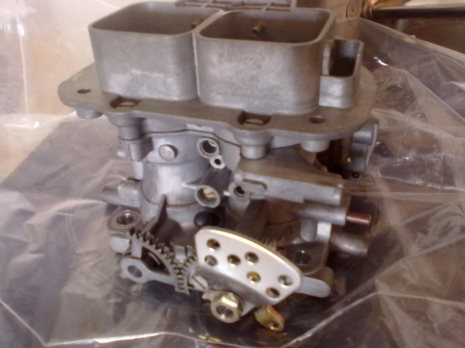

I have a 32/36 weber on my Pajero. SAeeing as some folk here like these carbies i'll ask here.It wont idle properly. Idles at 200 - 300rpm.
No vac leaks i can find.
Drives well, cruises well.
Dies when i add start ya bastard.
Runs better when i cover fuel bowl vents but still not 100%.
New kit put through, new needle and seat.
To get it to idle i have turn the mixture screw out nearly 10 turns and crack the primary butterfly which is very wrong. Idles shit aswell.
I'm not expecting a miracle answer but suggestions.
i found out what the 3 ports on the 32/36dgav do.
1st on the top LHS, is where the breather connects to
2nd on bottom lhs is the fuel return
3rd on RHS is the fuel in
It sounds like its running to lean. If you want i'd be happy to swap my recoed 38/38 synchronous for your 32/36 progressive. I think its just too big for my 5k as the weber book my dad has says its generically jetted to suite a 2.5L and the inner venturis are not interchangable. I bought it through recarb in september.
We've fiddled with the jet sizes and it still doesn't like to play ball.

Does it have the same bolt pattern as a 32/36 ? and whats it jetted for ?
If i do swap this one will come with jets to suit a 4ac so it should run ok on a 5k.
sounds like it's rediculously rich to me.
Fuel pressure just popped in my head, I'm running the 32/36 straight off the mechanical fuel pump. The Paj book says they can run up to 13psi so i might drop a regulator in tomorrow arvo and wind it down to 3 or 4 psi.

whats the fuel bowl level like? you running a return line off the carby?
if it was over pressurizing wouldnt it all the excess fuel be bypassed into the return?
if it was over pressurizing wouldn't it all the excess fuel be bypassed into the return?
Running a return, Dunno but its worth a try otherwise I'm going to burn it.
It's the same as a 32/36 but it has no choke, synchonised throttles and it came jetted to suit a 2.5 litre. All I've changed is the main jets from 145 to 125. But I can change them back.
Hmmm I'll have a tinker tomorrow and see what happens. Pm me your number and I'll give you a ring tomorrow Gav.

When i put the 4ac suitable jets back in and try its the same. Doesn't idle but drives OK. Going to try the reg tomorrow. Trev tune it for me!
Dunno what pressure mine is getting as my fuel regulator and return is before the carb so I am using a single fuel line on the carby, also check the timing on it when you are playing around with it next.
