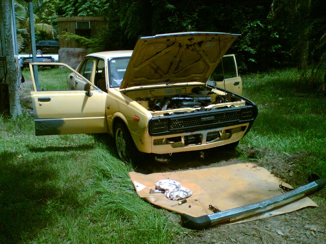

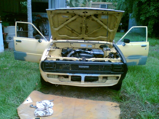

I've done some minor work on Lola. I was around at my in-laws place (where I store the car) to clean the diff out ready for a mate to come around and weld it for me (a welder by trade). After I'd cleaned the diff out, I had nothing better to do than wait around, so I decided to remove the front bumper. Now some of you may say that this will make the car look crap, but I don't mind the look, plus it means less weight at the very end of the car, less weight overall, and more airflow to the engine and to the new radiator when I get it. So it's all good.
After doing this, I was going to remove the rear bumper, but didn't as I realised it had bolts of some kind holding it in place that will need angle-grinding off. So instead I stripped some more weight from the interior by taking out the glovebox, some vent piping, and various other lightweight stuff. This won't remove much weight, but it will make it much easier to work under the dash should I ever have to.
Here's a couple of pics of Lola minus front bumper. She will be painted up one day.
Incidentally, if anyone wants a KE55 front bumper with no dents, only some minor surface corrosion on the top, I'd be happy to sell.
Edited by ancullen
