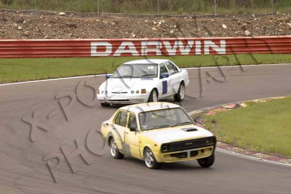

Yeah. It will make it worthwhile if I can do a low 1:30 at Hidden Valley in my first outing in the TA22. Lola has achieved a 1:35, and since then I have learned noticeably better racing lines, plus the TA22 will have semi-slicks and better suspension.

Today it has ended. I took Lola to Sims Metal today. :jamie:
I still have her engine, bonnet, build plate, wheels and various other bits. However, the most important bits are likely to be sold. I'm thinking of using the bonnet and a spare grill I have to make a tribute to her in my house. I think it would look kinda cool mounted on my wall.
Due to my financial situation and a lack of space, time, and interest, I'm selling off my car stuff, and just keeping the GT-Four as my only play thing for the time being. If I get a bit of spare money together, I'm looking at buying a motorbike for a bit of adventure travelling. When I get my shit sorted again, especially financially, I will look into buying another play thing, but it would probably be something like a Clubman, and preferably with a Honda F20C rather than a 4A-GE.
This is a bit of a sad day for me, as Lola was my first, and last Corolla. She is the third KE55 I've taken to Sims (I feel a bit evil for this). I have some very fond memories of her and the fun I had, but have been forced to move on. If we could all have a moment's silence for the one we have lost, it would be appreciated.
Lola the Corolla - 1981-2009
