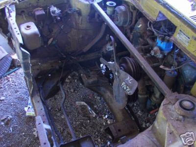

love ke70:
um. okay maybe i should change my name to krusty...i'm seriously surprised to hear that about the weight....
Increasing inertia will increase weight, reducing responsiveness...i plan to combat this by increasing the track, increasing the mechanical grip and maximising the front/rear weight balance as much as possible...i mean...you never know, i might end up with a car that is completely different to what i was expecting and have spent huge amounts of time and money creating my very own lemon...i'm just going to have to try and keep my head on and be realistic with what i'm trying to achieve...
btw what the hell kind of (engine?) is that...
