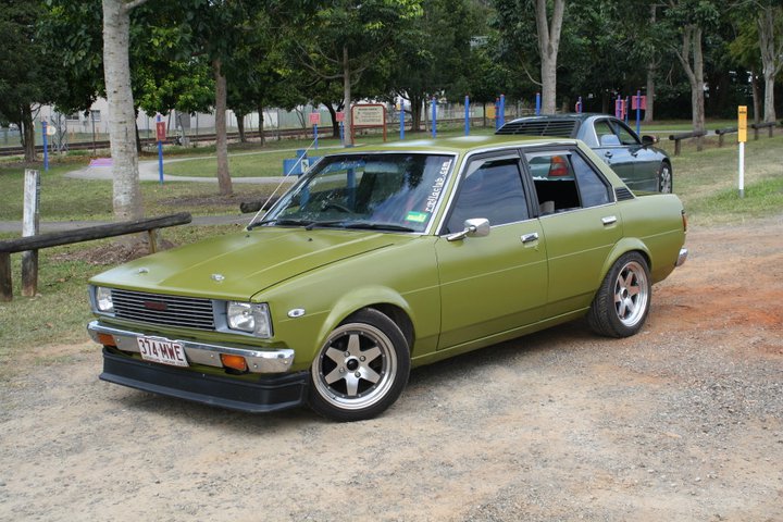

For all of you with a keen eye this is Spencers old girl, very similar to what i want my car to look like.
