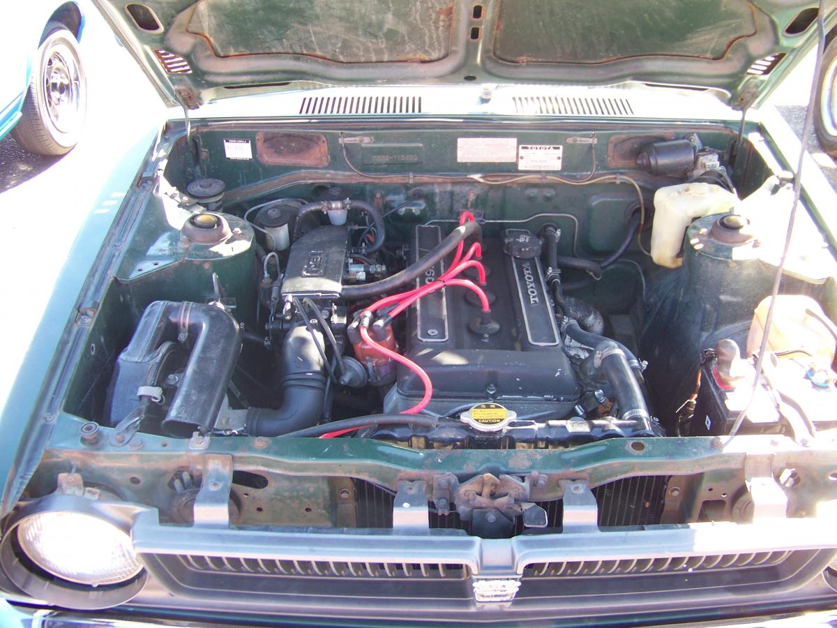

post-1432-0-82790600-1335526737_thumb.jpg post-1432-0-16119600-1335526746_thumb.jpg

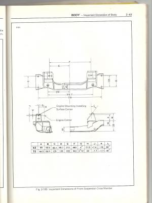

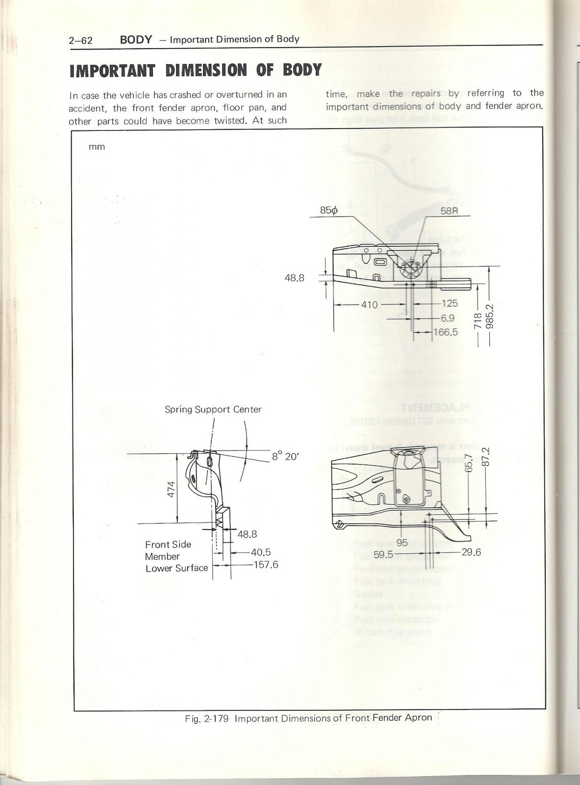

I'm also looking in to this conversion. as ive researched ta22 engine mounts and the engine should sit on the ke35 crossmember, but sits further back and to the right.
http://reocities.com/colosseum/4883/2tswap.html
ive got a 3t and i got a t18 crossmember, I'm trying to get my hands on a ke30 crossmember and make some measurements. ill let you know what i find out, if something you find works let me know
