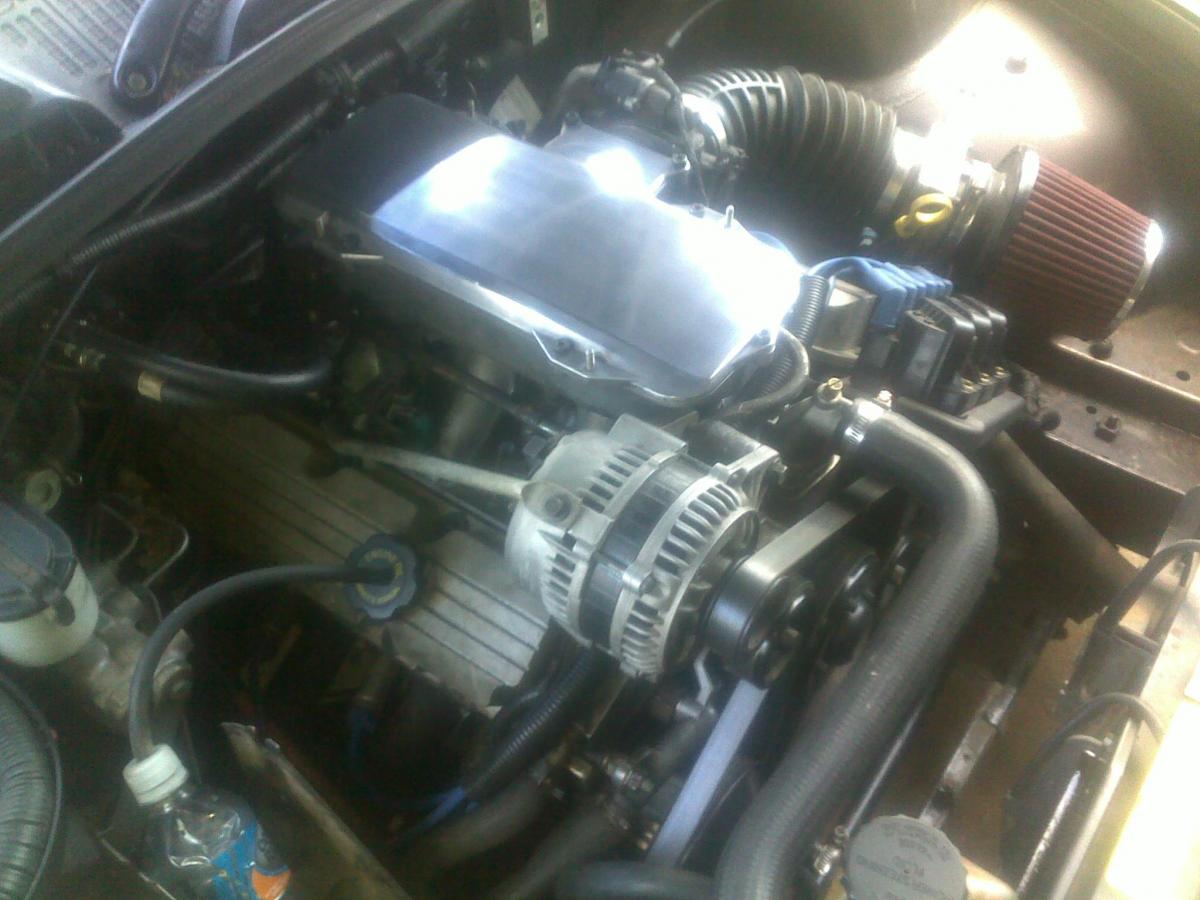

motor back together
polished

Car looks the goods!
For that intake though, would it be worthwhile extending the pipe to have the pod a bit further away? Perhaps tucking it closer to the headlight surround, but slightly lower, would draw some more air?
Either way, the vids sound mad and i'm sure it's an absolute hoot to drive.

hey mate, cheers, yeah the saloon cars run 1 particular one, so i'm just leaving it for now, might put the standard cold air intake back on for some more air though :y:
