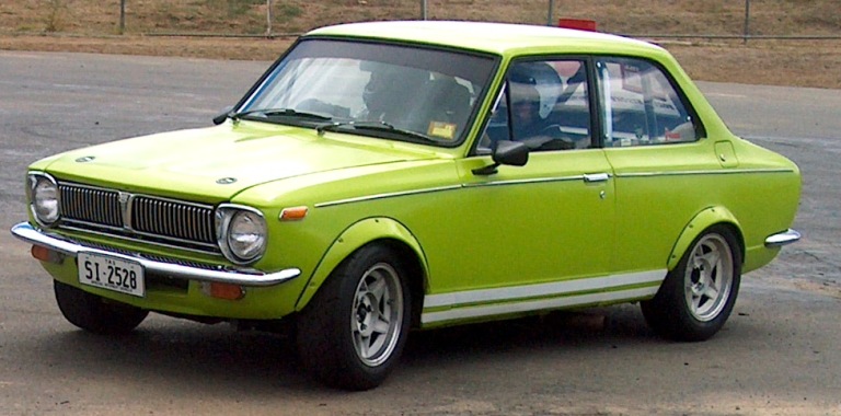

got some pics of you dads old blue ke10 in its present state fayt
we went out to baskervile with the present owner of the car a couple of weekends ago and the thing goes very hard for a 3k 4 speed
Edited by jamesrolla
  • Replies 77
yeah it don't look too bad
the outside looks alright, but I hate the "interior", somewhere down the track decided to make it into a full "race car" and they took it all out, but the thing is, it doesnt do any quicker times than what it did 30 years ago when it still had all its interior :locked:
he has had it down to 1.12 i think and the only thing that the interior is missing is a back seat and some carpet but why would you have full interior in a race car any way. it would probably do better times if it had the quaif lsd that it use to cause is all its got now is a welded one.
i love the flares on it and the 14" wheels.
it sounds so nice coming down the straight at baskerville.
:) yeah I know but why make it into a "race car" and pull out some of the interior when you had a perfectly good fully registered ke10 that did 1:06 and all its interior :locked:
