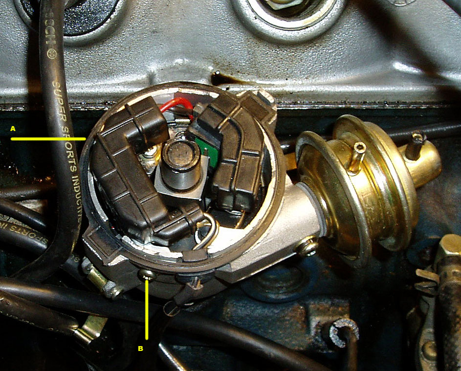

altezzaclub Posted September 5, 2012 Report Share Posted September 5, 2012 Looks like this- Quote Link to comment Share on other sites More sharing options...
