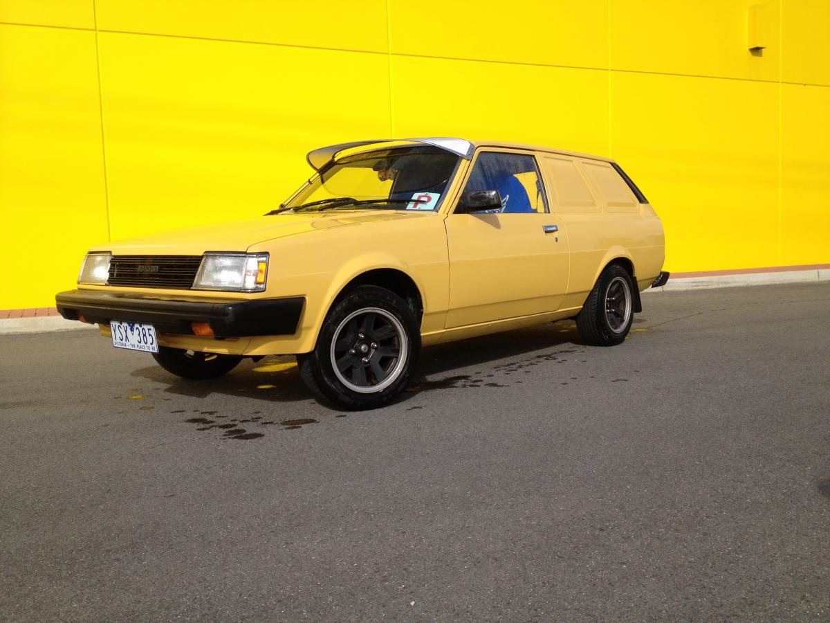

And a picture of the van, why? because Ksev. :)

Your looks to be in nice condition.
