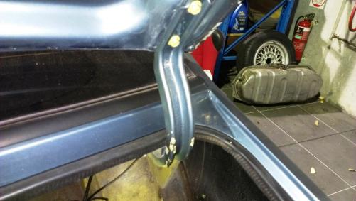

In the meantime, we've started on the Chassis side of things... Building a race car - even on a tight budget - is not a 'cheap exercise. SO at the moment, we're trying to gain speed the slowest but cheapest way possible - remove weight. So the attachments are just a small idea of what we're up to. All the interior is gone, and the seam welding should start this weekend also as all the sound deadening is gone. Slowly but surely, we're getting there!
