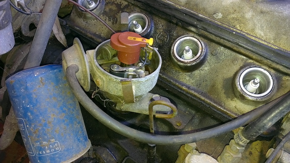

I recently bought a KE11 and I decided to treat it to new plugs, leads, distributor cap, rotor and points.

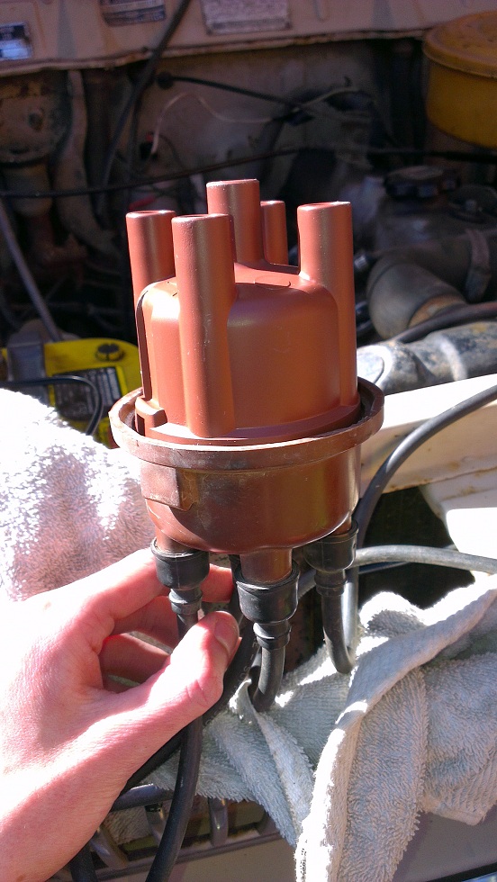

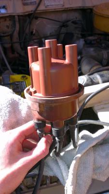

The problem i encountered was the distributor cap is completely wrong. It said on the packet that it suits "Corolla 1967-1975 - all models" but as you can see from my photo, the one from my car is much larger than the one i bought.
What have I done wrong?
If the cap is wrong, then I assume the rotor and points will also be wrong... is that right?
The part number for the cap that I bought is Bosch GD516
Thanks in advance,
Simon.

Also note that the rotor fitted to the dizzy in the photo is the incorrect part (the Nippon Denso one)... so try to ignore that. I put it on before i realised i had the wrong parts.

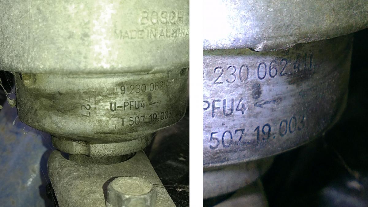

I found some identifying numbers on the distributor....
9 230 062 411
U-PFU4
T 507 19.003

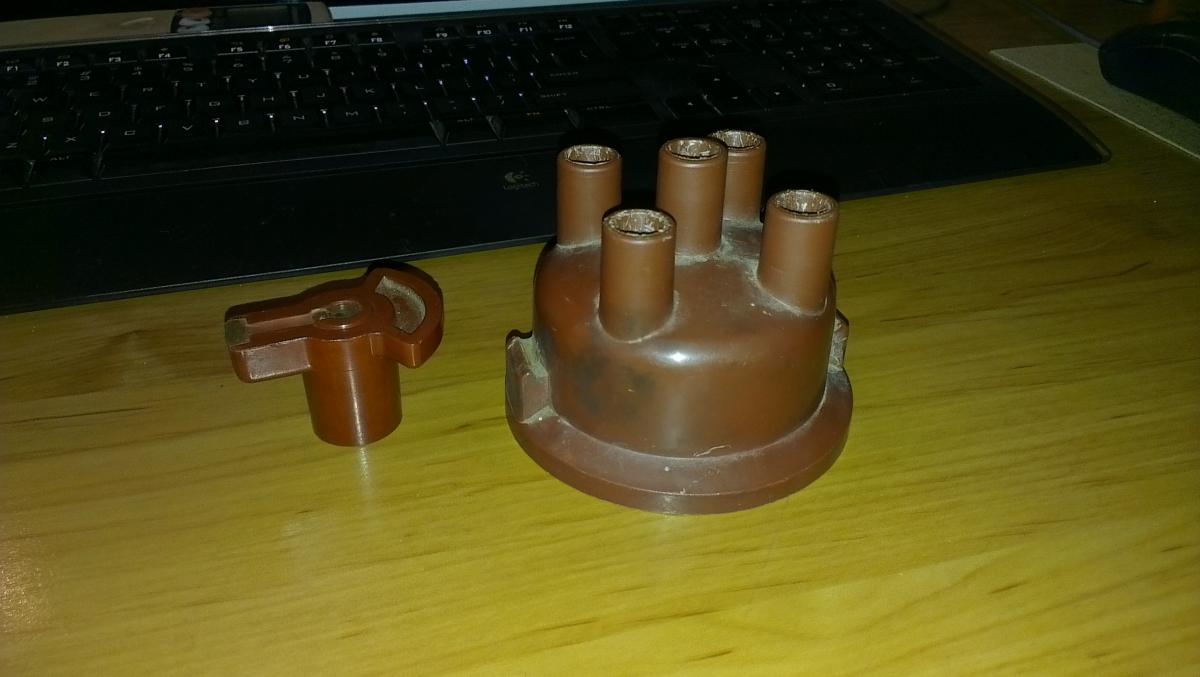

From my research I'm thinking it's probably a KE55 or KE70 distributor. For some reason i can't find any info on the net, despite having part numbers and everything. The closest i got was this document ... http://dualfuel.net.... ADOCATALOG.pdf
I also took a good photo of the cap and rotor.

I thought i'd mention that i discovered the distributor is in fact a KE30 distributor.
I phoned Bosch and quoted the "9 230 062 411" number and KE30 is what it came up as.... I therefore bought a GB708 cap, GB73 rotor and GB543 points and they fit fine despite the rotor looking quite different and the cap being black instead of red.
