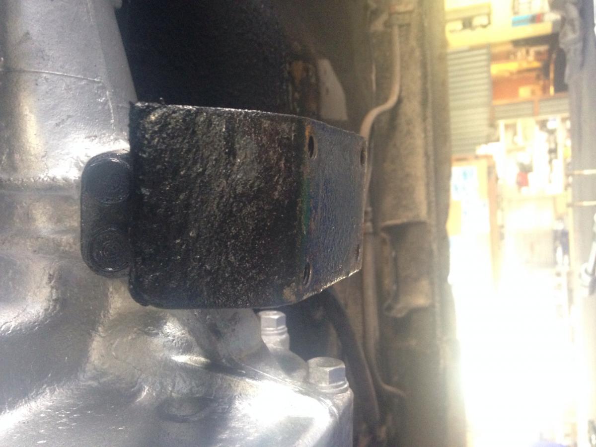

EDIT: no idea why the last two pics are sideways, stoopid iPhones.

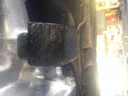

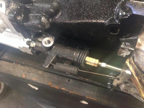

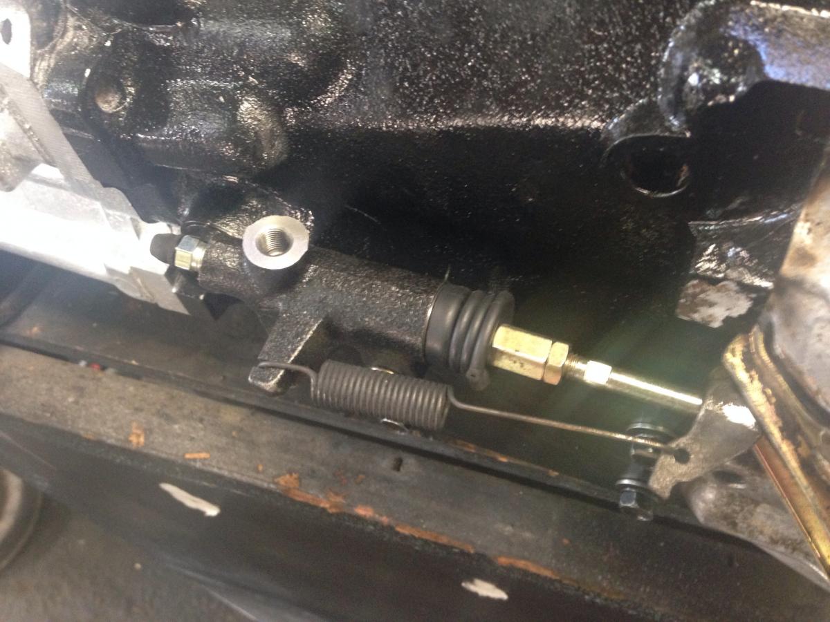

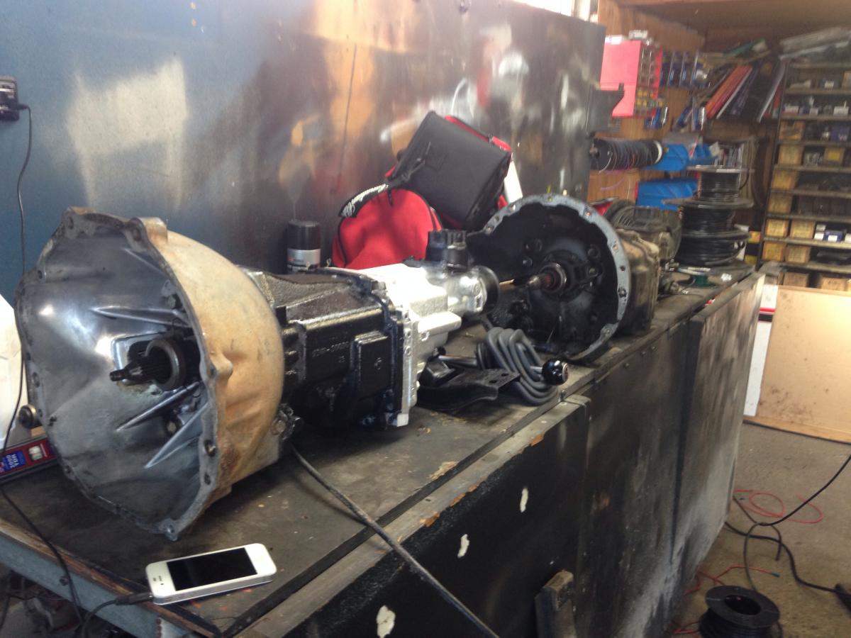

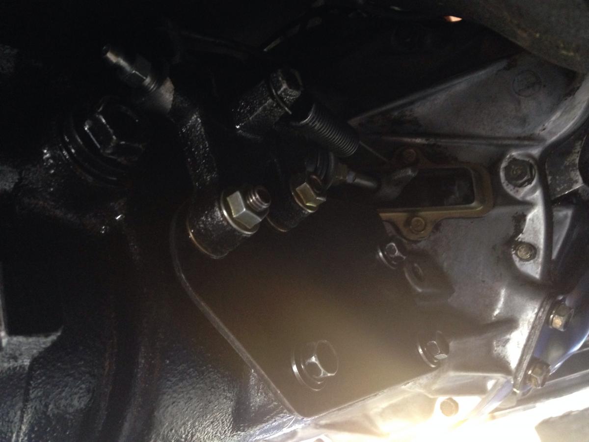

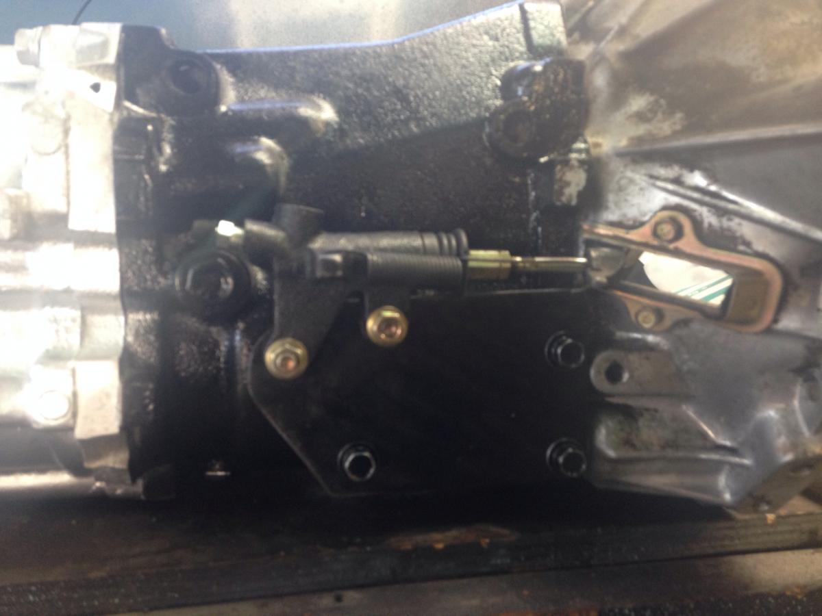

... So! Started the conversion yesterday. Was looking pretty simple. The bracket turned out great, I did mine pretty different to yours though Glenn. It has three bolts holding it in. We had to play around with it a little to get the slave cylinder rod to not sit on an angle (pointing outwards from the box). But it's all square and solid as.

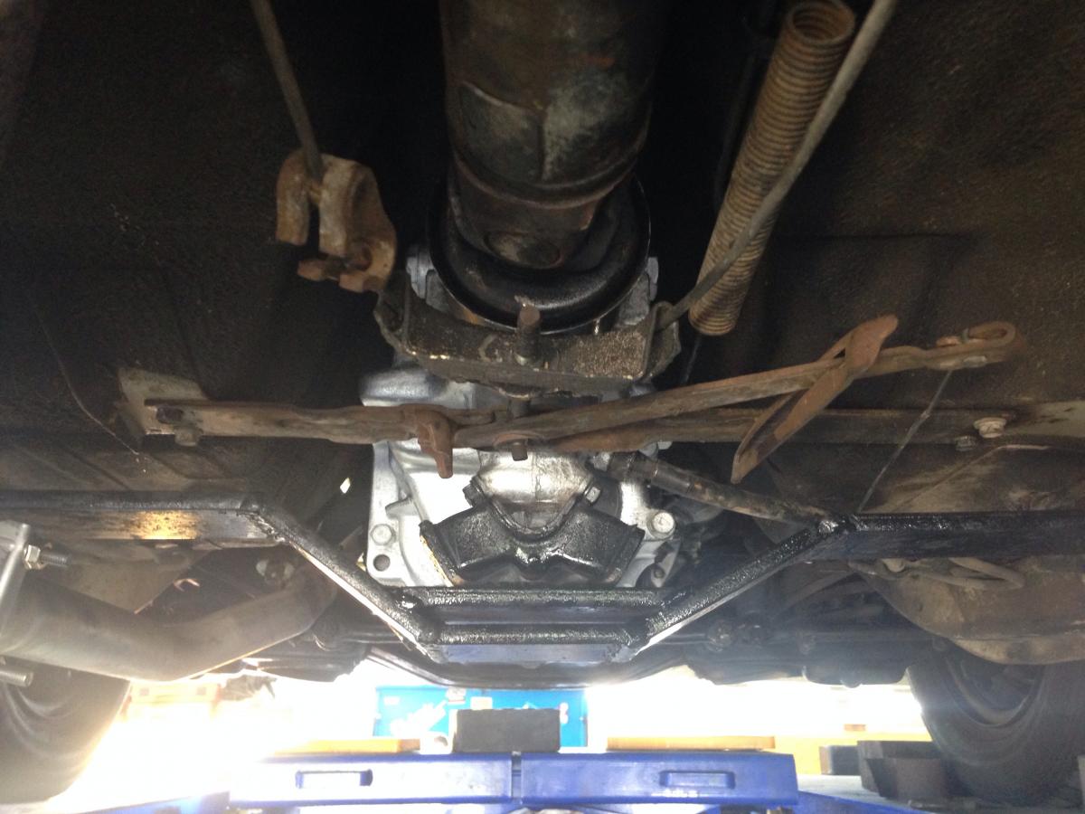

I bought a clutch for the W50 - which was wrong, turns out I needed to use a W40 clutch. So I got a fresh one (luckily I found one locally). Went to put the box in and the gearbox mount is further back on the W50 than it was on the W40, and doesn't line up at all with the cross member mounts. So I've got some steel and will be making up a whole new crossmember on Monday, then she'll be sweet! Here's some crap progress pics, and a pic of how far out the mounts were.
I have heaps more pics, just picked these to show the bracket and how the box didn't line up haha. Will put up picks of the crossmember on Monday.

looks good mate, i wasn't game to drill a hole further back as i didn't want to drill through to the inside haha, plate looks nice, i'll do mine a bit nicer when i get another box, made it a bit crap as i wasn't sure it would all work haha, thought the x member might be like that, my car has the same holes, but then more holes further back so was easy as, should be sweet though

Yeah I was a little annoyed about the crossmember not lining up but happy that it'll all fit and work out soon!

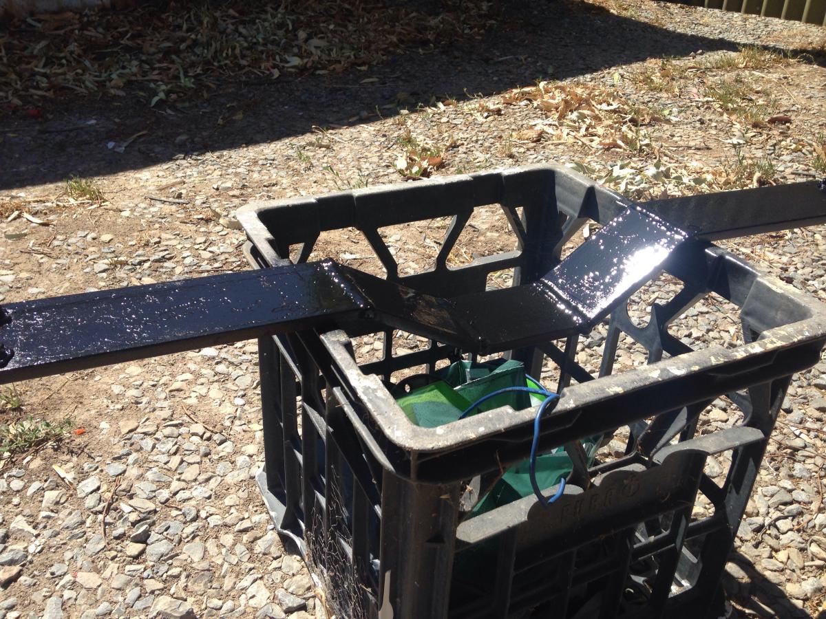

Well this beast is now rocking a 5 speed. Pretty happy with the outcome, sits on 3000rpm doing 100kph, rather than the 4000 it used to sit on. A lot quieter to cruise in and can get her over 80mph (130kph) pretty easy. Crap pictures again but here's the crossmember we made up, the steel is 10mm thick so it's definitely not going anywhere haha
awesome mate, looks sweet!
