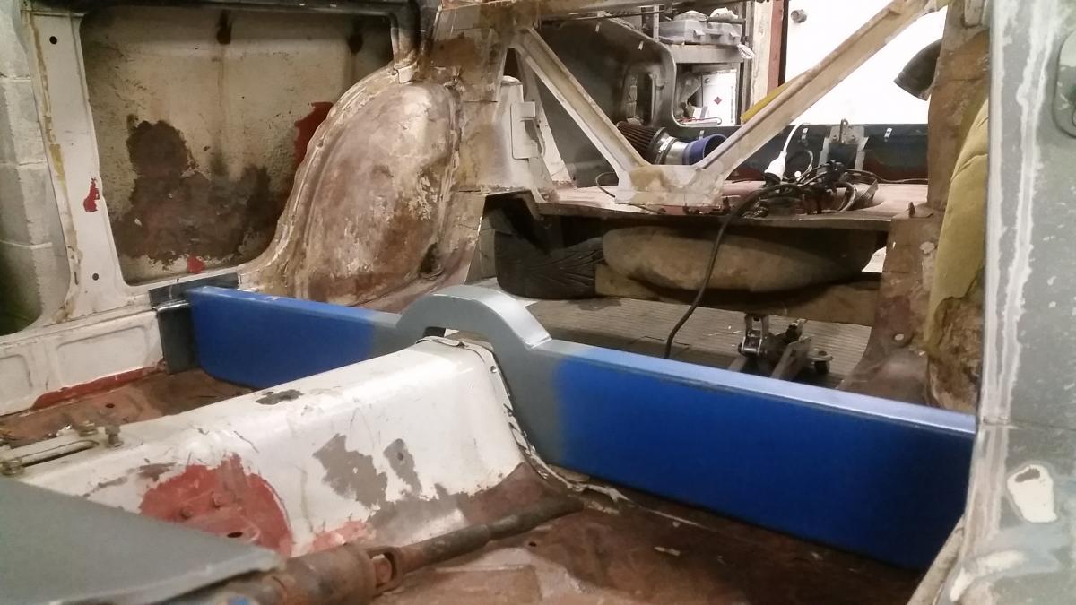

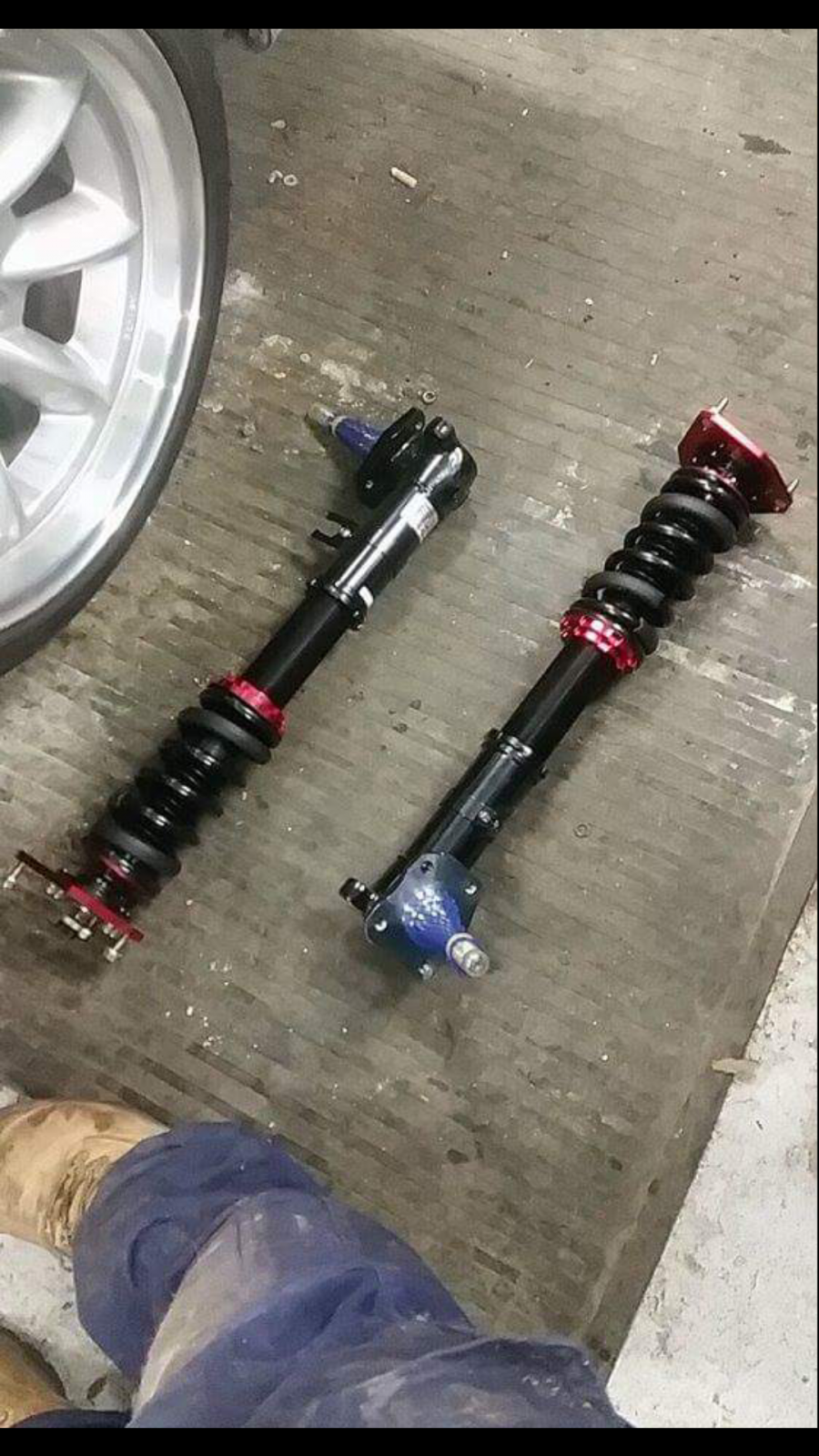

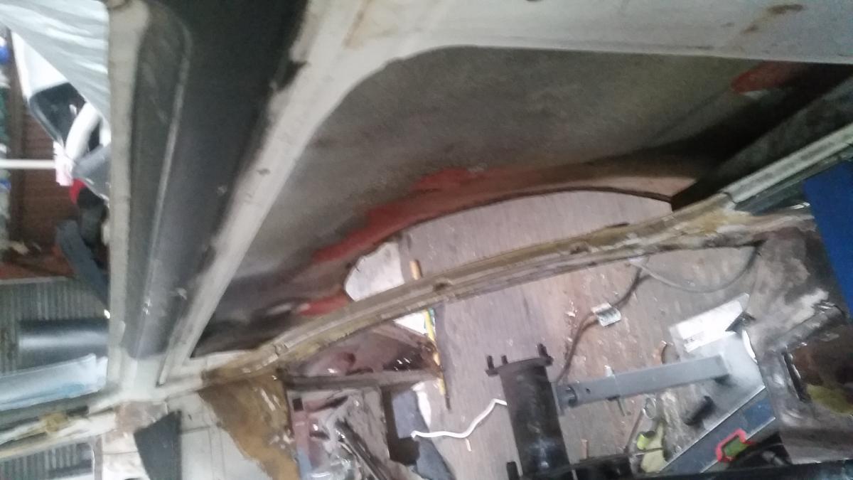

Rotary is gone. Have a 4agze sitting between the rails now. Plans are to freshen up the bottom end, cams and a turbo. Floor is cut out from the seat back to the boot ready to start on the 4 link and make bigger for diff/tailshaft clearance. Have bc ae86 coilovers for front end, ke70 rack and steering shaft, ke20 crossmember and some other bits to make it work. Still need ae86 hubs and steering arms to finish off.

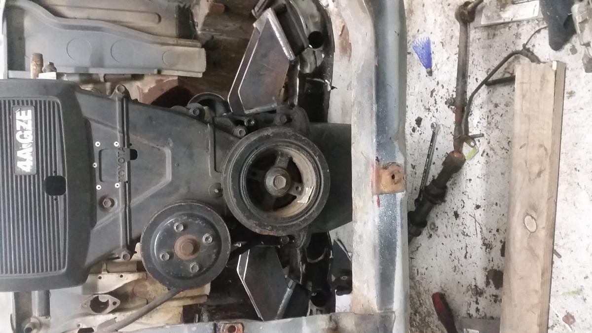

Engine is mounted! Ill sort out a gearbox mount next weekend. Using a dellow 4age- w5* bellhousing and w58 gearbox. Should handle the power fine in something so light

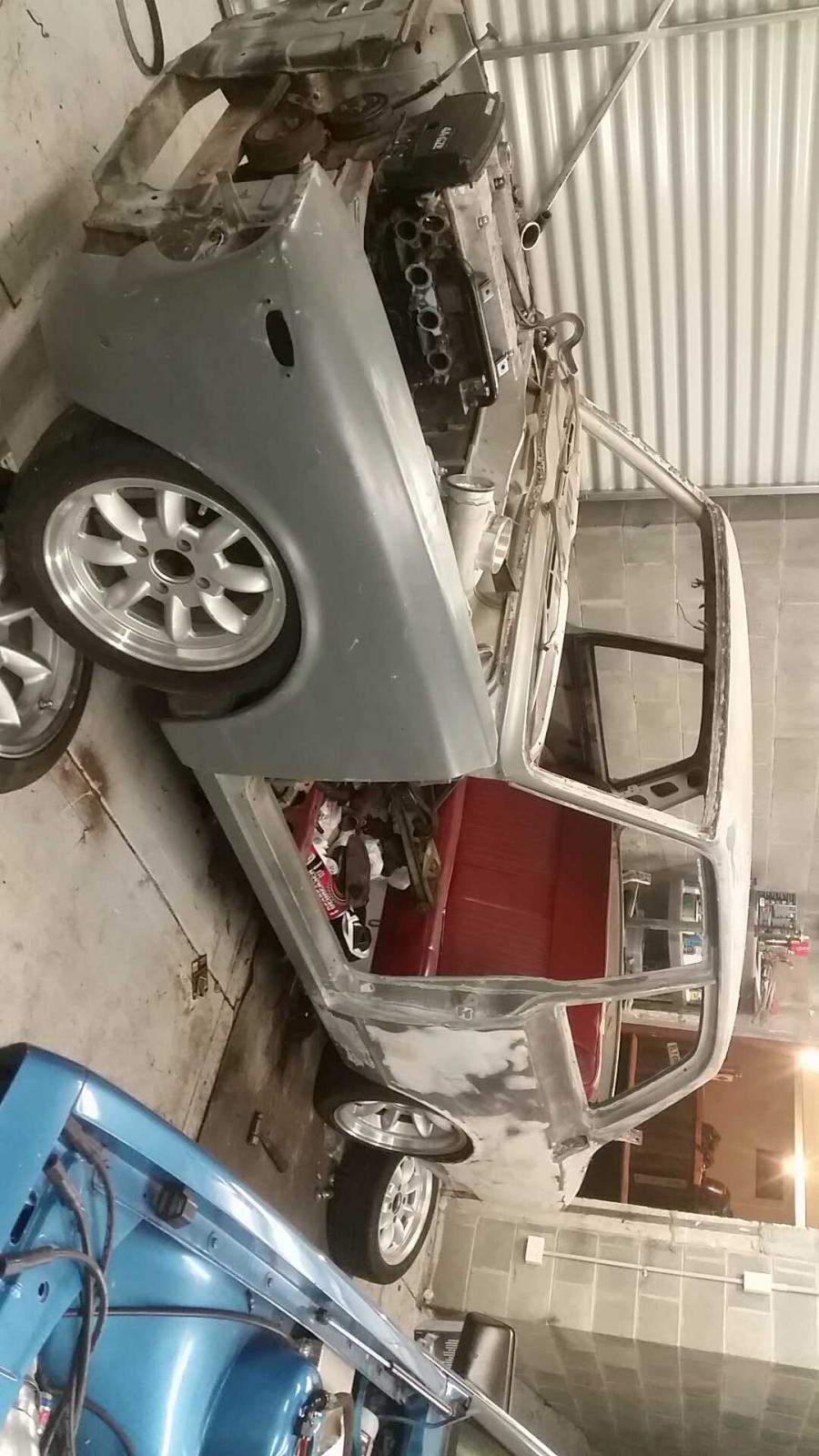

More changes.. hilux diff is being changed to a borgwarner 78 (commodore/r31 diff). Smaller, lighter and still strong enough to cope with the power from the little 4agte and a much better parkbrake. Also picking up wider rear wheels next weekend, 15x10 superlites.

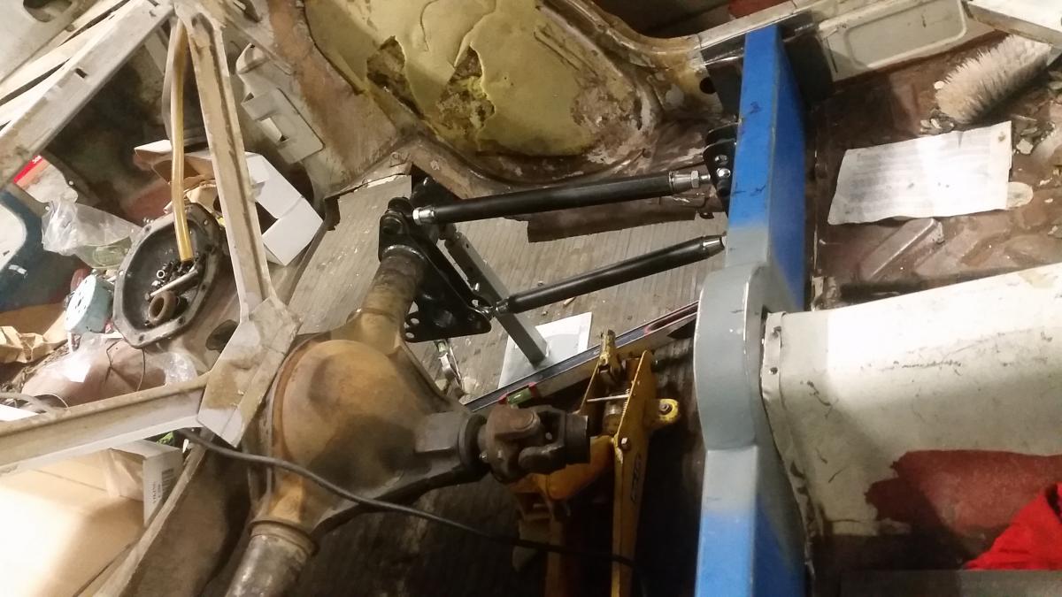

Front 4 link crossmember is made and sitting in position in the car. I worked out and drew up my 4 link brackets and arms tonight so I can start fabricating that next weekend.

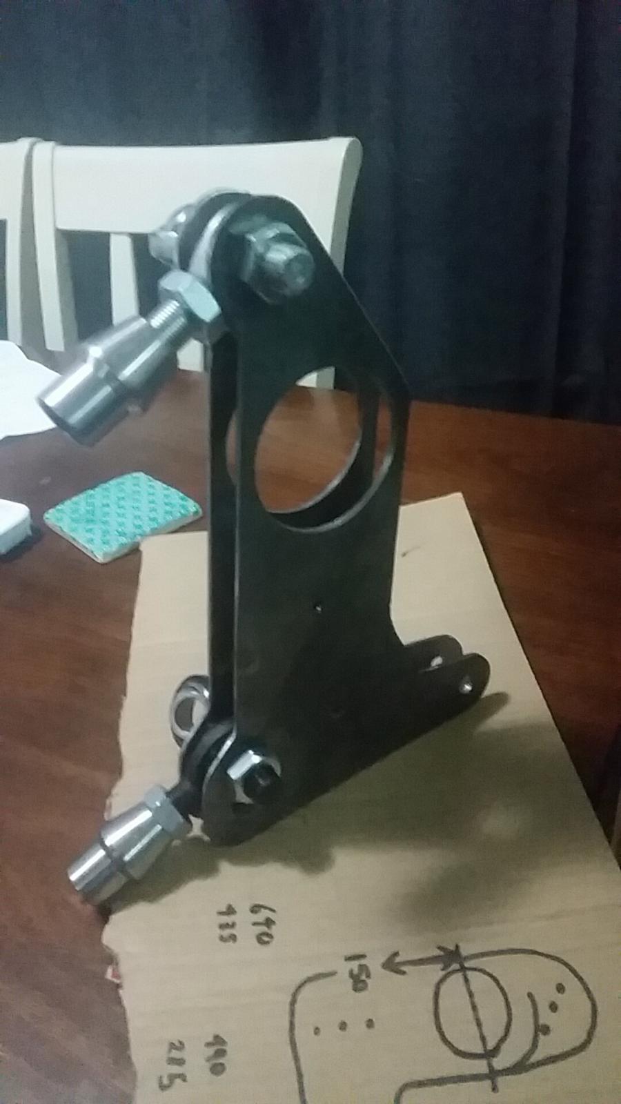

I made up my diff brackets last night after spending saturday night measuring, weighing drawing it up. For shocks I wanted to use viking double adjustable but suppliers only have one in stock in the length I wanted so probably gonna have to go with qa1's. Not really a bad thing because I know theyre a really good product. So i should have them here for the weekend!
