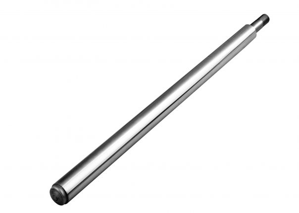

If you still have the original wet struts on the car the shock absorber will be part of the strut, no insert. The shaft is just chromed steel and you can easily have that shortened on a lathe. While it is stripped you can have an adjustable coilover threaded sleeve welded to the outside of the strut, so you keep all original components but lower it as much as you want.
just may have to do this if the mr2 stuff starts getting to complicated.
