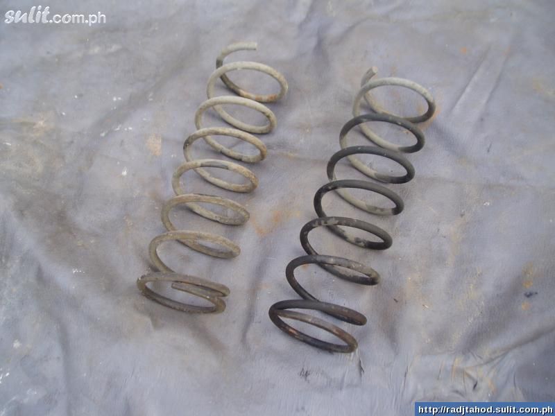

Rear Springs!!
When you're under the car can you get me-
the outside diameter of the coils, right across the spring. maybe 120-130mm
the wire diameter of the spring wire itself. maybe 10mm
the number of coils that are 'free' (not touching) when the car is sitting normally. (Jack under the diff) maybe 5 or 5& 1/2 to 6.
the total number of coils in the spring. Maybe a coil or two more than the free coils.
Then I can calculate the spring rate and see if we can use KP61s in the RA40 rally car. I've been hunting 1980s small cars at the wreckers but most have skinny stiff springs from being FWD.

I decided that upon fitting the front struts this afternoon and the dampening balance being stupidly out I fitted the new rear shocks. In doing so I slipped the springs out for you.
spring free height : 320mm
spring OD : 115mm
spring ID 95mm
Coil thickness : 10mm
windings : 7 complete
loading : when loaded with 10kg of weight the spring compressed 30mm.
I did the same load test to an 8kg spring and it compressed 15mm.
also have images with the coil alongside a measuring rule if you desire.
Cheers!- I assume they look like this, one end flattened and one end open. Usually the flat end (the top) closes right up and maybe touches the body mount 15 or 20mm past the spring end, and the open (diff) end might touch 1/3 of a turn, then instead of 7coils working we have about 5.5 active coils when loaded. You can see where they touch by just looking at the dirt marks in the coils.
Using Pontiac Racing's rate calculator here-
http://www.pontiacracing.net/js_coil_spring_rate.htm
We can put in 5.5 active coils, wire diameter 10mm, OD of spring 115mm, press enter and get a rate of 87lb/in, or 1.55kg/mm.
So they are quite soft springs and I am definately going to hunt a pair down!
The RA40 had a kerb weight of 1000kg when new, we gutted it completely then put in a cge, so I reckon the front weighs 600kg and the back 400kg. The diff weighs 70kg, the wheels 30kg and the Bilsteins have a gas pressure of 40kg each. Subtract that from the 400kg and the springs are holding up 110kg each. They should compress from 320mm down to 150mm. 70mm of that is wire (7coils at 10mm) so we get 80mm of travel in the rear suspension that the shocks & bump stops have to control.
That's not bad, a little less than we have, but worth trying to get more squat under acceleration.
