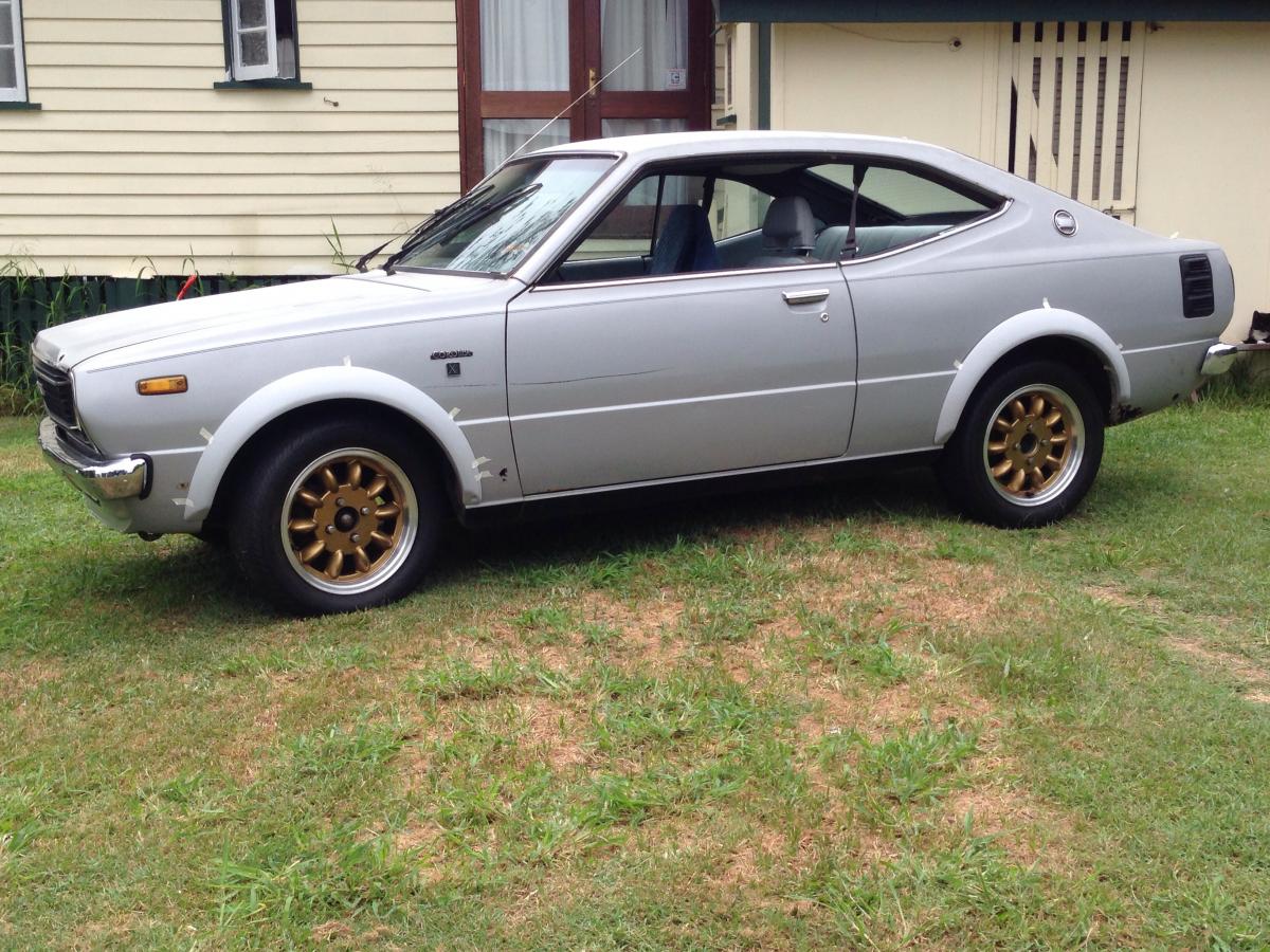

Mechanical Sympathy Posted May 8, 2014 Report Posted May 8, 2014 (edited) I think it depends how low you want your suspension and how wide you want your rims. A practical ride height and modest rims get around the need to cut and I think that's the path I'll take. I've got a set of TE37 copy flares for my KE55 XX coupe and the only thing that makes me baulk at fitting them is cutting or otherwise ʞ©$ɟing with the rear arches to clear a 9" rim for example. Though it's not as if they're rust free so something has to be done. These ones seem trickier to mount because there are no screw hole recesses in them. I'll have to epoxy mount shaped blocks to the inside of them and then screw them from the inside of the wheel arch. I think Clark Rubber sell an extrusion for mounting against the body. Gee they look good but. IMO anyway. I'm very envious of Parrot's steel flares. Edited May 8, 2014 by Mechanical Sympathy Quote
