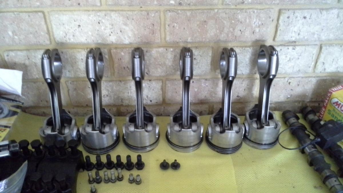

I then sold the engine and I have a 7mgte in my garage that I'm rebuilding with a forged bottum end better head gasket and new tourqe setting for the head bolts. I will be converting the car to ae86 coilovers all round better r31 brakes on the rear and bigger 86 brakes on the front.

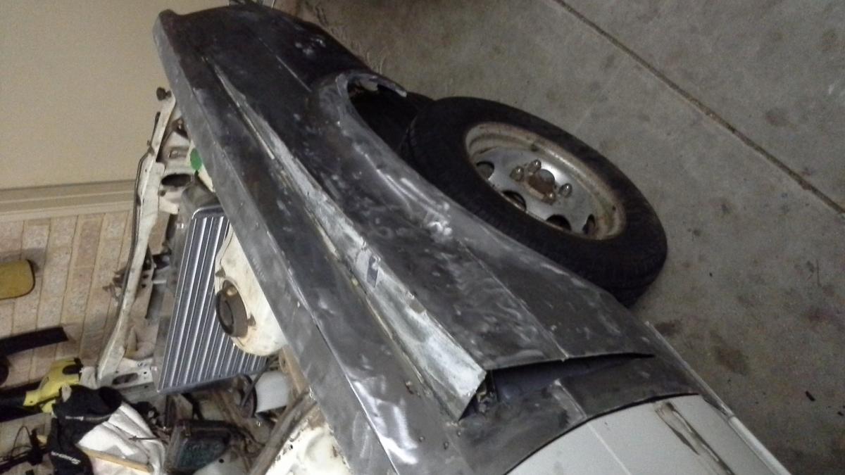

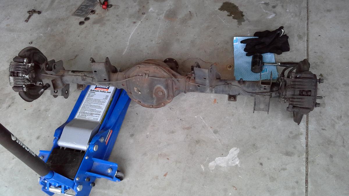

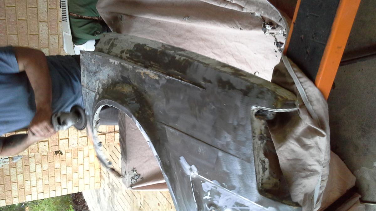

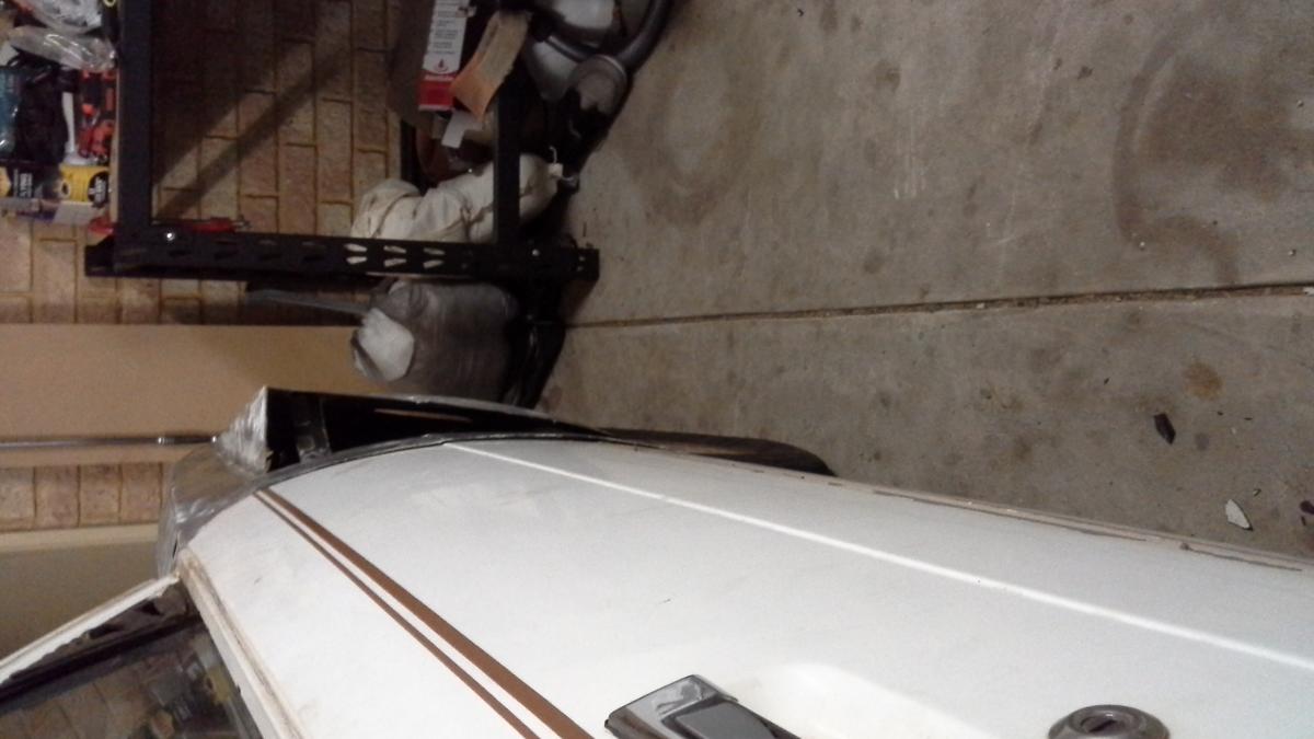

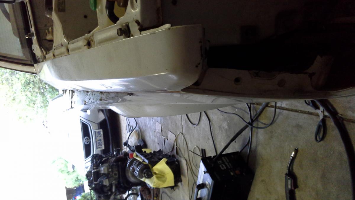

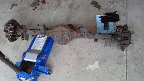

Hey my brother in law and my self had a spare day so we knocked most of the tar out of the interior with dry ice and a mallet and started stripping the r31 axel down waiting on our new mounts to be welded up and we also started on flareing the front gaurds out
I chucked the fender back on the car and I thought lol that looks random as f*#k but any way it will look cool once its much lower and bigger rims ....... I hope lol

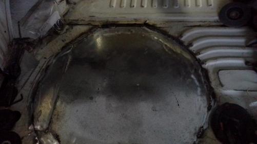

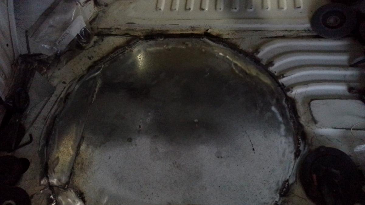

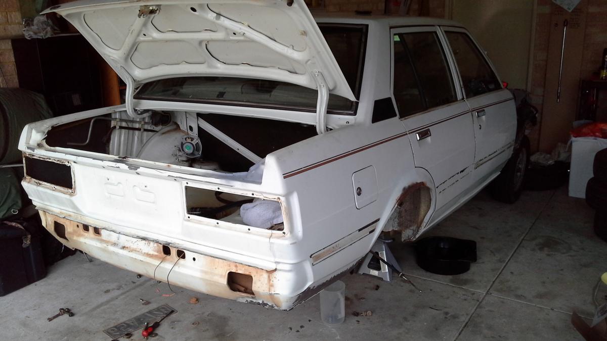

So today I removed the spare tyre holder and put a new sheet of steel in there ready for the boot mounted radiator and fuel cell and also cut more of the body away so the rear diffuser can fit in

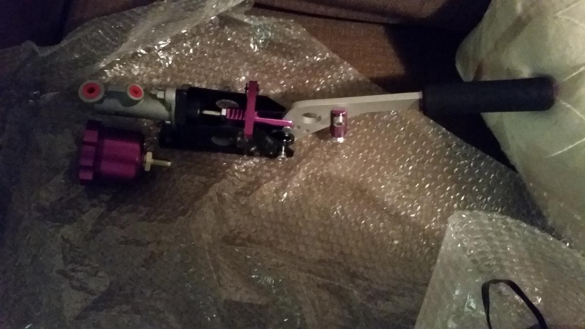

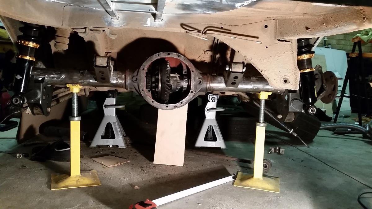

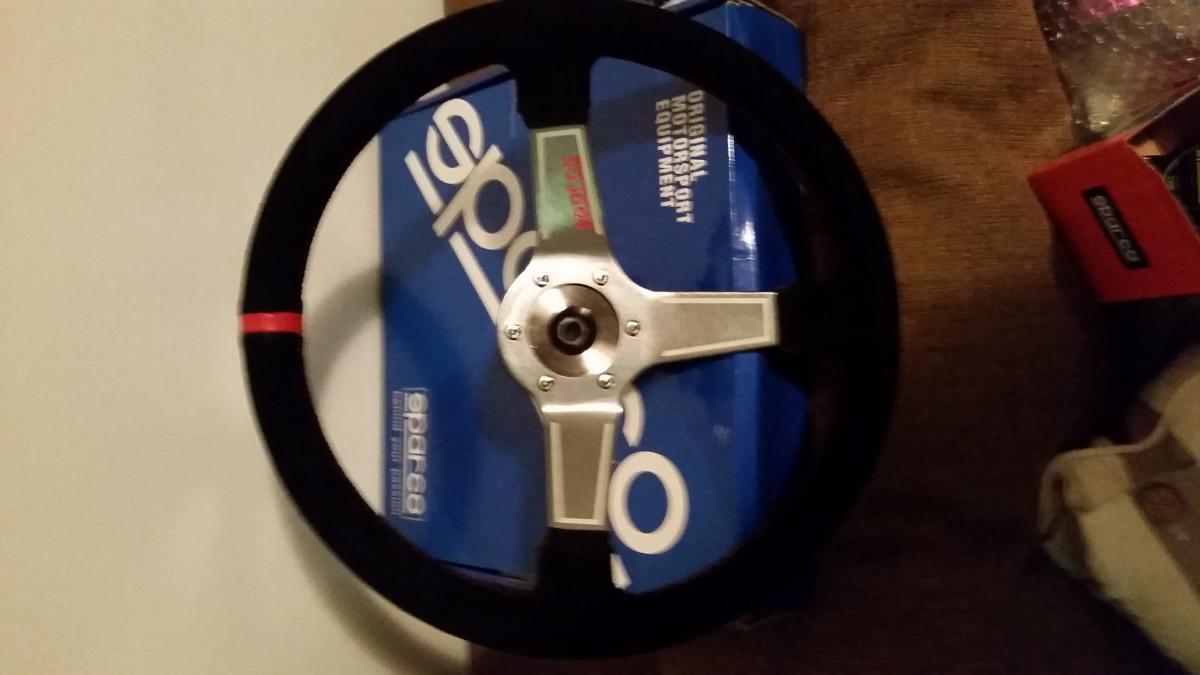

So finally some stuff arrived in the post I received new stronger mounts for the skyline diff and I got some second hand xyz coilovers and have converted the rear to coilover rear instead of seperate springs and shocks the new steering wheels arrived and hydro hand brake. So tomorrow the last few welds will be done on the diff then to get a new adjustable 4 links. Next will be rebuilding the skyline brakes unless some one can help me with a better brake upgrade for the rear after the rear brakes are done the front suspension and brakes will be the next upgrade.
Make sure you have the suspension travel sorted out carefully or bottoming out will knock the shock mount off the diff won't it? The weight of the car at 2G currently goes into the top of the diff with the shock taking a portion of that to slow the motion down, whereas you will put all that force through the mount pin.

Are you going to use twin master cylinders on the brake setup?? I can't see you ever needing that hydraulic handbrake in time attack or hillclimbs, they're really just a bling factor.

The only reason we have gone for a hydro hand brake is for hillclimb And motor or gym khana.
And the shock mounts on the diff have very beefy. But its all good feed back thanks mate.

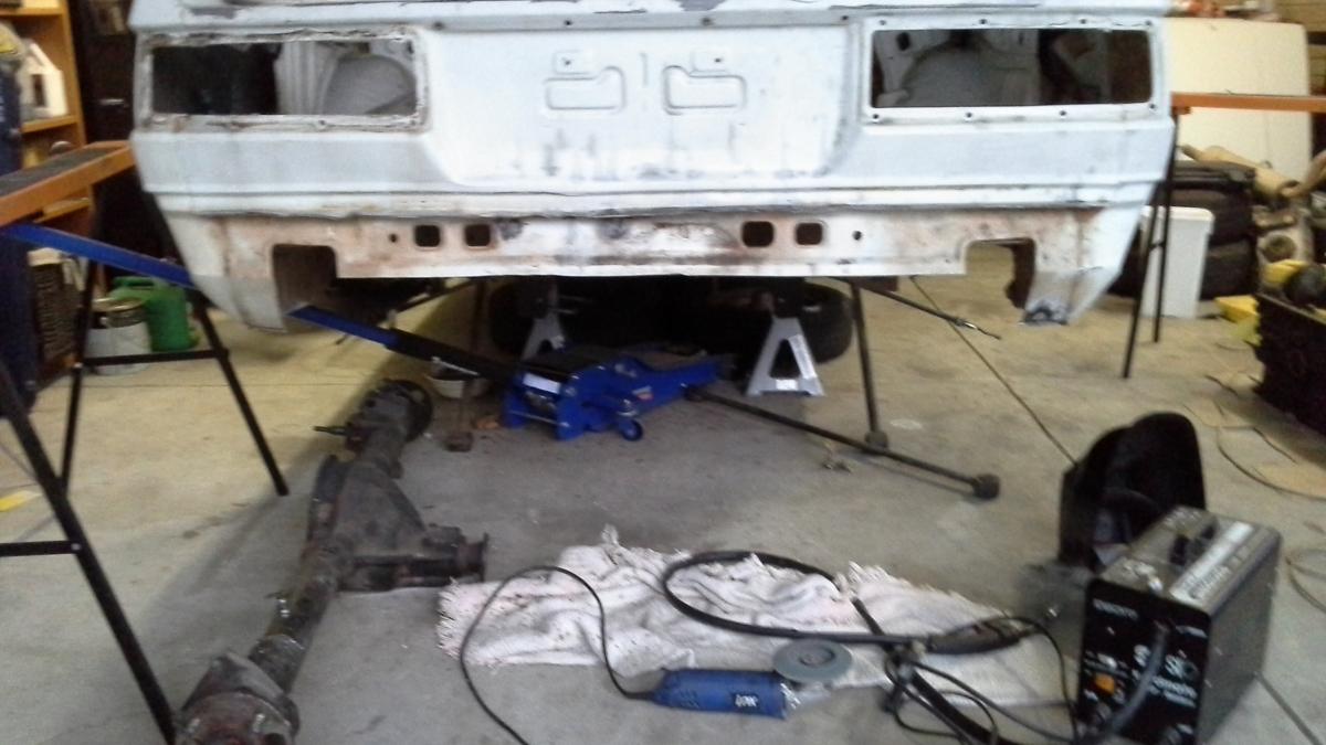

So I was finishing off the welds on the diff and I could smell smoke I was like wtf is that smell it doesnt smell like welding took my welding shield off and look at my welder and its on fire .... my welder chernobyled fml
