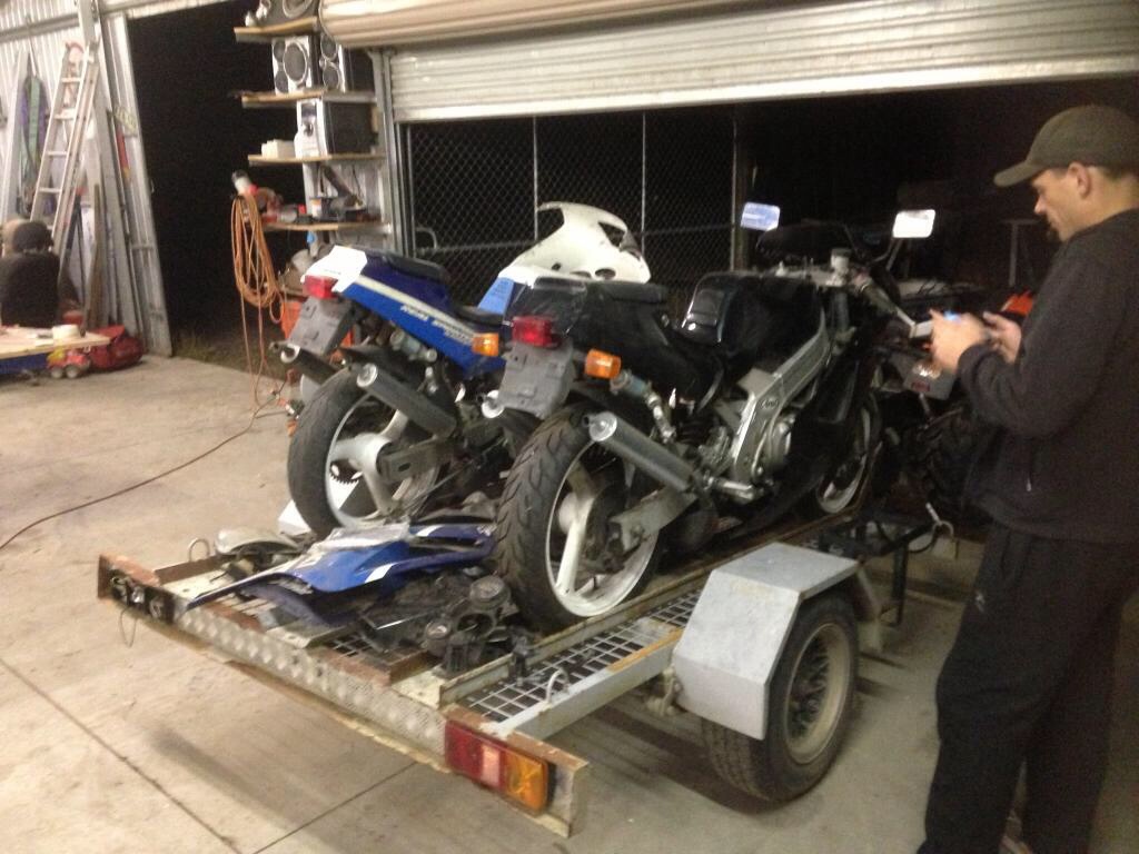

Everyone likes a photo.
Good chance, I'll be draging these baby's, out of the chook shed tomorrow. Locksmith friend is coming over to cut me some keys late arvo, then I can play.
