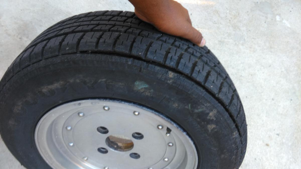

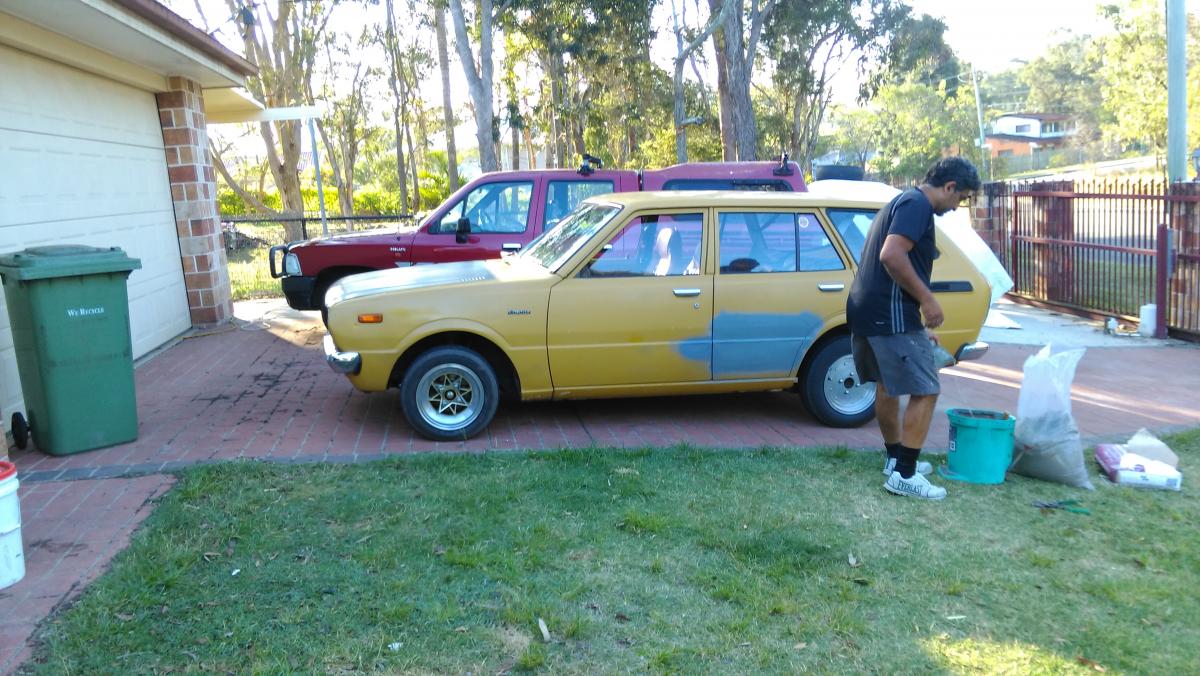

I picked up a set of Enkei supersharks 13x6 5.5 offset the fronts had a decent about of tread and the rears were bald and i picked up some lowered kings springs from a guy in Munruben. ill put them in as soon as i get some lowering blocks.
So far ive only had 3 problems with the car so far.... 1st thing was my fuel pump diaphragm went so we got a new one from autobaurn now its working fine. then the rear tyres split and last the exhaust snapped before the flange in the middle. sounded good for about 10 minutes then it got annoying so i pulled the one off the white car since its not on the road

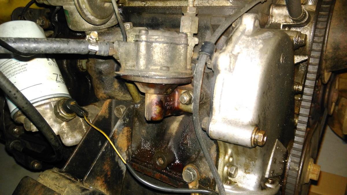

Bought another 4k from a ke70 and put that in took all the egr stuff off and used my old Mani and Weber. Will upload pics later of the engine

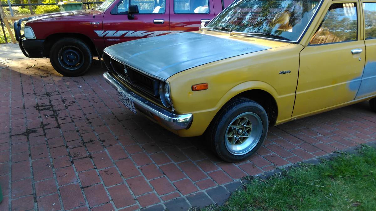

painted the bonnet came up ok its darker then the rest of the car, but one day ill wax it.
