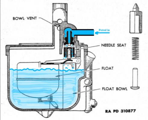

Carb needle and seat valve on the float..
The float goes up as the carb fills and pushes the little cone-shaped needle into its seat to stop petrol coming in. All you need is a bit of dirt on the seat and petrol will keep pouring in and flood everything.
Pull the carb top off and look in there carefully. The seat tube unscrews to check it. Crank the motor and flush the fuel into a can & look for dirt in it. If the needle point is worn, get a new one.
Adjustments will do nothing, the only adjustment for mixture is the idle screw, which doesn't affect mixture when driving.
