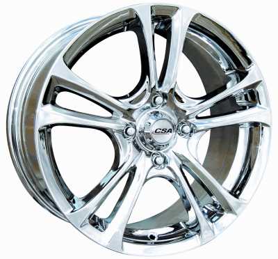

Just wondering if anyone knows if the 15 inch CSA Shadow Chrome Mags Would fit on my rolla... :lmao:
depends if they are a 4x110 stud pattern if they are then they should fit .
I'm pretty sure yours is a 4x110
anyone else wanna confirm this
You will have to get wheels that have a PCD of 4x100 and about a 38 offset.

Like Trev said, your stud pattern will be 4x100 and you should ask if they are FWD offset, I wouldn't have a clue what it is...
RWD rims won't fit on a FWD from what I've gathered.

you want 4X100PCD with an offset of 38-40 for a nice fit :P

Just watch the wheel offset, we had a lot of troubles at the dealership, trying to fit 15" wheels from a AE112 / 101's on to AE82 / AE92's. as they have a different offset and caused the tyres to scrub on the strut's.
Best thing to do is call a tyre & wheel specialist and find out what the exact offset needs to be, and compare it to the whhels you wish to buy.
The other thing to watch is the center cap diamiter, and the diamiter of the hub locator. If the hub locator is larger than the centercap hole, your wheels will never bolt flush on to your hub and become verry dangerous. If the hub locator is smaller than the center cap hole, you can fix this by fitting a spacer sleave i to the center cap hole on your wheel.
