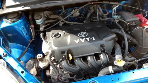

I half expected it was going to be a bit difficult, as I assumed the east west 2NZ-FE engine would be crammed into the small front engine bay.
I was pleasantly surprised how easy it was to work on, and after a full day on it, had fallen in love with the 2NZ-FE engine. These engines, have a very good reputation for being strong, reliable, nippy, & very fuel efficient, from what I had read on the net. The spark plugs I took out, needed replacing, as the gaps were wide with the inner tips worn out, but the insulators were perfect, showing a lovely clean whitish colour. The more I worked on the engine, the more I loved it. Even taking off the throttle body & cleaning it with carby & throttle cleaner was easy. About the only unpleasant job, was removing the fuel pump/guage/filter assembly out of the tank under the floor, under the back seat. What a nightmare, to dissemble & fit the main & pick up filters.

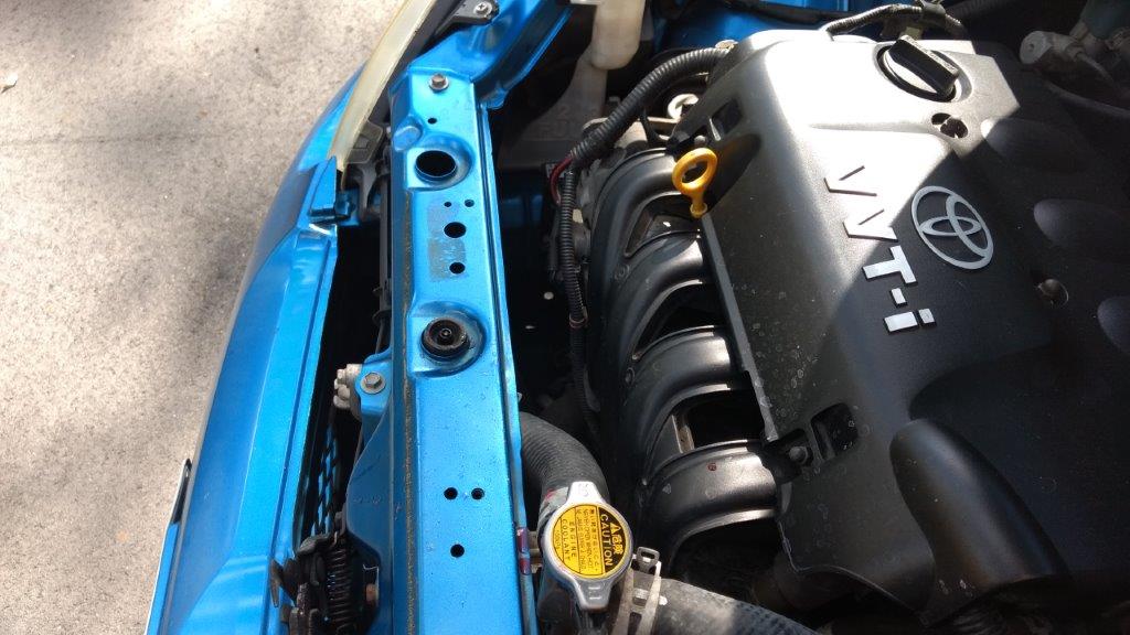

My gut feeling it is probably because of lack of facilities on the side of the block to fit engine mounts. The existing engine mounts on the 2NZ-FE in my daughter’s Echo are high up on what would be the front of the engine, if mounted in a KE Rolla. The other one appears to be high up to one side off the bell housing/gearbox.

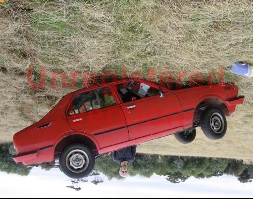

A std 4k engine was enough for my friend to roll our KE55 bash car onto its roof!
Now Now ! That's not a nice way to treat a Rolla.
As Donald would say. That could be fake news. Maybe you just rotated the photo, & got your friend to stand on his head. Ha Ha !
hahaah.
hes not the one who rolled it, it was another guy, who looked really white afterwards.
did you know that a corolla with a stock carb will run fine immediately after being upside down with oil all through the carb.
Also, i thought it was a good reason to finally add myself an avatar..
btw the back door that you can see in that picture is actually 99% made out of space invader foam and bog, held together with paint!

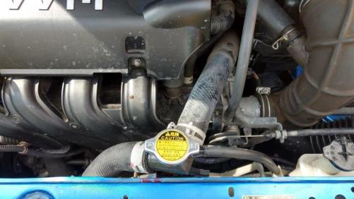

Keith, the head has a water outlet on the back of the head going back to the radiator header tank, but I don't think it will be an issue, as I do not think the engine will have to go hard up against the firewall. Easier to rearrange than a distributor on the 4AGE. The throttle body might have to be repositioned, as it sticks out beyond the rear of the engine. Someone jokingly remarked in the Toymods link, that you could cut a hole in the firewall, & but the air filter box in the glovebox.

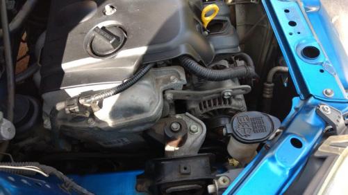

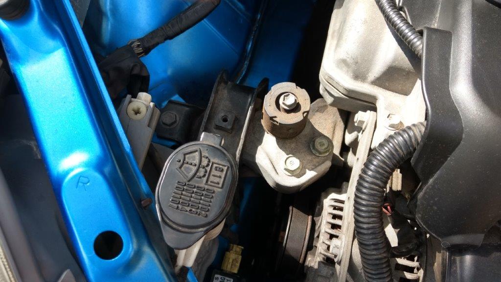

There are three engine / gearbox mounts on the Echo setup. One right at the front of the engine. One down onto the cross member next to the exhaust header. One apparently under the battery, off the gearbox housing.
Next time I put it up on the ramps, I'll pull off all those plastic stone guards around the engine, so I can have a good look.
Maybe the adaptor plate for the bell housing/gearbox could be profiled to hang out each side a little, so rubber engine mounts can be attached.
