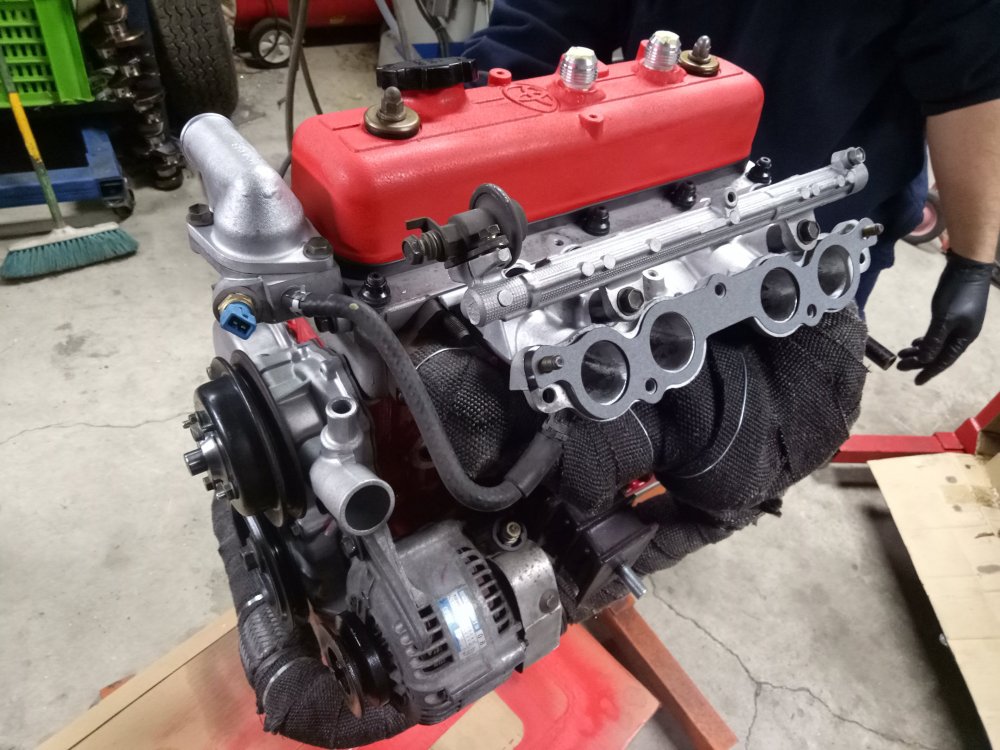

    Put fake original ex tip on the dumpy

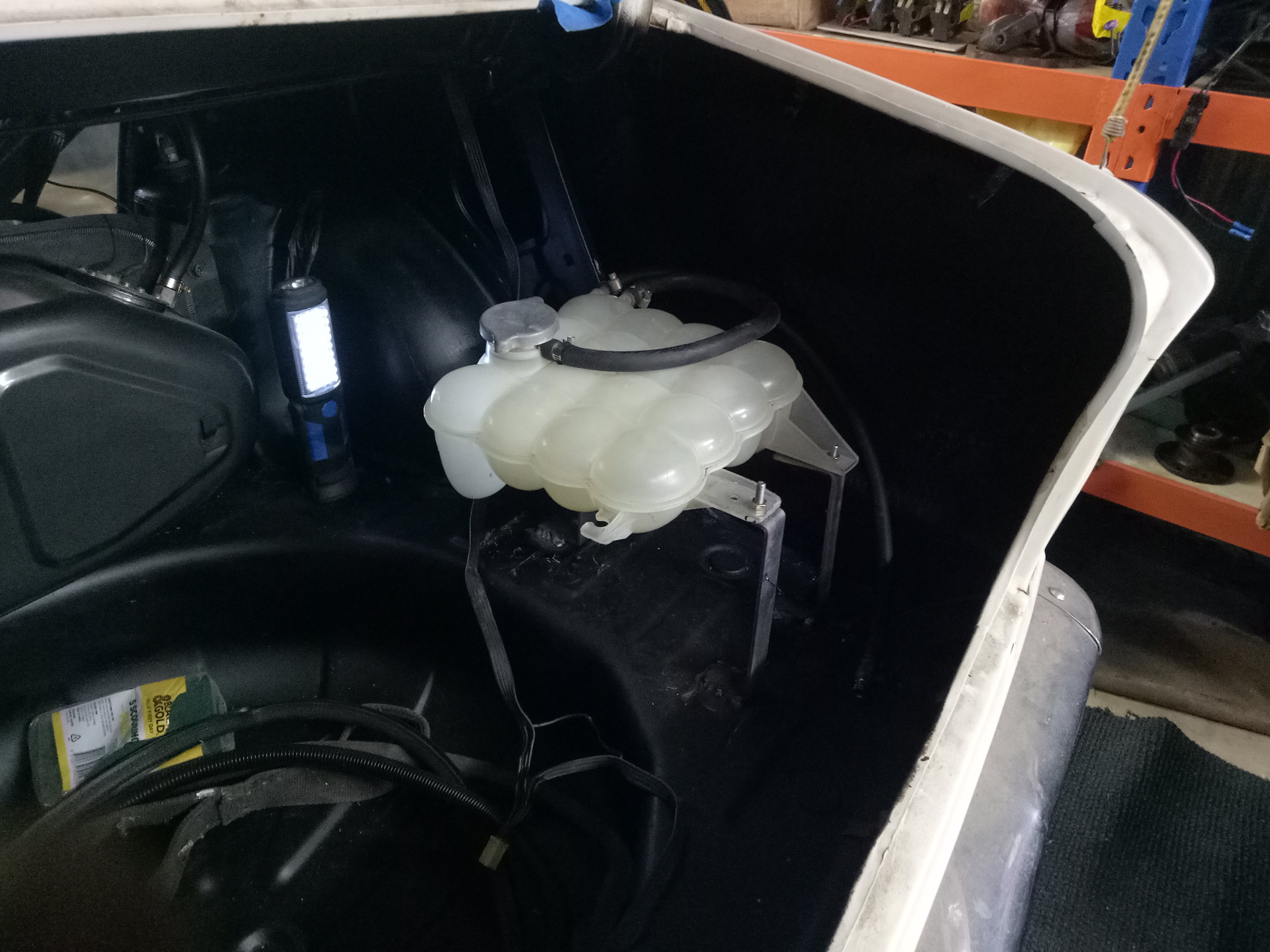

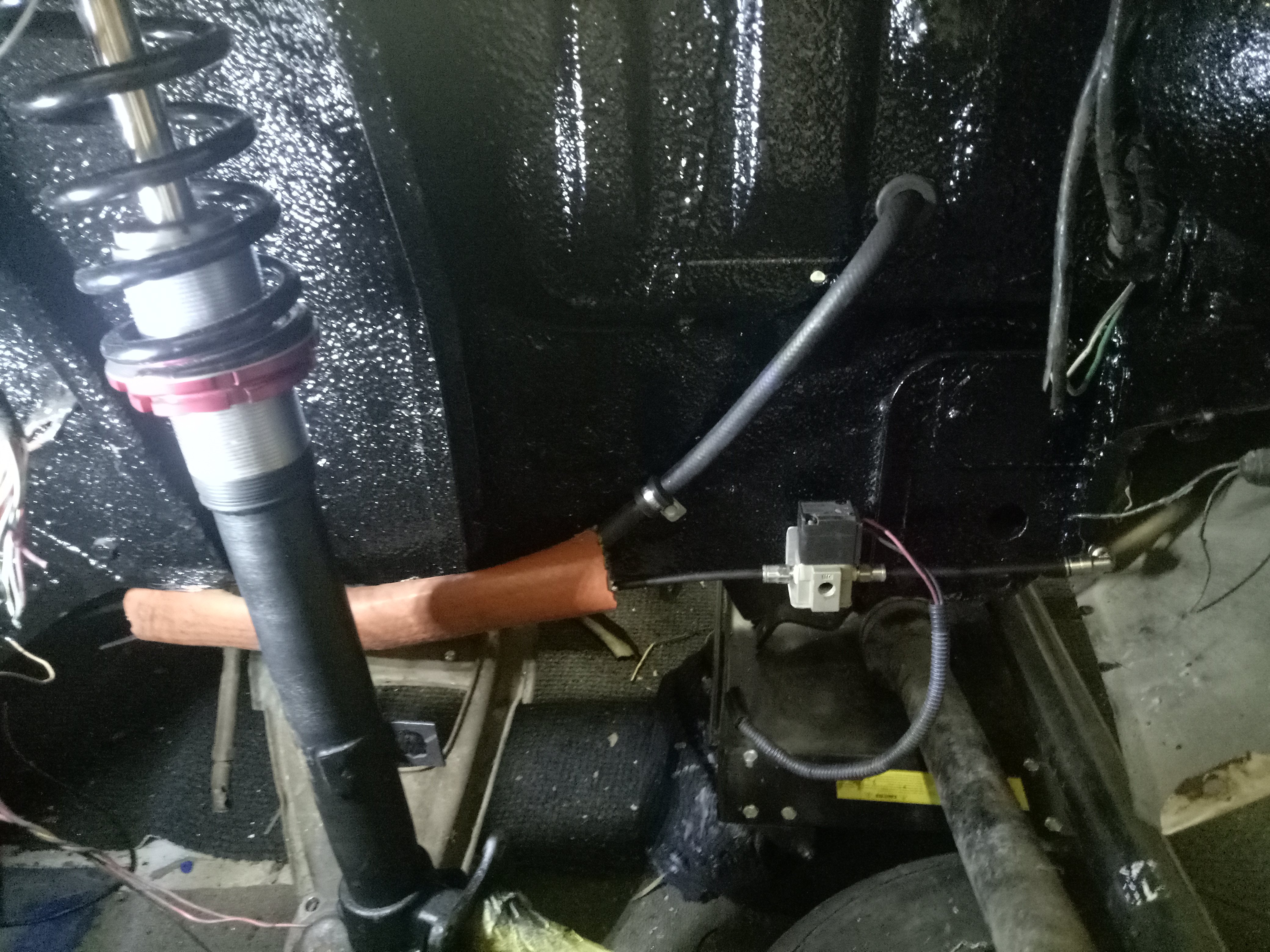

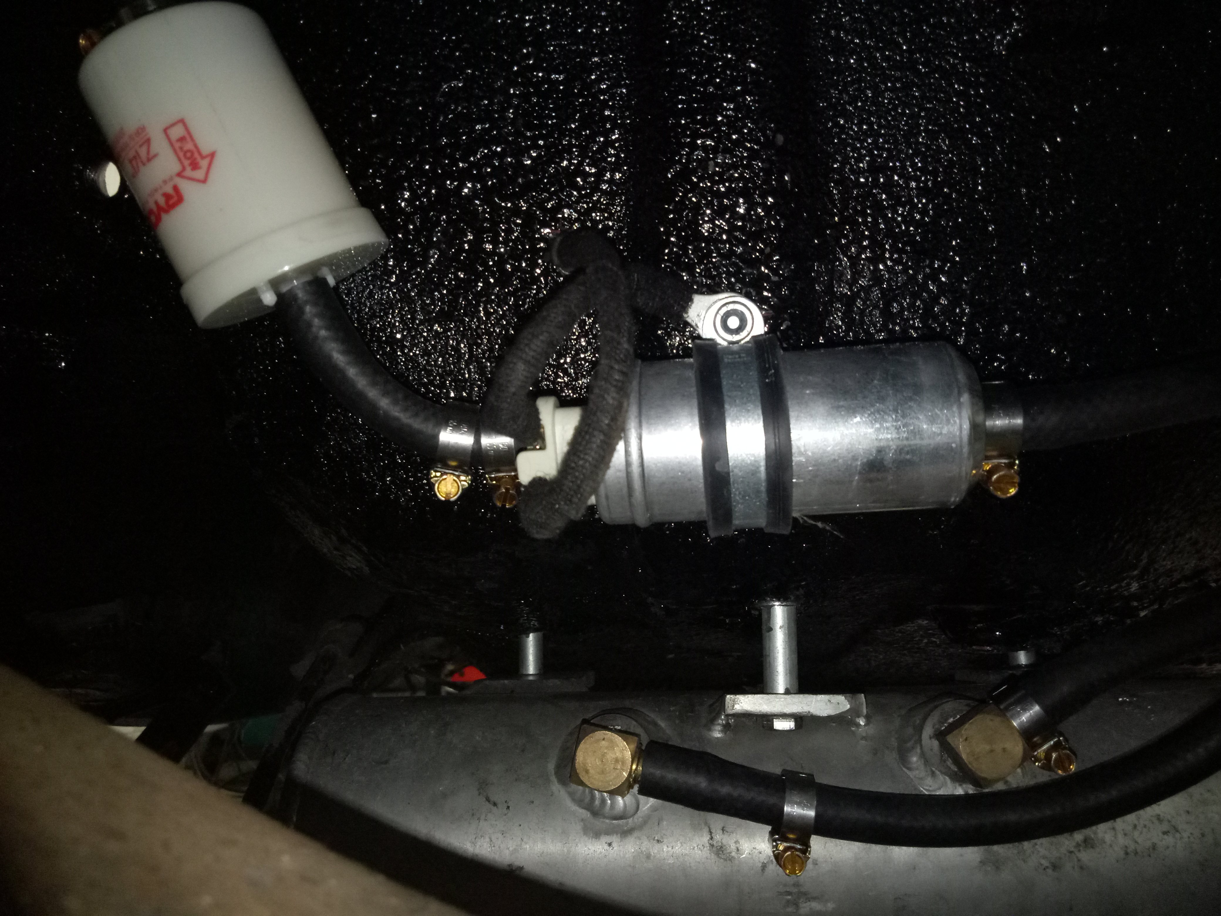

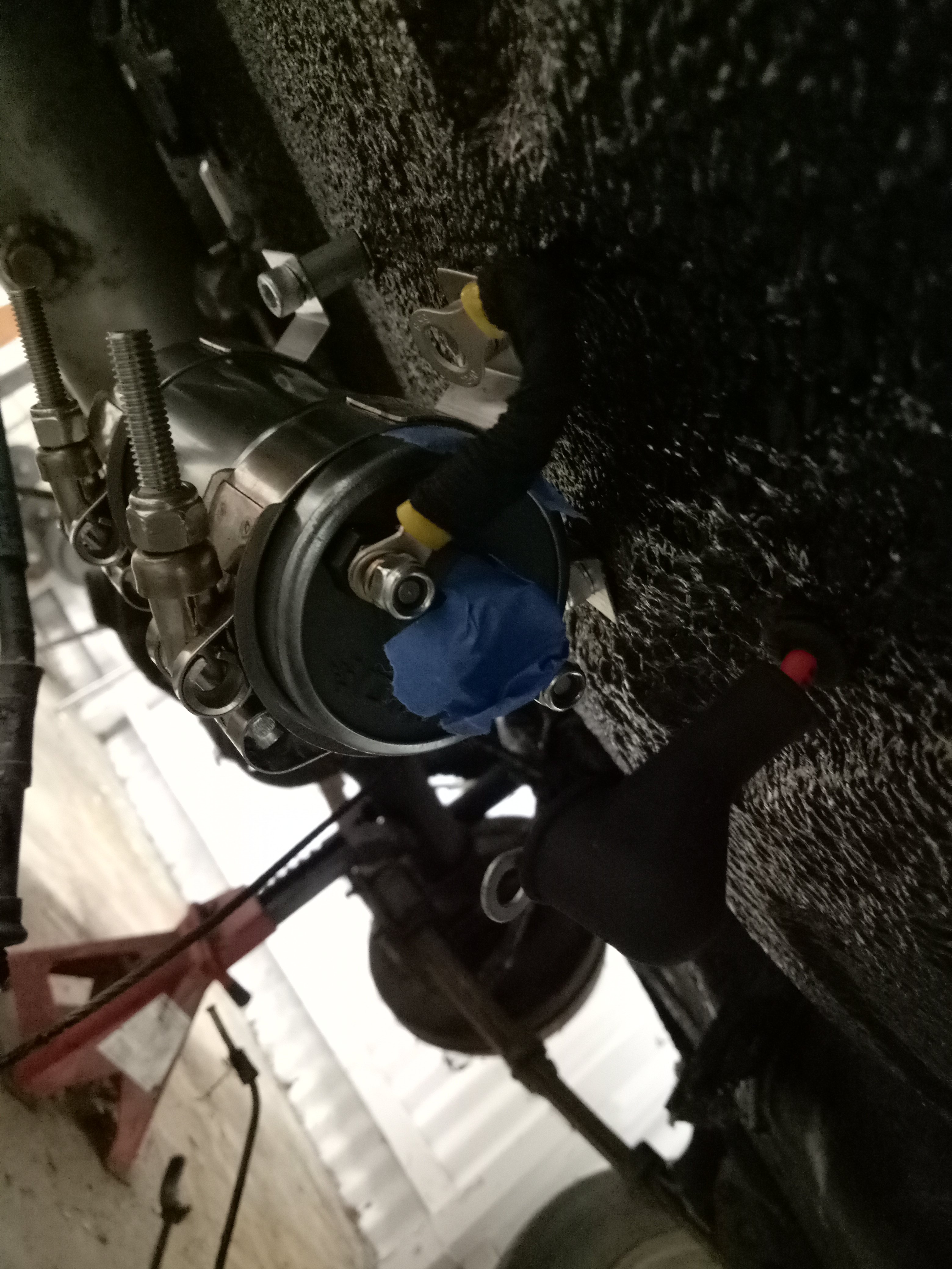

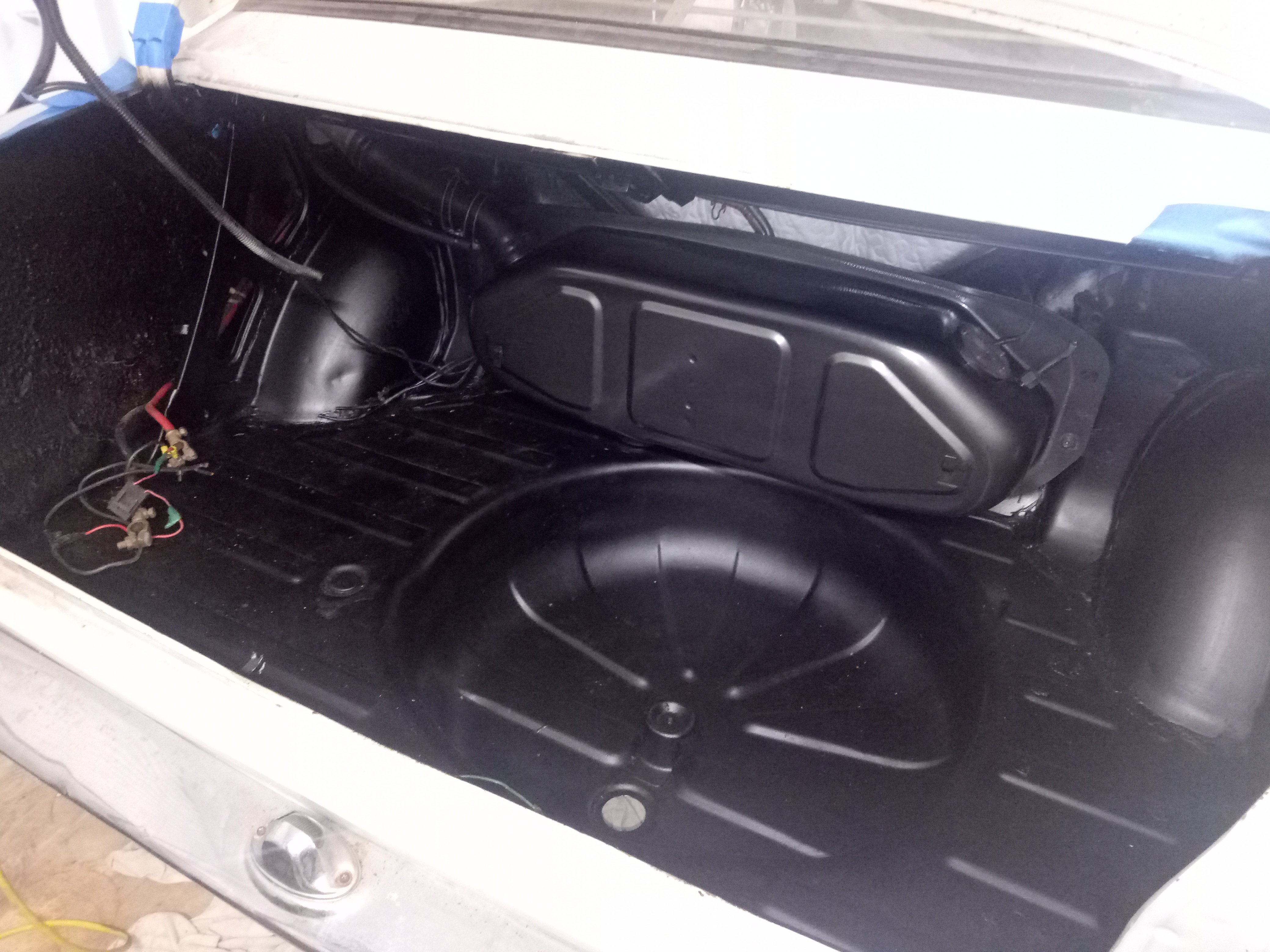

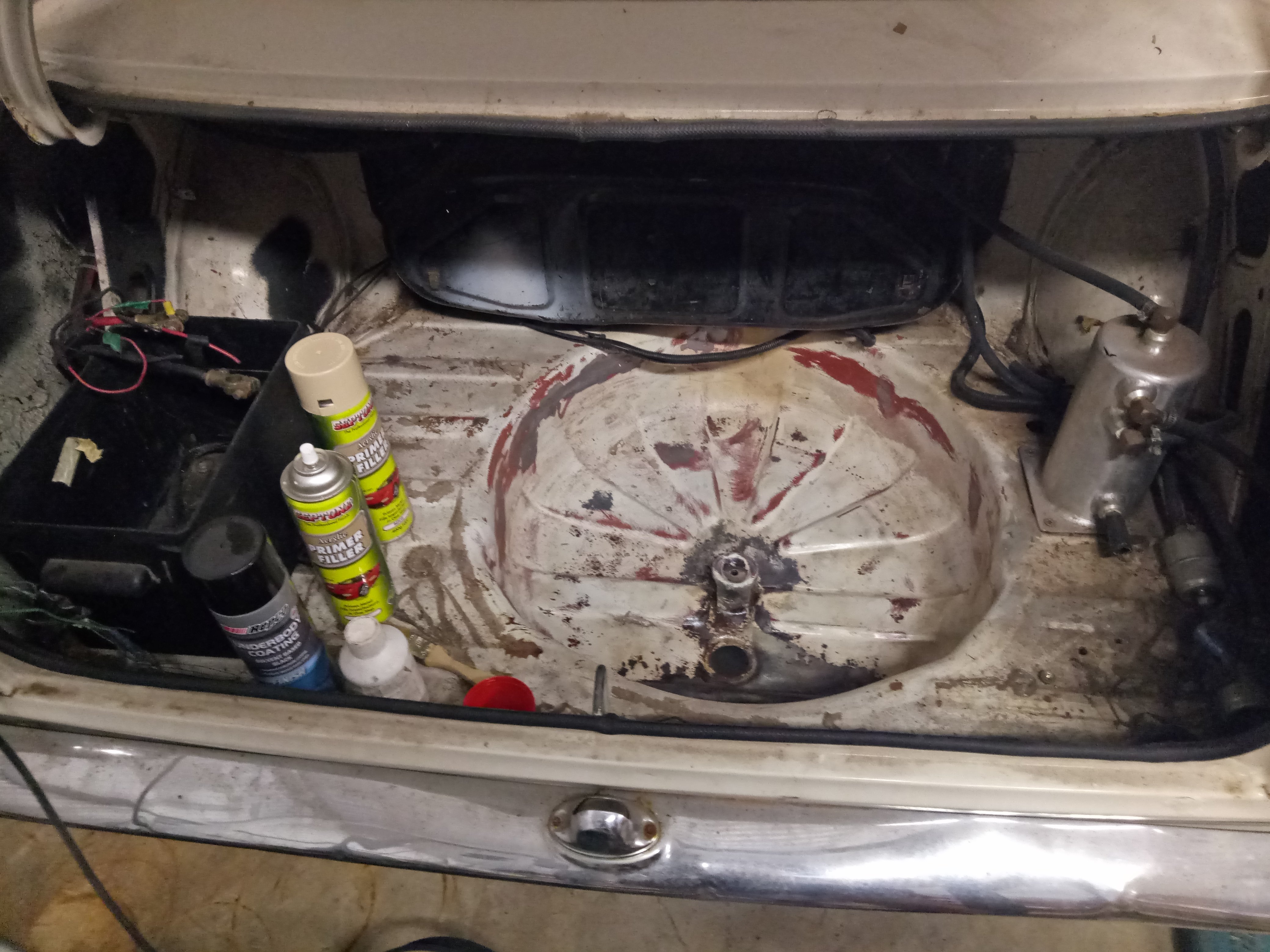

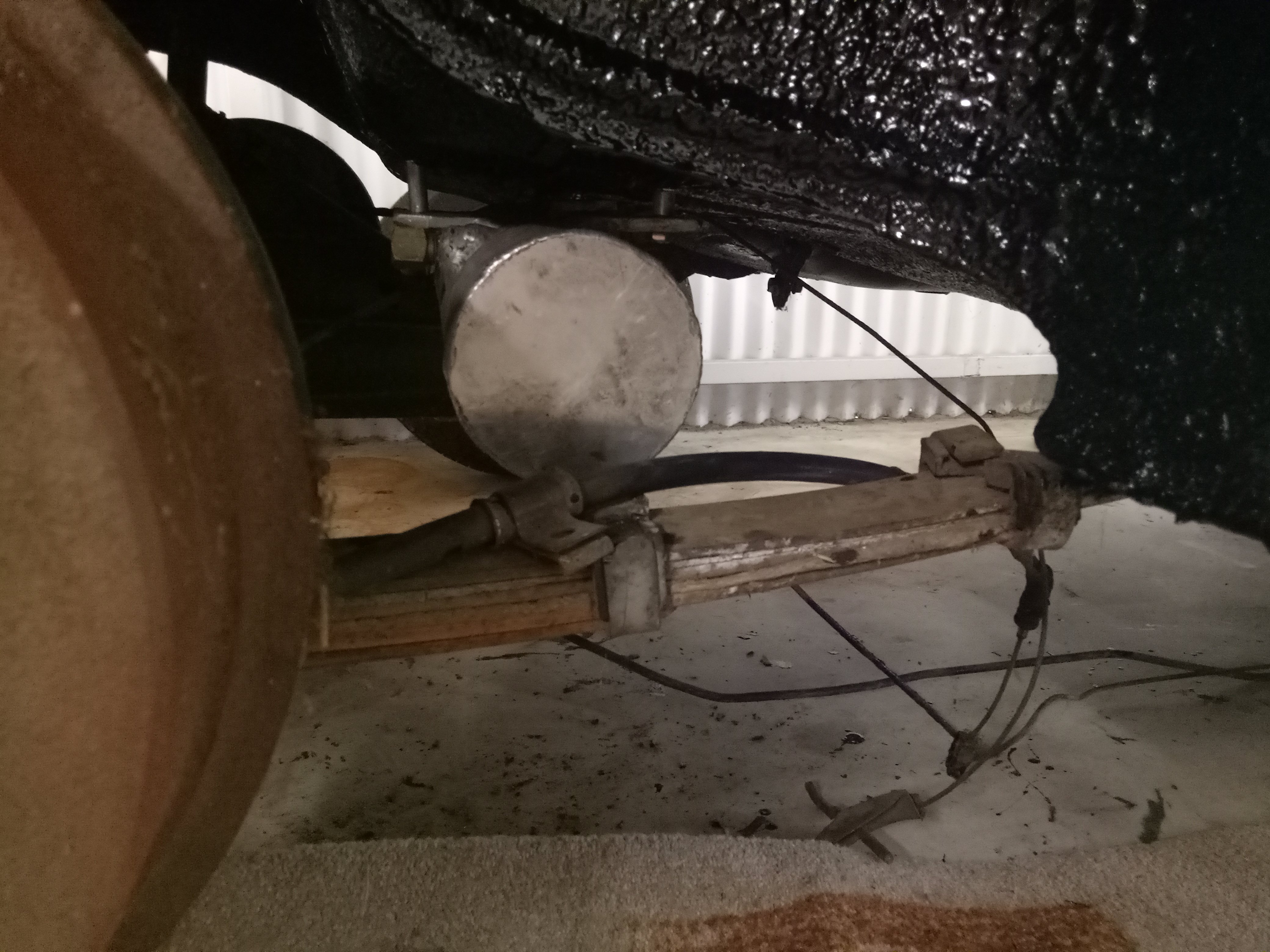

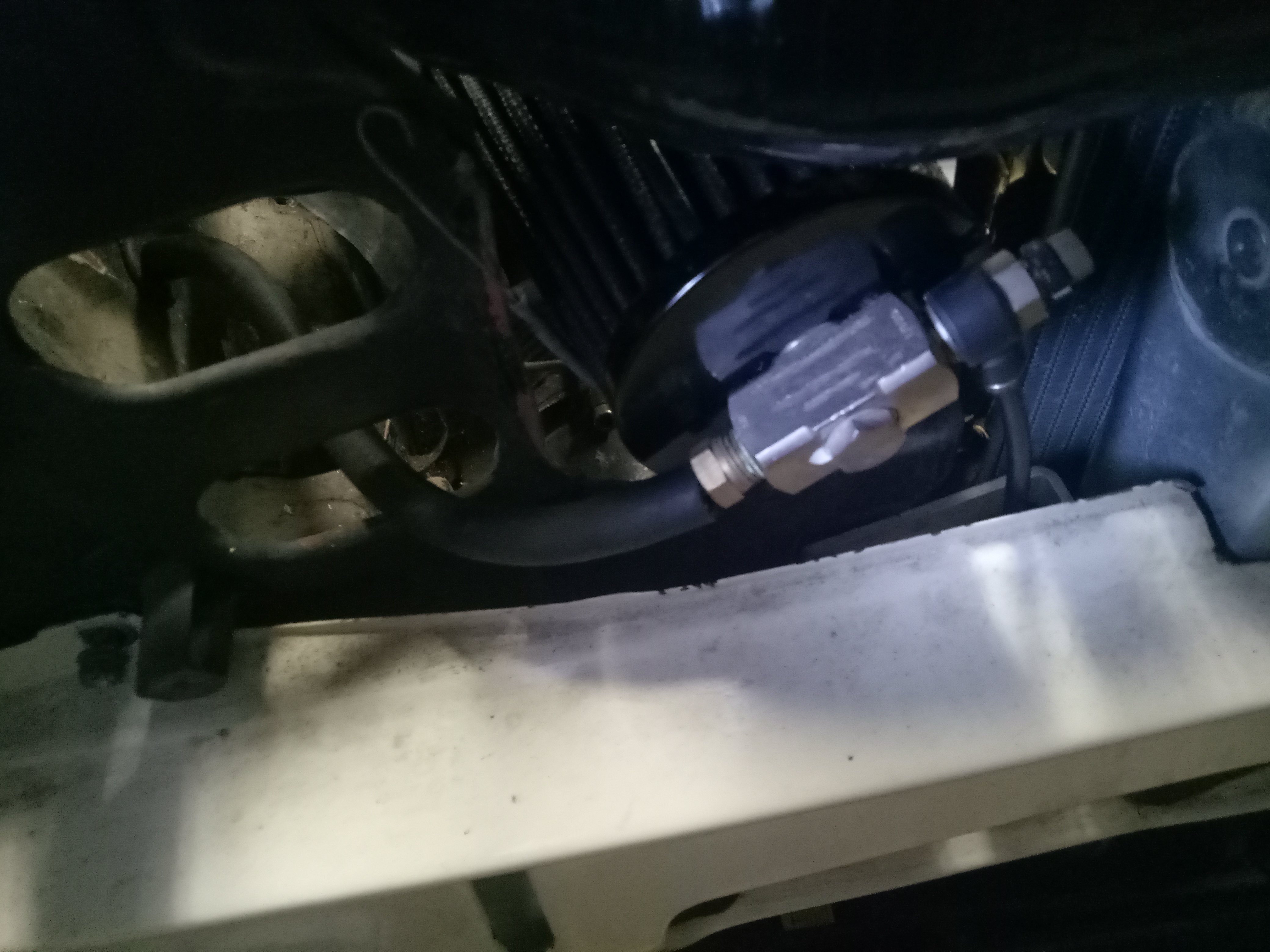

Tidied boot up. Got rid of surge tank in boot. Cleaned out fuel tank and por15 internals. Ran new efi lines to a pierburg pickup pump under car.. Then to Undercar surge tank being picked up by a efi pump
Will change petrol filter to z series metal one before starting car
Added a water/methanol kit. Crucial on a non crossflow motor to stop heatsoak in my opinion..
Used a falcon overflow for tank with a few brackets made up

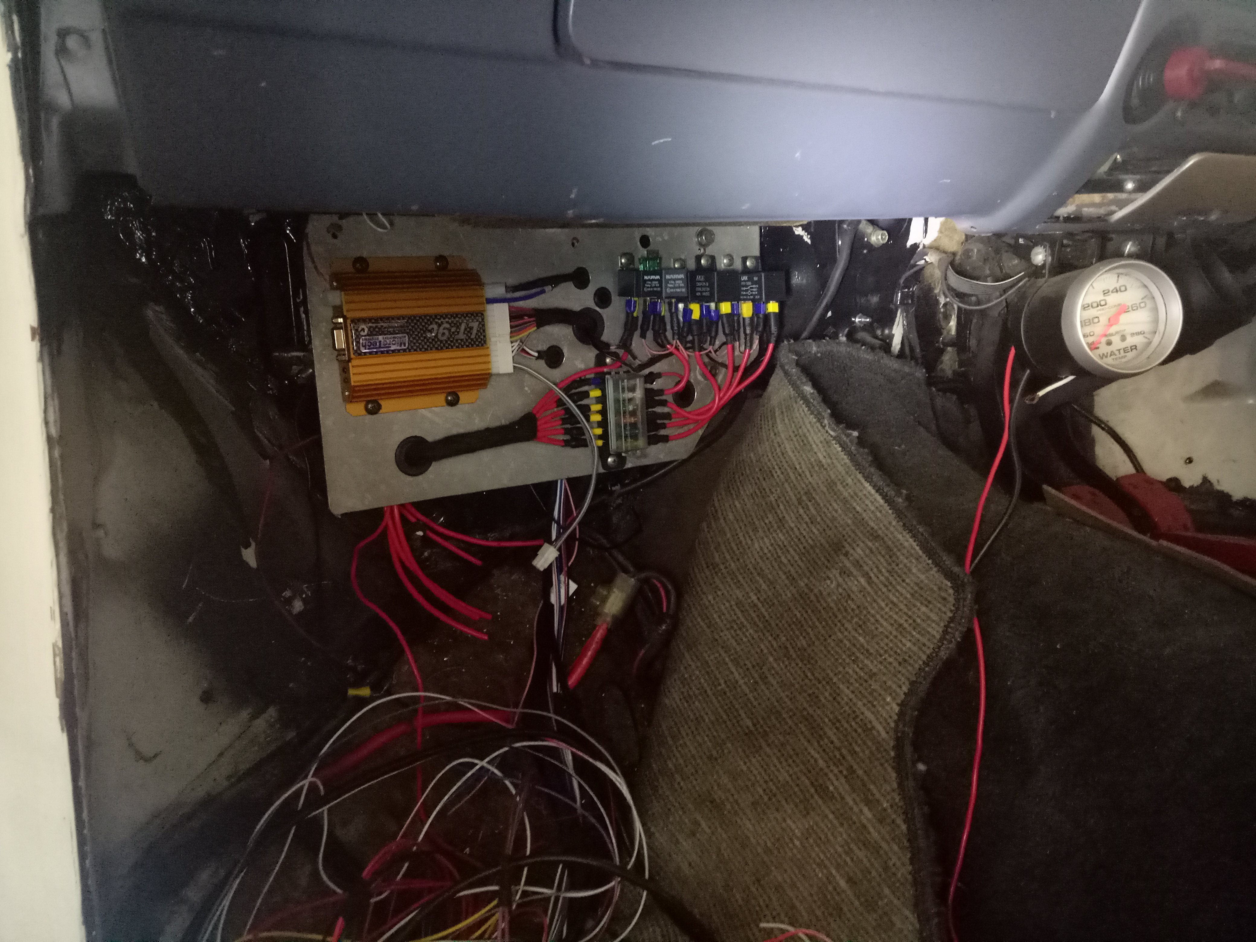

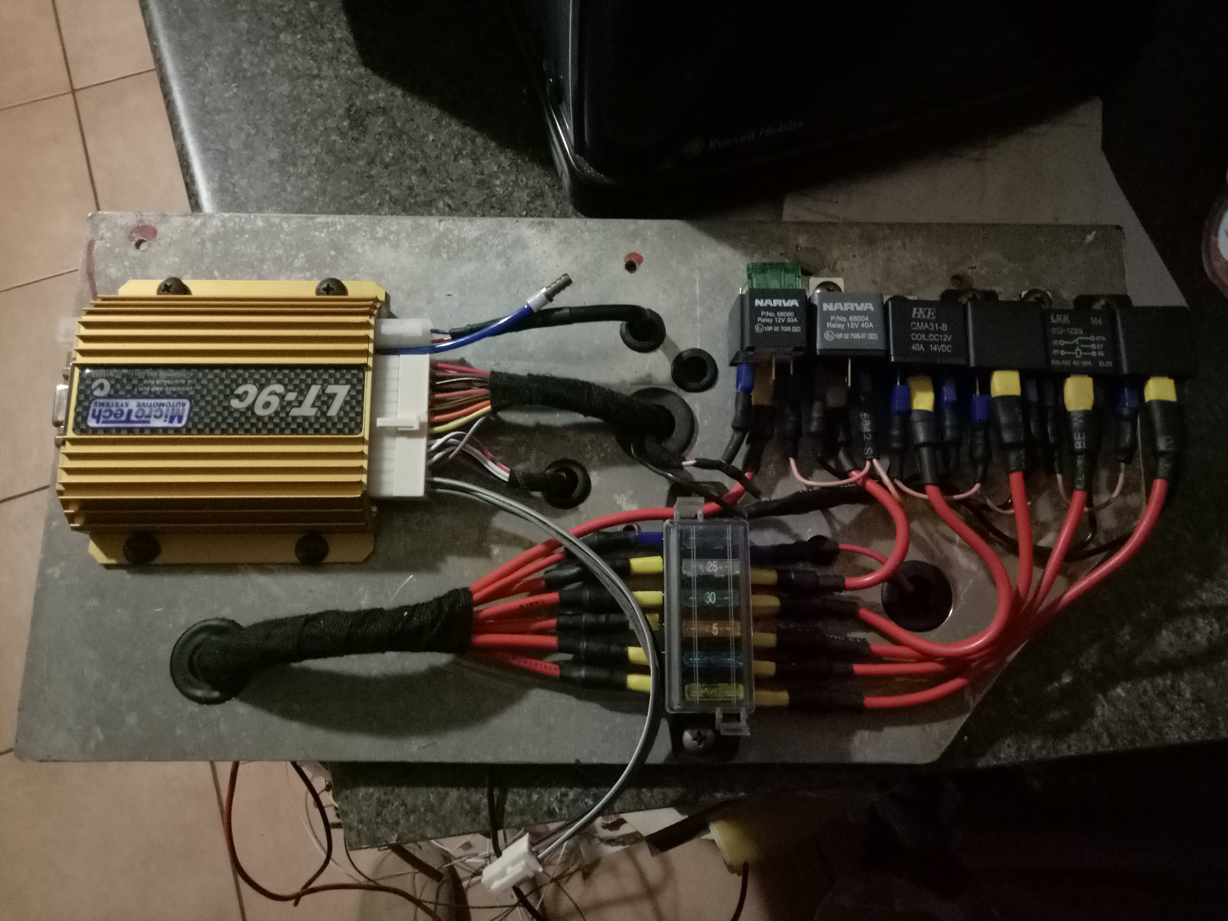

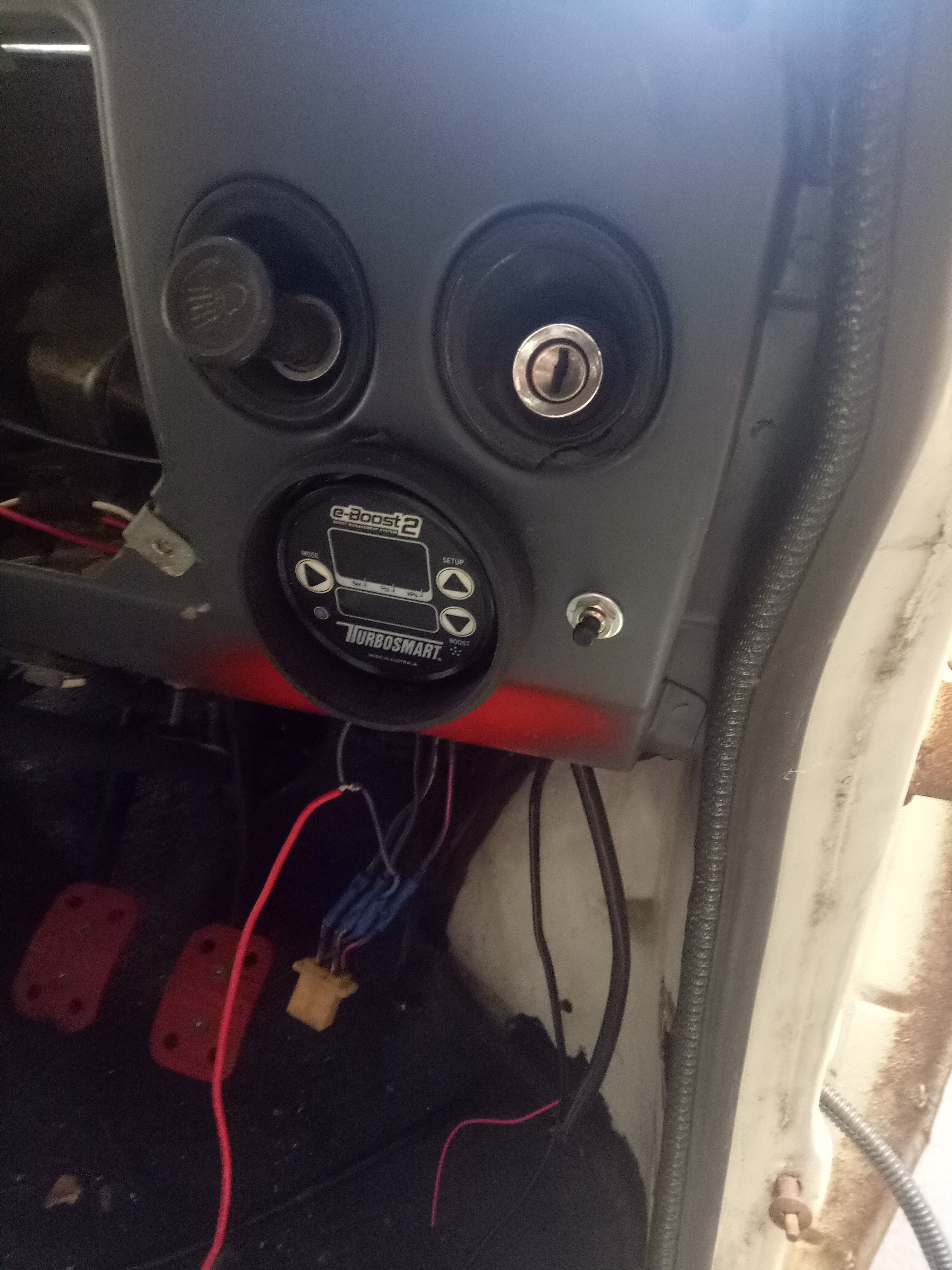

Wired in a microtech lt9c..40psi.map sensor.. Just using a ls2 coil amd standard 7k dizzy atm

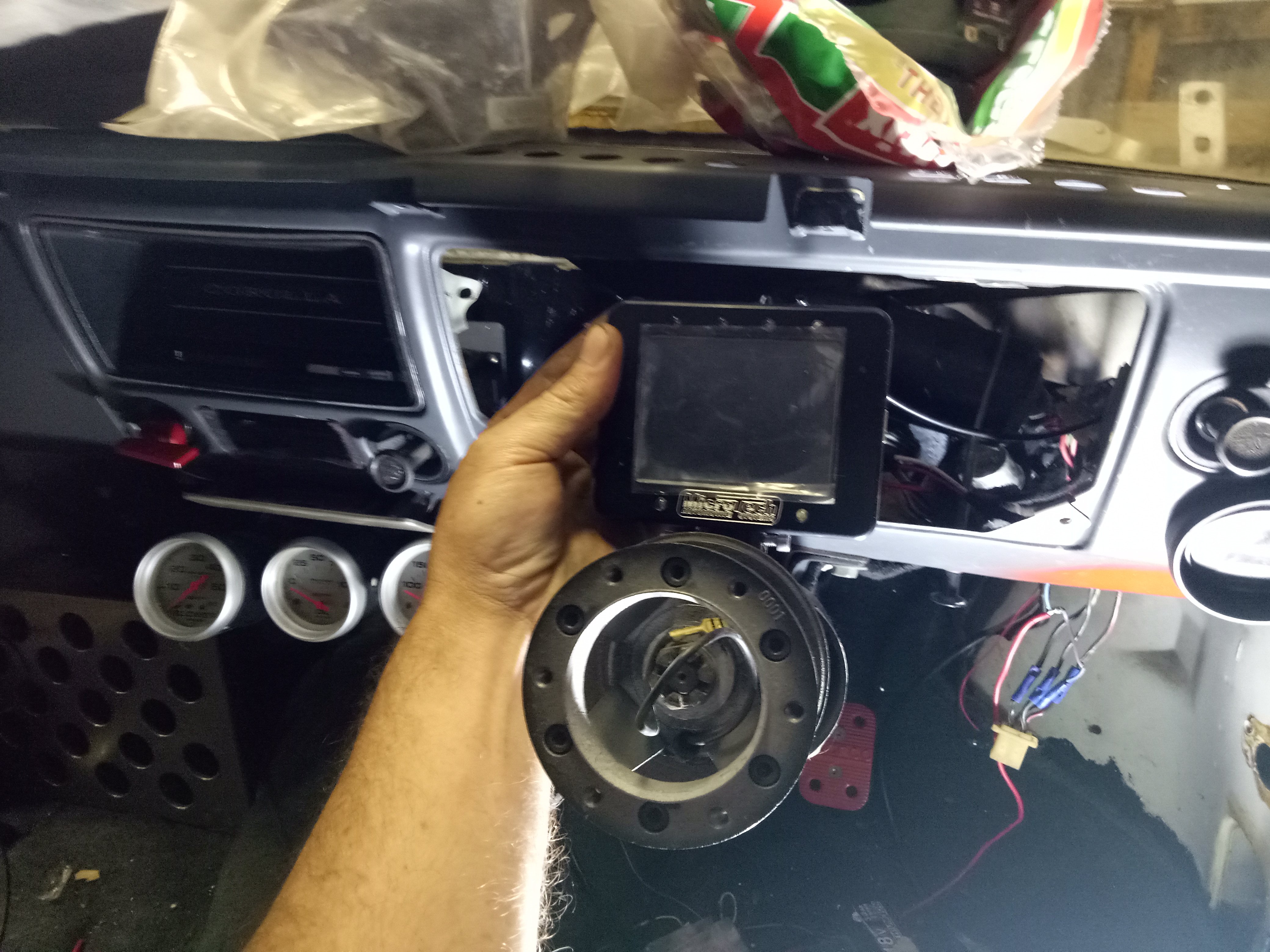

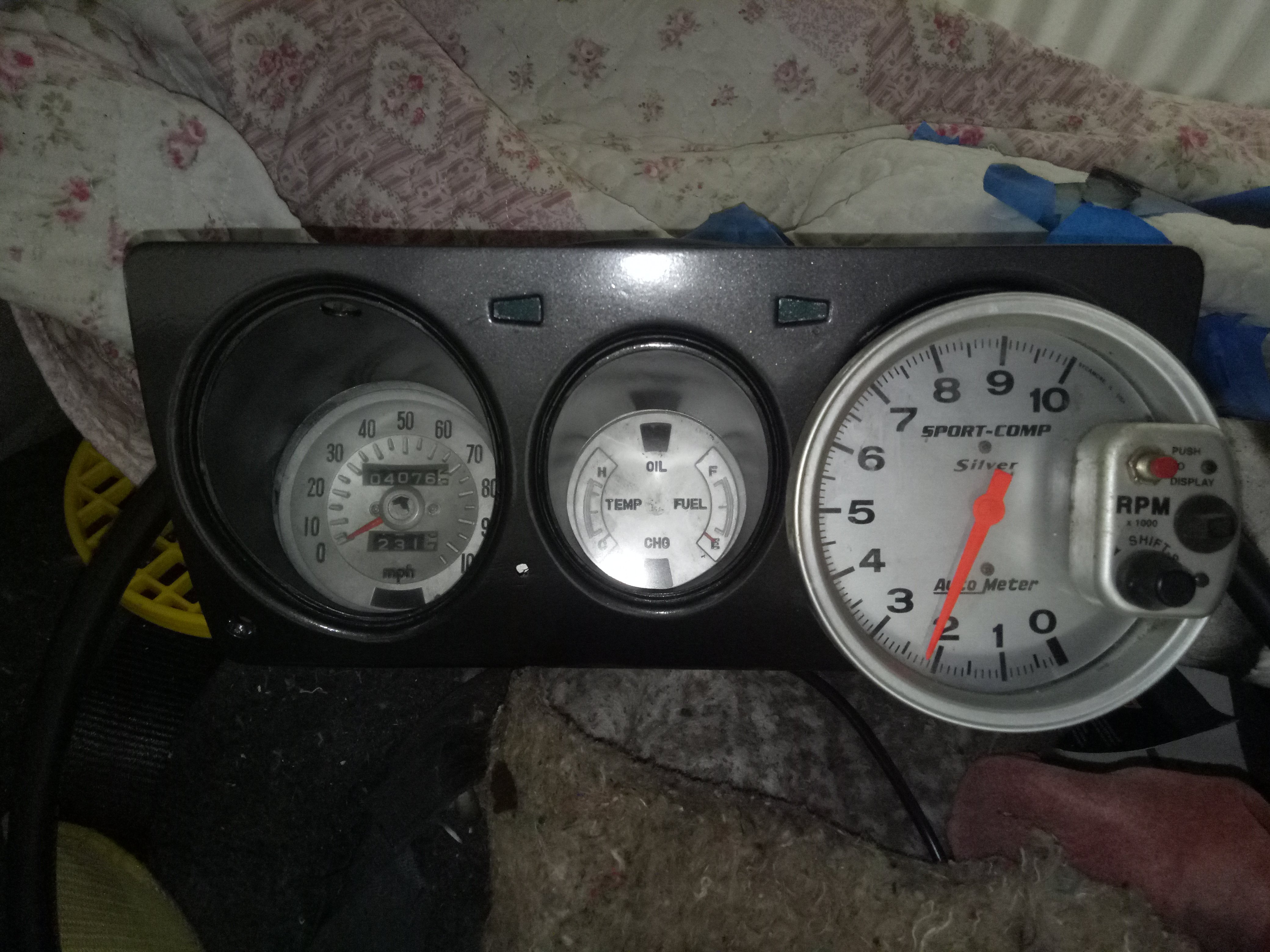

I put a autometer ring around eboost 2 so. It looked more like the wiper/starter etc rings. Fitted pushbutton to change microtech dash pages and start drag timer etc
