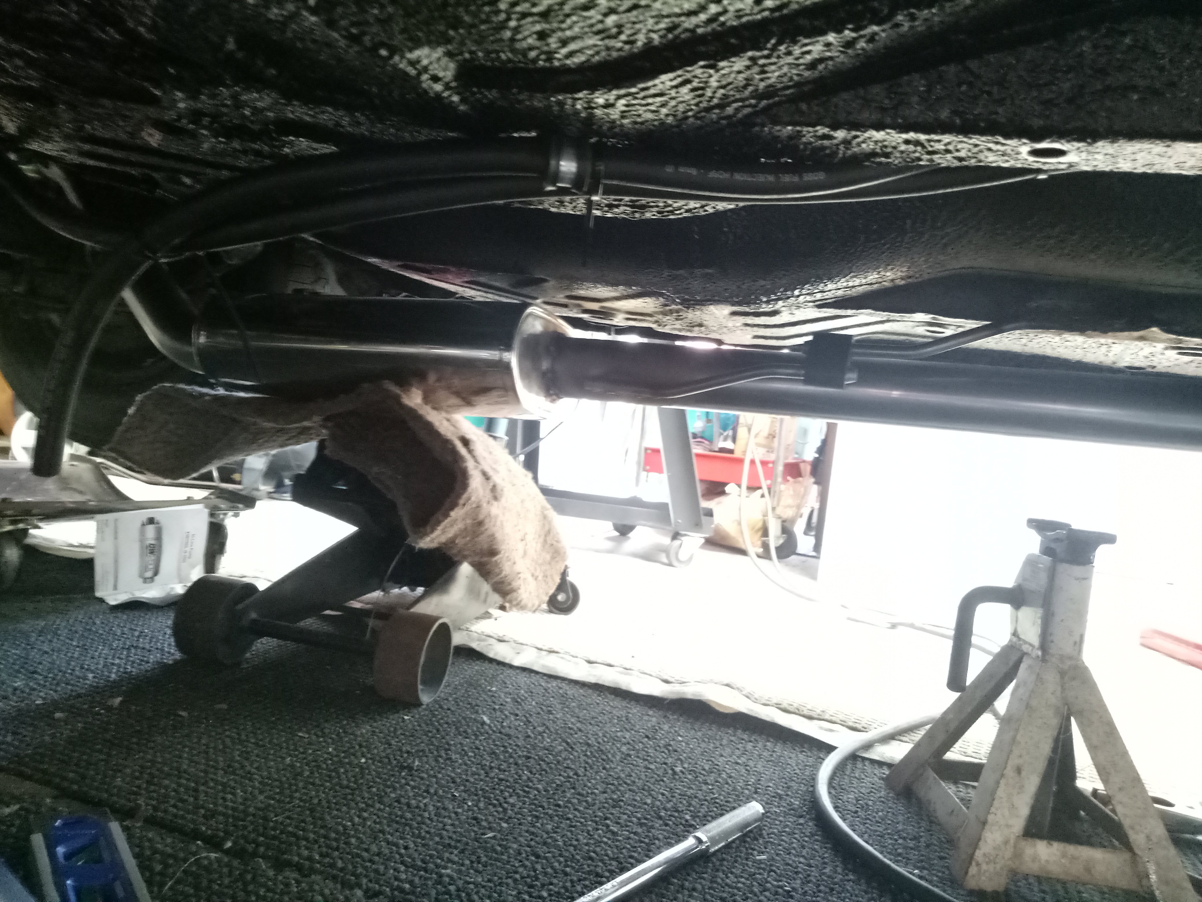

Made a 2.5 inch mandrel exhaust
It was biggest i could get through crossmember and rackIMG20190417211459.thumb.jpg.bfa09b4a9b157f4058119935e48035b3.jpg
