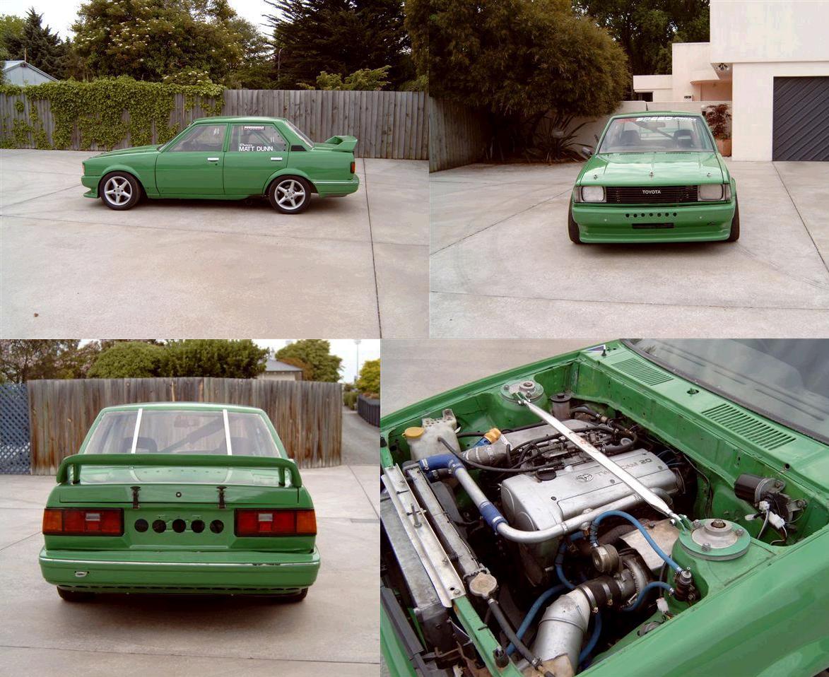

Now.. who's beast is that? (I see the name on the car but is he a local? Or off Toymods?)

hahah some bloke in NZ.
Its like an EF ? falcon front bumper and Ae92 rear bumper. Or is it the other way around? i can't remember at all hey :(
Yeah, remove the speed holes and some of the other crap, and its one of my favourites :D
Just got home from work and having a good solid look at that green machine. Just to elaborate on what I've posted so far and to compare what I will do with mine I'll run over a few things for you guys...
Top Left Pic - Mine will have custom sideskirts which I will make once I've done the spoiler and the alloys in that pic don't suit in my opinion. Not entirely sure what wheels I will go on mine yet, may utilise the corona rims I currently have on the car and just get the later 80's model Tarago centrecaps which look a lot fuller. And that is what I mean by "wrap around" rear bar as I mentioned earlier, only difference is I will be following the 'recess' in the quarter panel all the way around to the wheel arch. So some welding to be done (but not till i re-shell obviously)
Top right pic - Having second thoughts about flat early upright front as I was going to go twin headlight on the early front. Still think I will go twin headlight but most probably on the later slant front like I have now with the headlights recessed as far back as possible (may even make one of the high beams removable for an air inlet for track use)
Bottom right pic - God damn
Bottom left pic - Sorry to end on a negative, but my wing will suit the lines of the car better and my bar will be dead straight. And are those holes??
