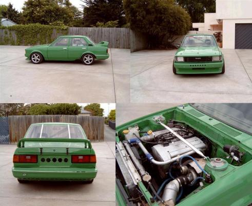

Yeah Biggo, shaping is the next step. Want to make sure the ends are right first. Researching wing profiles as we speak, to determine the shape I have to carve. Once it comes along a bit further and my ends are shaped correctly and attatched I will be "paper mache" coating it then using body filler for more shape.
So I've basically gotta turn the top pic into the bottom one:P
Further Photoshop jobs confirm I truely am insane :D :(
