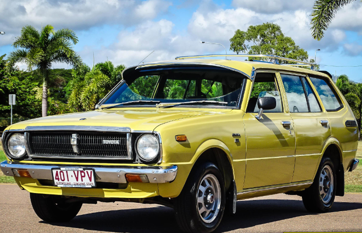

Does your KE38 look a bit like this one.  Think this one might be a 1978 model.

Also spot on, that looks exactly like mine! Except, looks wayyyyy better!
I think that KE38 sold for about $ 7.5K a year or so ago.  It wasn't original.  It had been resprayed etc. off memory.
