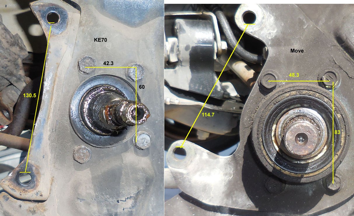

Here's the dimensions I measured off my 1983 slanty when I converted it to Diahatsu Move vented discs. They would be the $52 discs at 218mm. I wonder if the 229mm ones are on AE86s.  The longer life ones, 83-87, are on wagons & vans. They stopped making KE70/AE71 in 83.
