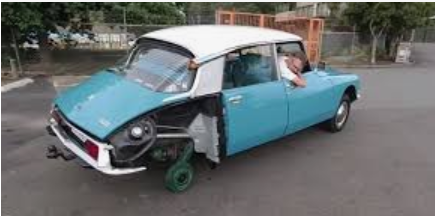

Ooooowh !   That will be fun, working with one of those fancy French autos.  Pictures please as it progresses, as being a half cage, I guess, the Renault Megane is not stripped or gutted ?
P.S.  French cars are the quirkiest & most unusual cars I have ever driven or worked on.  Learnt to drive decades ago, in a Citroen ID19 Godess, I think it was.
Only car I've ever come across, where you have to remove the back mudguard to change the wheel !
